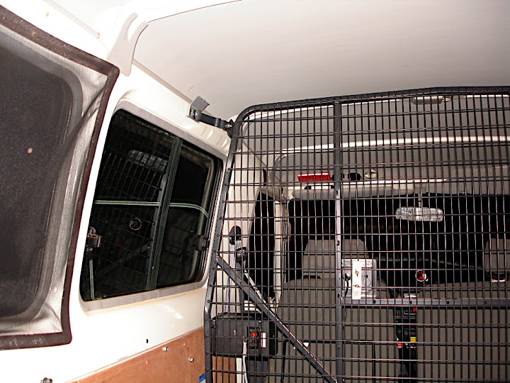

So, couple of evenings last week I tackled the cargo barrier. This was a bit of a heart in the mouth moment as it almost looked like I wasn't going to get it in unless the drawers were removed :mad: and that was going to be a PITA. However with a bit of grunt I got it in and turned around. Then there was a bit of a bonus! The very strong old seat mounts from the side benches (as used in drawer securing) looked like they would work for the bottom barrier mounts - and they did! Okay it means the barrier is say 2" further forward than planned, but that is better than faffing around with the floor and a 22mm hole saw!
The Milford barrier mounts consists of drilling a 22mm hole and two 9mm holes each side. A metal plate is then inserted through the 22mm hole and it is bolted through the two side holes. This leaves the large hole with the threaded plate behind - into which the barrier mounts are screwed. As you can imagine there is a fair bit of fiddling, swearing etc.
However the barrier once in is solid, rattle free and looks like it does what it should. Also provides a convenient place to mount my rear speakers and the battery monitor. A super cheap inside/outside thermometer will also go up with the bat monitor for seeing what the fridge is doing. Eventually I will also use some thin carpet type stuff to make a drop down barrier that I will be able to unroll down the cargo barrier. This will effectively divide the vehicle and reduce the workload for the air-con, as well as a bit more sound damping.
Strangely when I see these pics it looks like the barrier is in front of the side window - which it is not, anyway...

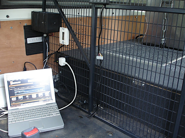

Then time for more wiring. I put my viair compressor on the side of the drawers, and the 12v outlet is for the tent light as well as the charger for a maglight (with LED conversion - a much better torch now):
The cargo barrier is proving really useful for mounting things - so I mounted the indoor/outdoor thermometer so we know what is going on in the fridge. I then mounted a 2nd 12v outlet which is primarily for a small inverter for charging laptop and camera etc. Tested it out with my mac - managed to get wifi signal from the house and browse MUD in the troopy!
I then re-routed wiring for the amp so that basically everything now runs from the aux batteries. Then testing time...
- Fridge compressor running
- LED table light on
- Compressor inflating a tyre
- stereo on loud
- laptop charging from inverter
Total of 16.3 amps. Going to have to put in a larger circuit breaker (only a 10 amp rated one at the moment) as it would trip after a while. Shutting down fridge, inverter, stereo and lights let it run a bit longer but still tripping.

- The cargo barrier was only difficult because I fitted the drawers first - so getting it in and over the drawers needed brute force.

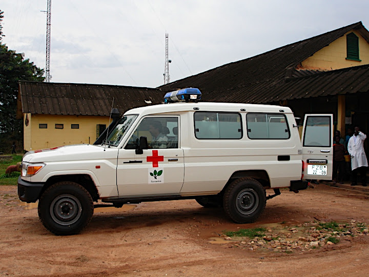

Now last week a long awaited vehicle arrived (I ordered in October) for our company hospital which is also a district hospital. It is a fully ambulance equipped new 78! Must say we had some laughs driving around as the siren has a loudhailer function. Anyway this one (got to get some pictures) has rear mudflaps, (which mine doesn't) so I made a deal with our Doc... a couple of ratchet straps (to lock down the oxygen cylinder) in exchange for the rear flaps :cool: They even say "LandCruiser" on 'em.

Ambulance!
So, it seems there is some interest in the HZJ78 Ambulance! Well this morning we handed it over to the hospital and did some basic training of how to deal with the stretcher and so on!
So here goes... Troopy arriving at the hospital:
Our Hospital Lab tech sitting inside:
Some stretcher practice:
Cloth interior - most that we see tend to be vinyl:
And finally our BRILLIANT and highly talented Dr. with myself - we are all quite pleased with ourselves as formerly we had a 15 year old Nissan Urvan that cannot leave the area... we try to manage with various LCs in emergency, but finally after we lost a young girl I insisted to our Board of Directors that we need a decent vehicle... and as the choice is mine, well you know what it was gonna be ;)
Our little hospital is very basic, but we do have x-ray and a lab with decent analysis equipment but some of the cases are frightening... most fatalities are untreated malaria (mostly kids). Scores of water related illness and so so many preventable cases. Charles (the MD) is a highly talented Ob Gyn guy and the only way we retain him (so many job offers in US and EU!) is that he relishes the challenge and we let him do a lot of extra courses and studies oveseas. I have seen him save a young girl (accidental ingestion of insecticide) by jumping in his car (nice Prado BTW) and gunning down to the town, buying a handfull of charcoal and forcing her to eat... result! I have also had my share of stuff out here when I have been glad to have an MD I know and trust implicitly.
I KNOW this troopy will be saving lives in the near future!
The mods are as follows:
- collapsable stretcher with locking mechanism in the vehicle
- Stainless steel ramp
- 4 overhead fluoro lamps
- Oxygen set
- Siren and light set (Damn loud)
- heavy duty flooring in the rear
- Privacy glass on rear windows
- Typical stickers
We still have to put in a good first aid kit, put on some better/wider tyres and maybe an HF radio.
