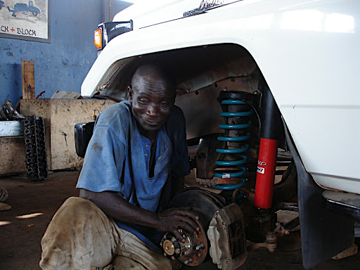

Well today things went a LOT faster. I asked a couple of our mechanics (Vincent and Simon) if they wanted to help out so we got cracking in the workshop. These guys are doing leaf springs every day, but I was surprised at their speed... Believe me they don't work like this when it is company stuff! We met at 2pm.
First we basically stuffed a 2 post lift (it is pretty much on the way out, but we didn't help) bolts are coming out of the floor! But we managed to get it high enough to pack it safely and get full droop and more...
The front springs and shocks were done within the hour:
Vincent was pretty pleased with getting pictures taken of his work - first time! It's not often a camera is seen in the workshop
