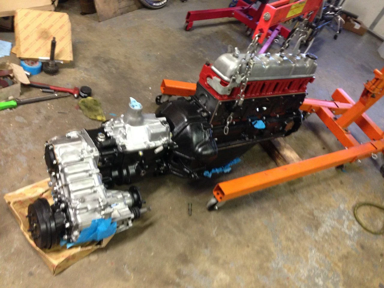

If RHD, it increases the odds of an H55F, simply because RHD markets had more 5 speed late J4X variations that they were installed in.
Easiest indicator would be to look at the back of the transmission. H55 has a housing extension.
See the chunk between the transmission and transfer case in the first pic?
H55/BF1A
4 speed
Granted, I don't know how the bolt on ODs mated or looked, but surely someone can provide a means to ID.
H55/BF1A
4 speed

Are there any h55 without that rear drum on them.
Mine doesnt have that.
Other than that it looks the same.

Thanks mate
Yes, if the axle has ebrake provisions, then the split case did not.
Think, being operative, most of the early Cruisers with split cases that had axle e brake were full float, although some markets may have had semi.
In the U.S., we had neither H55s, nor full floats, but most common conversions include swapping semi float (with no ebrake) for full floats that had, when swapping from 4 to 5 speeds.
The split case e brake is a proverbial pink unicorn configuration, since rare to begin with and difficult to source, but full float is mo' betta and a more elegant way to deal with, stated retrospectively.

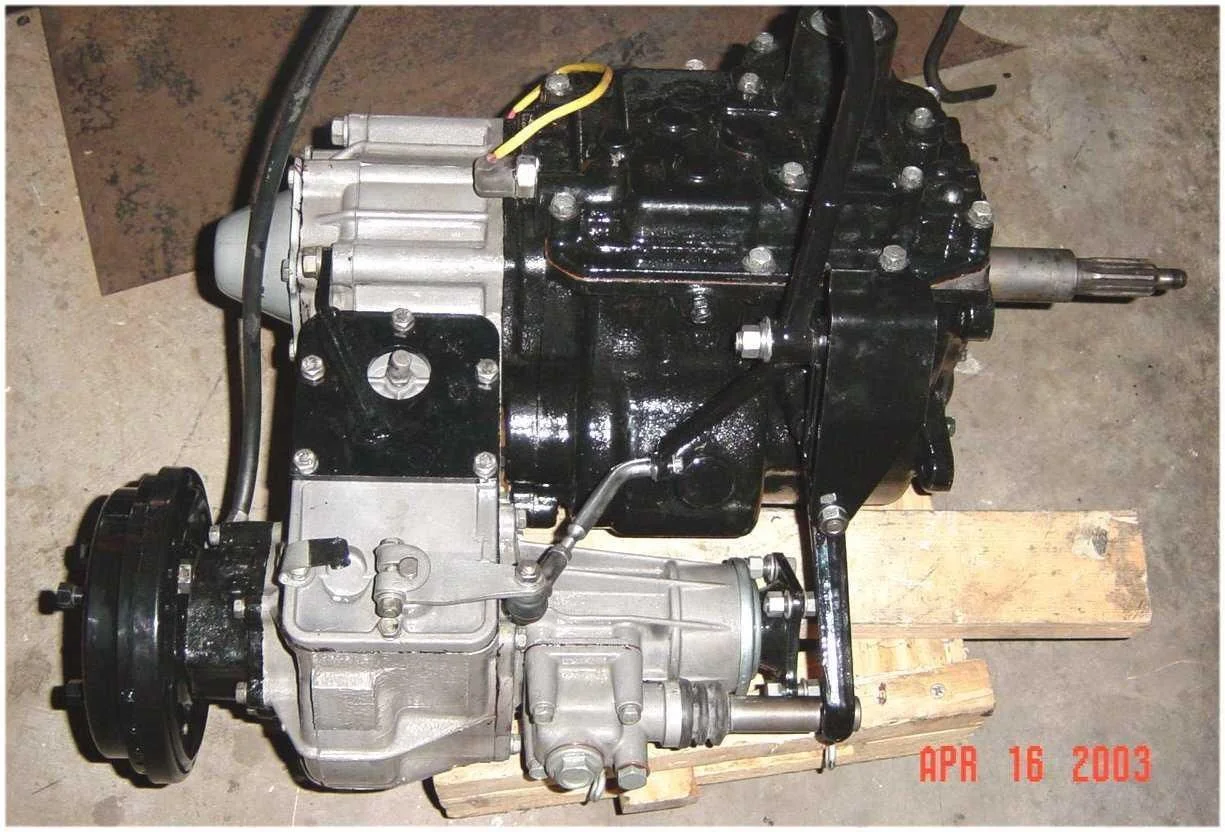

That first picture of the five speed most likely had the hand brake added. The shifter is in the location for either the 60 series or 70 series. All those had a hand brake on the axle whether full floater or semi. US only got semi floater, even those 8/80+ with the hand brake including the 40 series. Wasn't until 80 series we saw a rear full floater in a Land Cruiser. The second picture shows the correct location for shifter on the 40/55 series.
