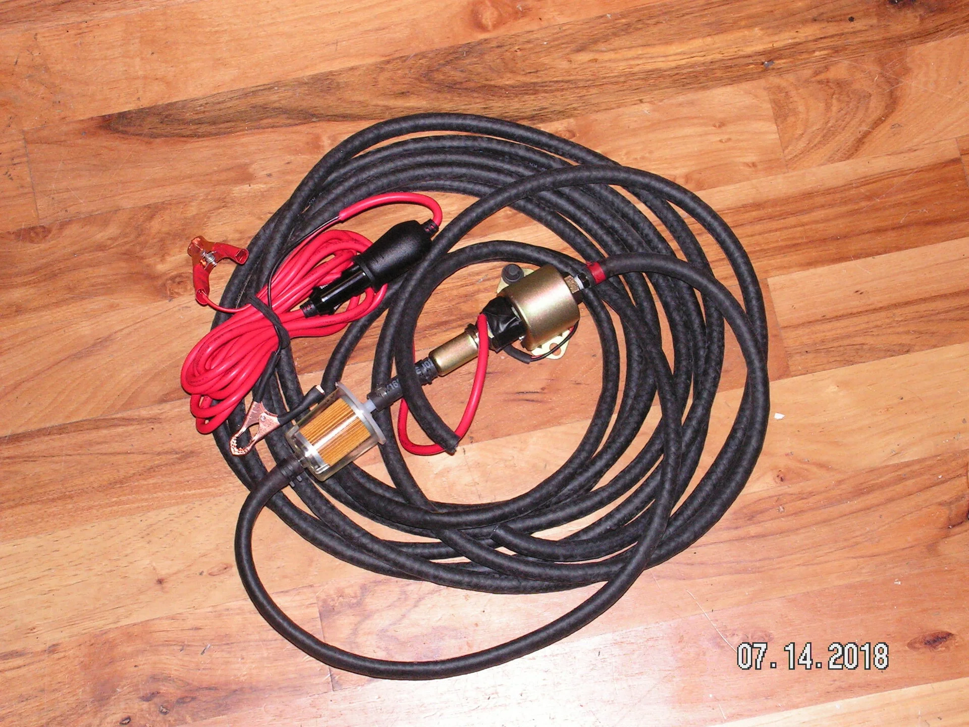

I made up several fuel transfer pumps for friends and family using the cheap pumps. We all love them for ease of use and not having to hold up the crappy venting 5 gallon cans. It is fused, filtered and switched has a 20' discharge and 5' draft. 10' power cord that will plug in the cig lighter or clamp to the battery.
