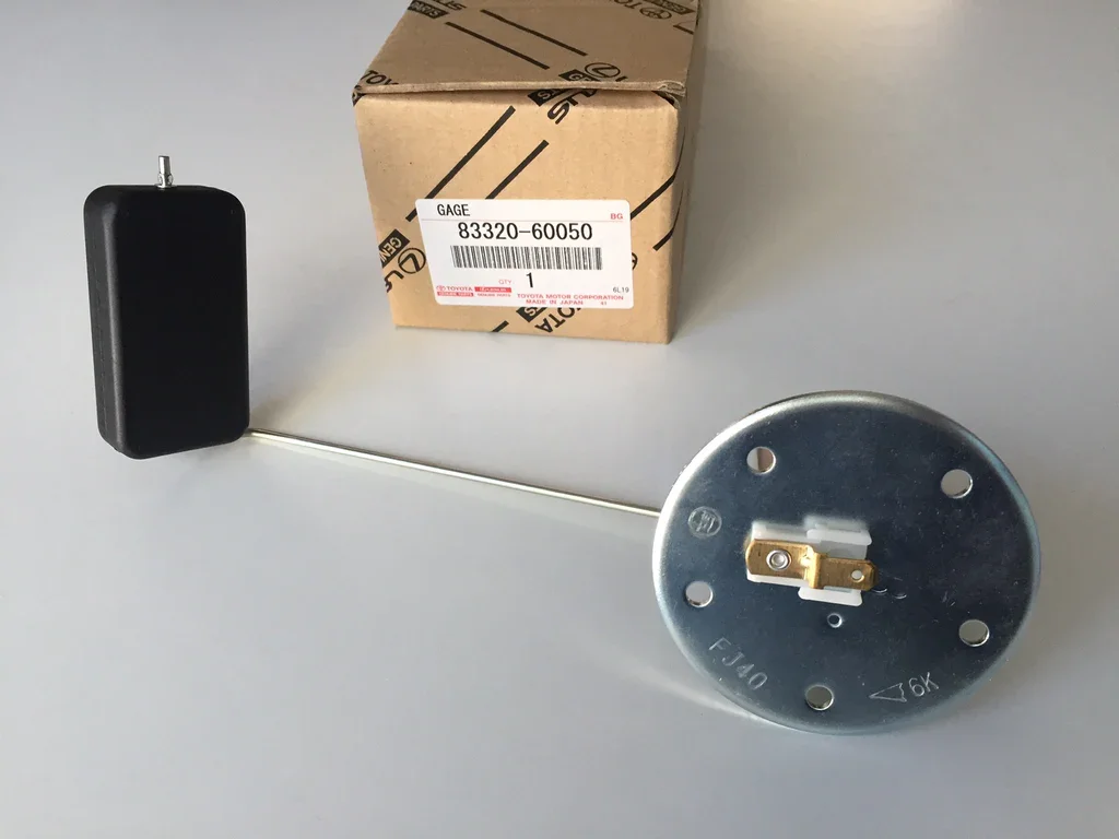

add a dedicated polarized ground wire to 1 of your top Philips head screws sender
- u have a OLD sender
, BAD
buy this one

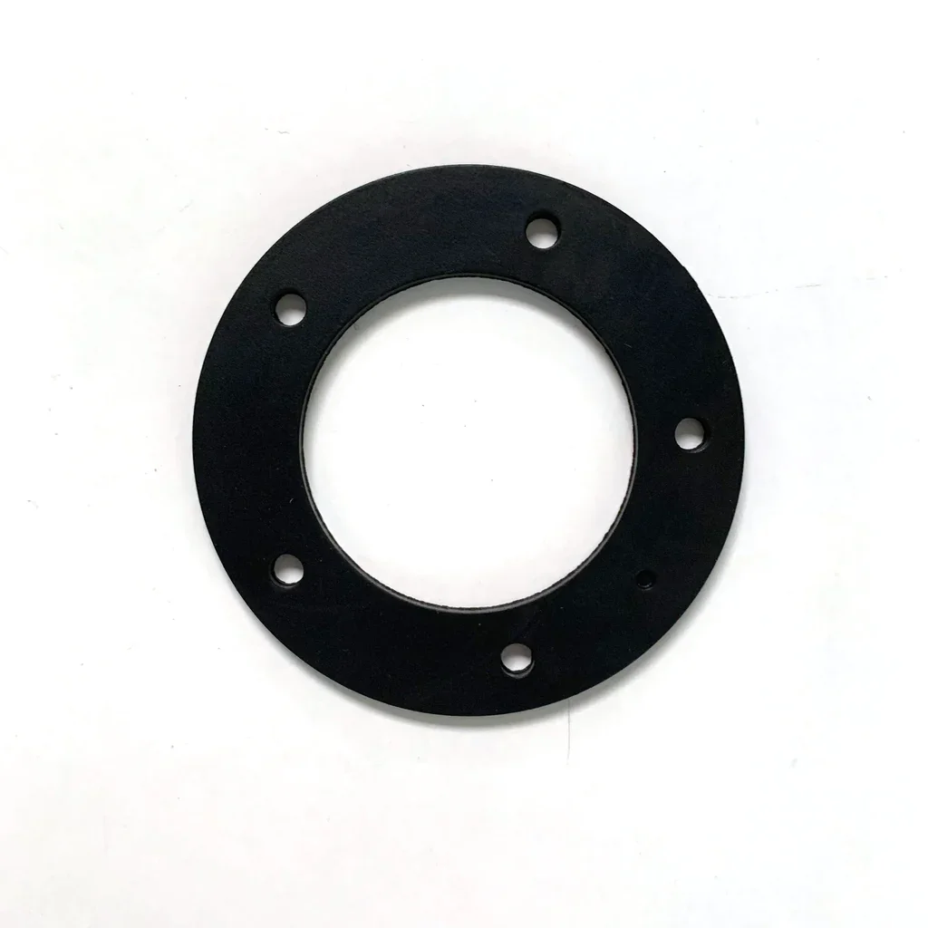

new oem gasket

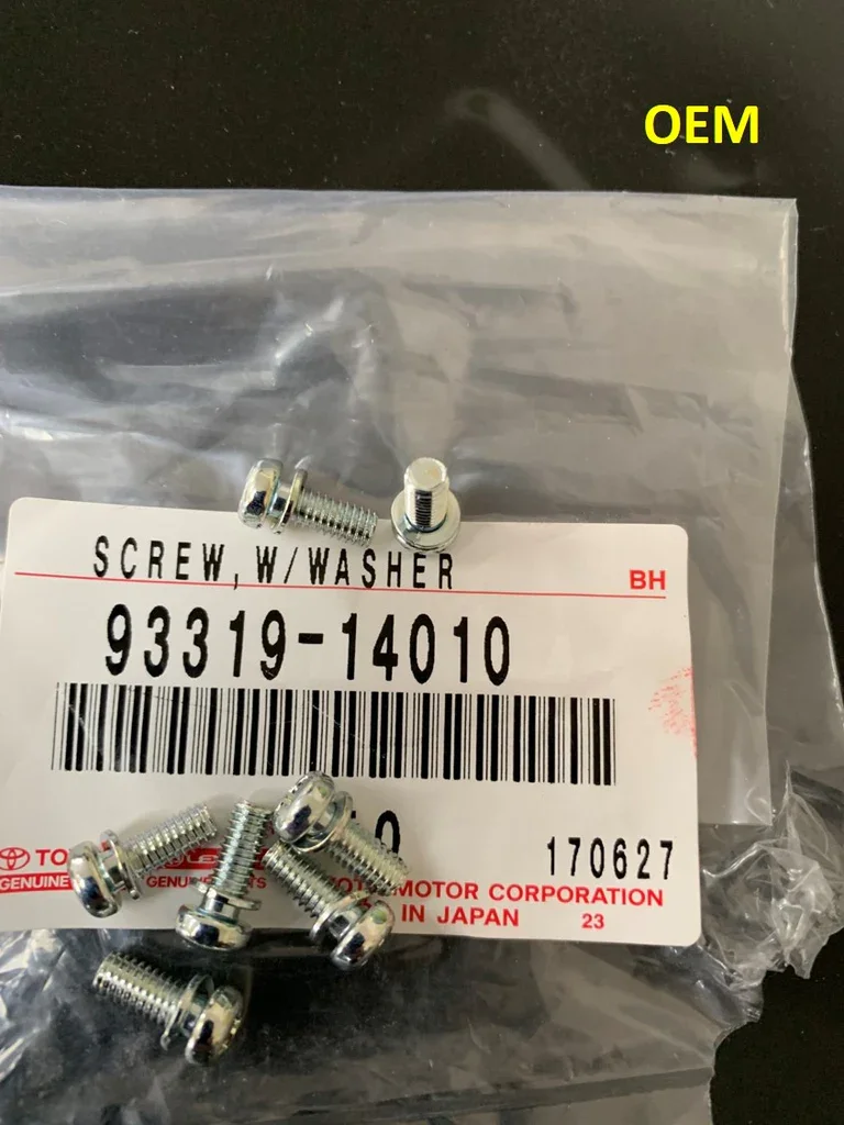

ALL NEW OEM screws

- adding the ring terminal ground to a new OEM sender is your path
