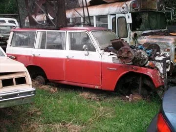

OK, OK, OK, I went and took some pics finally. I will post as many as Mud will let me PICT0003.webp
PICT0005.webp.
Alas, the VIN is FJ55-94605. I assume that means not originally a diesel. Can anyone/everyone confirm this?
As you can hopefully see, the front end/frame damage is considerable. Perfect candidate for the 80 frame swap to me. If I buy it, and decide not to rebuild this poor piggy, there seems to be some good pieces.

Not only is the frame bent down and towards the pass side, but it also appears that whoever took the eng/trans used a fire wrench to remove the motor mounts, so there is nice big ragged rectangular holes on both frame rails. In my opinion, it would need a replacement frame, be it 55, or tube, or 80 etc. Probably a big reason its been there so long.
From the front clip back, it's really in pretty good shape. With no offense meant, a lot better than others I see here on Mud that you guys have saved. Even the headliner is in pretty good shape.

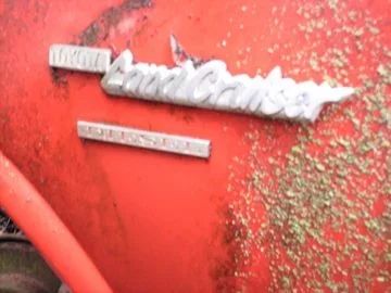

The "diesel" badges on the vehicle are Toyota badges. The look just like the badges on the 4 cyl 70's diesel pickups.

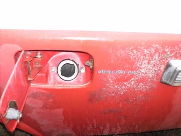

The label that states "Diesel fuel only" is the exact same "font" that other things on the vehicle are written in.
The filler neck does not look modified in any way. It looks totally factory and there are no welds or brazes to suggest it was modified.
