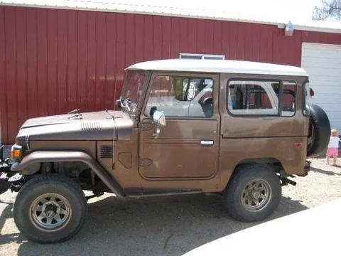

I have wanted an fj40 for as long as I can remember and was finally in a position to purchase one a couple months ago.
I got a 77 the was originally mustard yellow but the PO repainted brown. I have started the process of a complete tear down for a frame up restore. I think I have only broke about 6 bolts so far.
Having a heck of a time getting the tub off the two bolts by the tail lights are near impossible to access and I think one of the heads is rounded now :mad:. Any tips on that, probably have to grind it down and take off the tub.

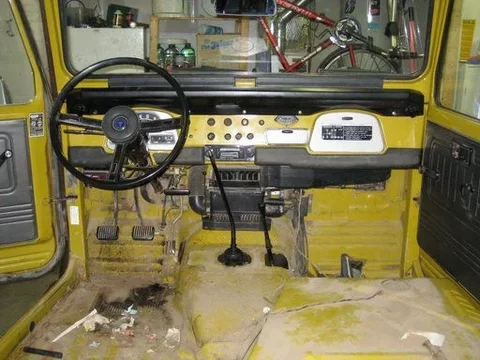

Congrats !!! Welcome and have fun. Wal Mart Black & Decker angle grinder will become your friend for bolts like that. I got to the point where I could probably do dental work with mine.
Whats that sticker on the drivers door ???
Whats that sticker on the drivers door ???[/QUOTE]
Looks like the Warn hub instructions....mine's on the dash next to the light knob.
Good luck, lots of hours and $$$$!! I know it will be awhile but are you going to go back to mustard yellow?

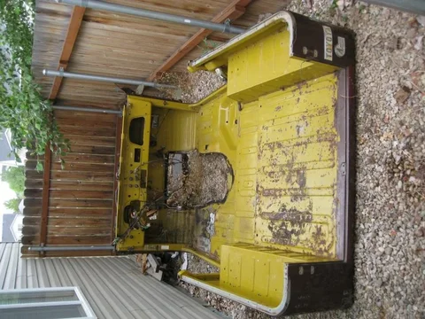

The tub is off!
Ok I have finally had some time to work on the cruiser again. After wasting time on trying to get the last 3 bolts for the tub off I rented a saws all for $7 and cut them off in about 30 minutes since I had to remove the two rear tires to get to them.
I recruited two of my neighbours to help me lift the tub off the frame and place it out back for the time being. They did not know what they where getting into so my wife is baking them two pies tomorrow for the help.
Picasa Web Albums - Jacob - tear down
So now to pull the engine, transmission, and transfer case clean them up, clean up the frame and start the process in reverse order.
I am thinking of painting it Dune Beige, that is the colour I have always liked although I am not opposed to the Mustard Yellow I do like that colour two so a little bit on the fence right now.
As for the sticker on the drivers side window, it was something about the wool growers association. It has been removed.
