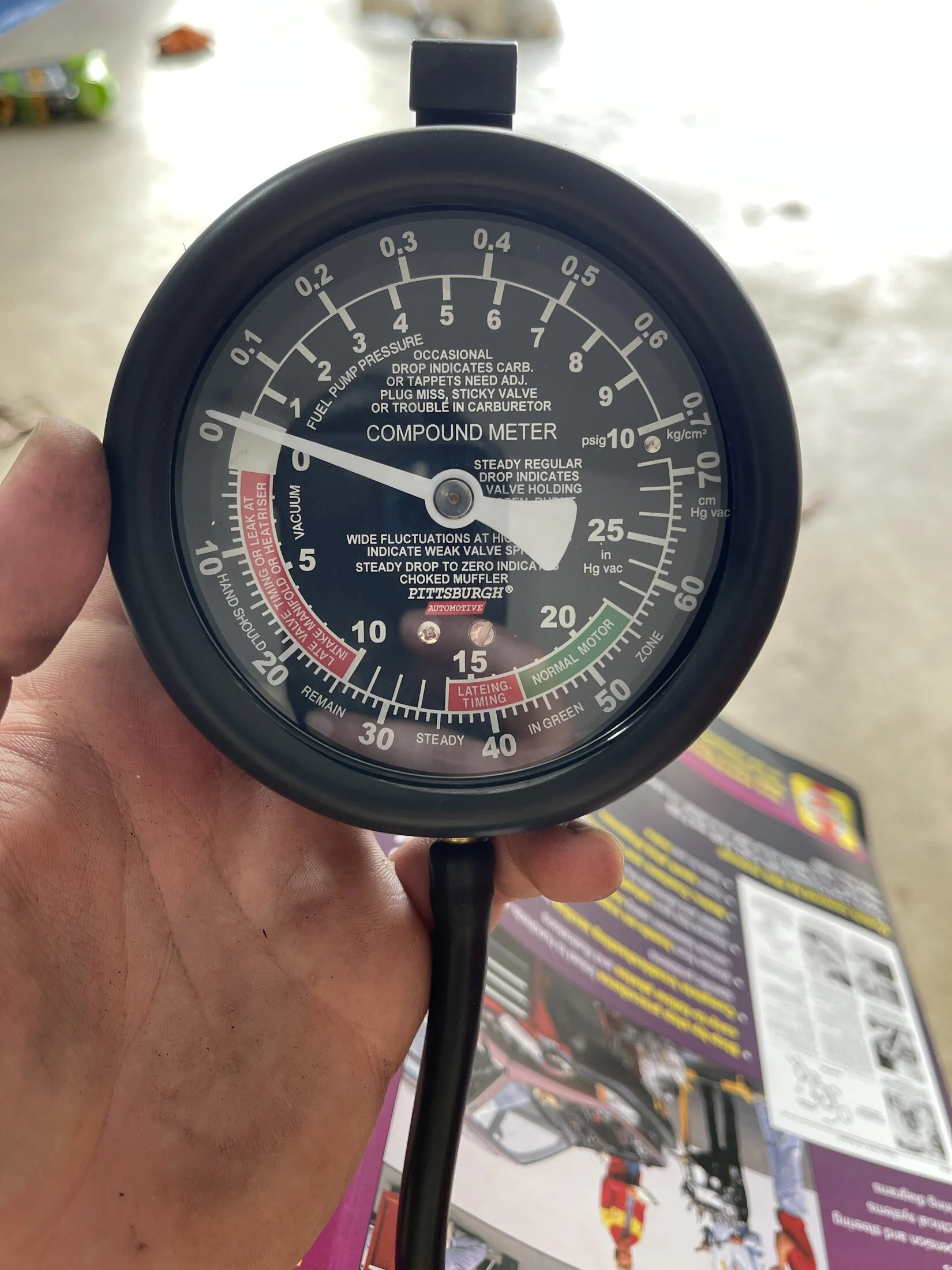

Trying to get the motor to stop backfiring. When it started we decided to rebuild the carb. Just rebuilt the carb, and still backfiring. Reset all the points on the distributor and found a wire that was going to the distributor terminal was broken. We fixed the wire, and I also bought a vacuum gauge and it is reading ~30. All emissions are still in place. It is backfiring at idle every so often but not through the carb, it is backfiring at the exhaust. It previously was backfiring through the carb prior to the carb rebuild. Any advice?
It is running rich or intermittent bad spark. What are the units on the vac gauge 30 what?
This is the gauge I’m using. CmHg

30 is cm hg vacuum and you want the other side of that which corresponds to ~12 which is pretty low

Typically reading the gauge you read the inside circumference #'s. So you say 30, but that would correlate to 12 on the inside #'s. Running properly the needle should be in the green. The higher the better. You say the idle mixture screws aren't working and the carb was rebuilt. As @SteveH said, fuel is probably leaking, bypassing the idle mixture screws. 1st make sure the throttle plates are closing. Sometimes carbon or a gasket can interfere with them completely closing. Then set timing to spec. I suspect throttle plates and vacuum leaks. Settings need to be baselined to spec.
