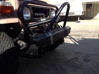

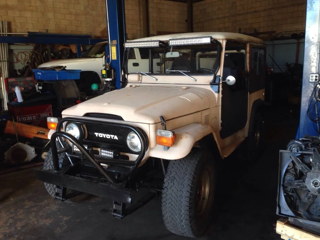

i spent a great deal of time working with fj40s and cummins. Ive got a 4bt in mine with a th400 automatic trans and i had a nv4500hd 5speed manual before. believe me when i say a 4bt is plenty for a fj40. I dont have much in modifications to mine other than a different turbo and mine is plenty powerful.
The only reason to use a 6bt over a v8 is for cheaper torque. But honestly if you need a 6bt to tow somethings then your towing too much to be safe in a fj40. If you want to build it to be cool and wicked, then by all means turn the fuel up and burn the coal!!!!
So you have 4bt-th400.....?
I'm doing my swap this week and really would like your fuel mileage input.
my set up is, 4bt-th400-3spd xfer 4.10 thirds-and 33"tires. Might go up to 36 if the power is right.?
I don't think he's put enough miles on that th400 setup yet to have to fill it up, lol
