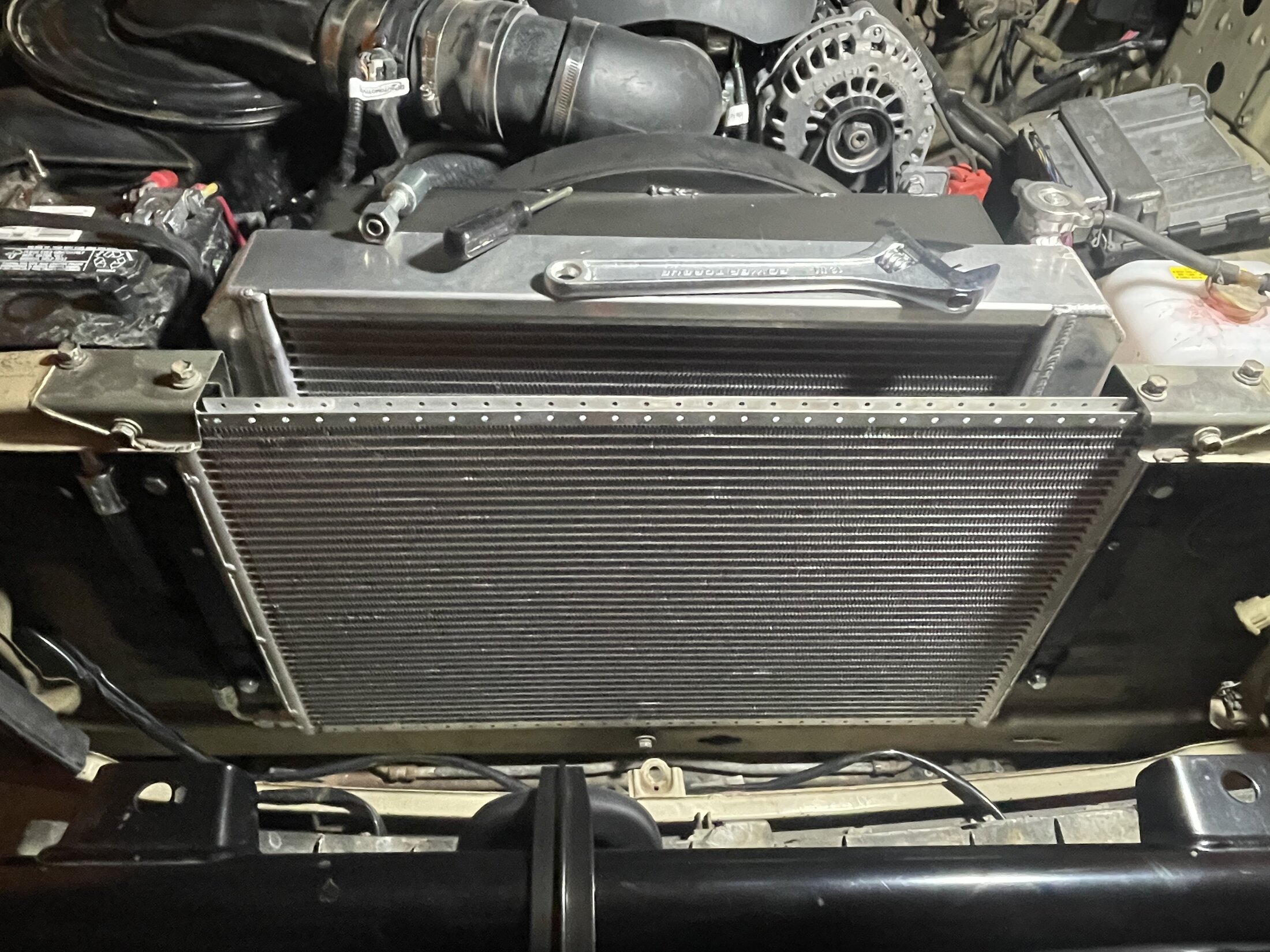

I’m running a universal 16 x 26 condenser from Cold Hose. Made some brackets out of the original condenser mounts like @BurntToast did.
It’s a tight fit but it’s worked well for me. You’re going to have to make custom lines but that’s really easy.

Soon. Mounting brackets are done. Working on prevent hard lines to stick out under battery tray so we can standardize our hose kits a bit easier
