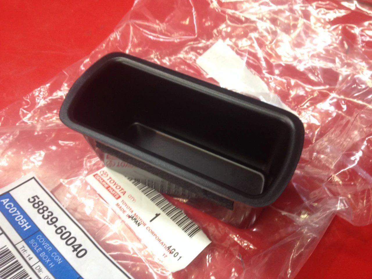

And the pocket for that empty space:
But @BenCC's stuff will be way more interesting. Use one of his panels for a switch/switches, and replace the cigarette lighter with one of the USB things from Amazon.
Like this (remove the bracket, and it replaces the socket entirely): Amazon product ASIN B00GPE9NZI
