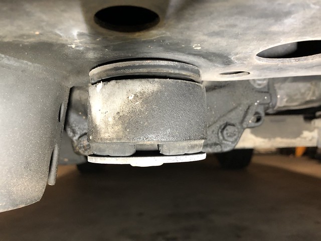

Had some more time to myself tonight so I got under that truck and took the skid plates off. This is what I found.
Rear most cushion looks to be in ok shape.
Untitled by Greg Fisicaro, on Flickr
Front cushion bottom looks ok but top cushion is completely gone.
Looking at the tensioner assembly for the timing belt, it looks like I am probably due for a full TB/WP service (rust?)..
And cleaned this up to try and figure out where the leak is coming from.. Nothing on top of the diff that I could see so thinking either its a side or just the gasket in general. Would the axle on that side possibly spray over to the diff like that? Both were wet with the diff being the worst.
The "clunk" is your driveshaft. There are threads on it, you need to grease the driveshaft and the knuckles. The driveshaft needs to be over-greased to dampen the clunk.
Not 100% driveshaft. Grabbing and testing they are tight, zero play in any way. But do plan to grease tonight. Clunk is definitely coming from the diff bushing up front and the CV axles/hub flanges.
My driveshaft looked okay when I inspected it as well. I did see your bushing was trashed so that is a problem. If the clunk continues after that replacement, then you should try the driveshaft lube.
