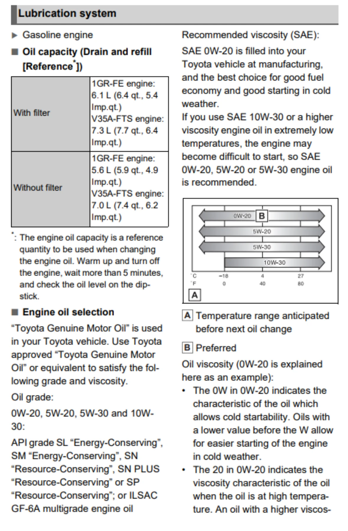

Since the owners manual in different countries recommends 5w-30 as a choice in climates like mine I will stick to that. 0W-30 may work in colder climates. Edit the video said the first number is the most important when considering a change.

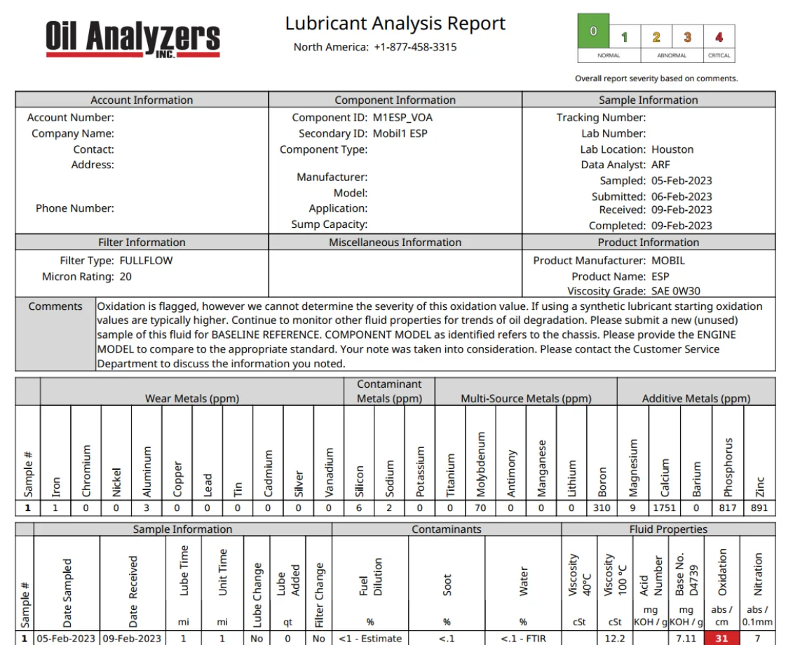

So I spent some time on ChatGPT messing with this and cross referencing it.
I can’t find an oil better oil than Mobile 1 0W-30 European Car Formula. It maxes out all the catalytic converter sensitive additives and has really good wear protection. If I do not change the downpipes and use the 0W-40 I will use this oil.
TBN is good for 5,000 mile oil changes. Calcium level good for Turbo longevity.

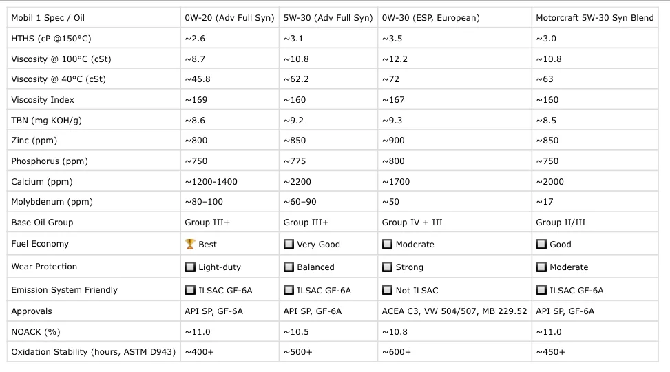

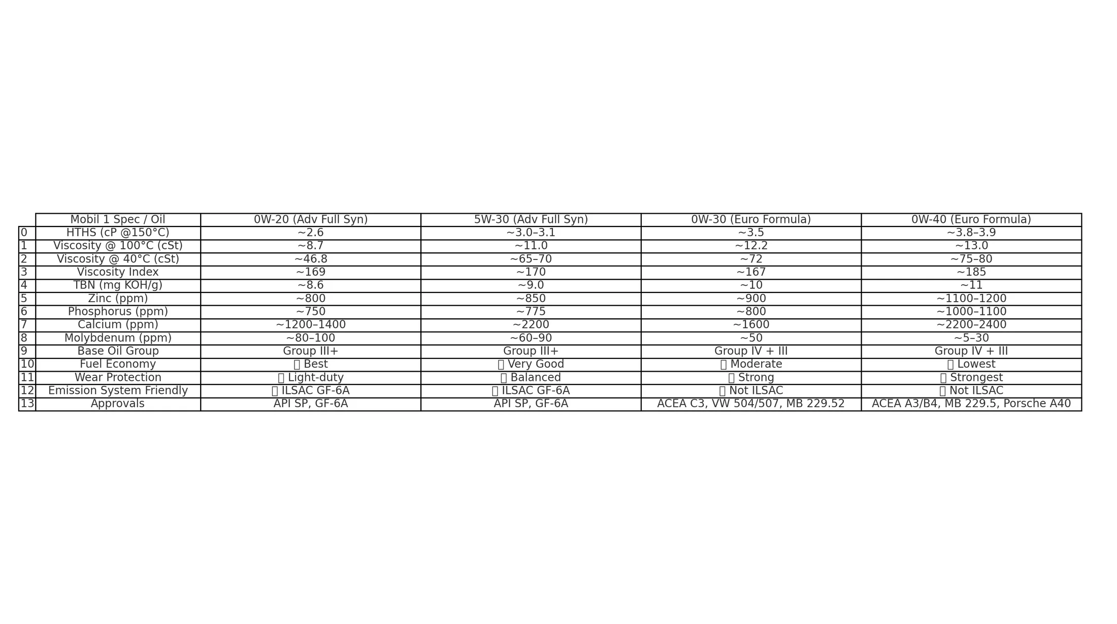

I would no doubt run that 0-30 ESP Euro if I was leaving it stock and 0w-40 if modified. It meets the GCC specs just fine. I am not concerned with minor mpg improvements.
Here is a chart and link to the approvals. I definitely wouldn’t have driven it off the lot shaking like it was if I had known this and went to that 0w-30 immediately. Forget the north or south climate that is the best oil.

Edit, Correct ESP 0W-30 (note there is 2 types) Mobile 1 Tech Link
I believe the only real difference is 5-20 has less polymers that maintain viscosity as temps rise. (Edit: may lead to longer drain intervals?)
0w-20 needs more because of the larger swing.
Its 20 weight.
But they do vary some, not all 20,30, or 40 is equal. Look at the 0w-30 Mobile 1 esp euro stuff as an example. It bridges 5w-30 gf6a and 5w-40 229.5.
