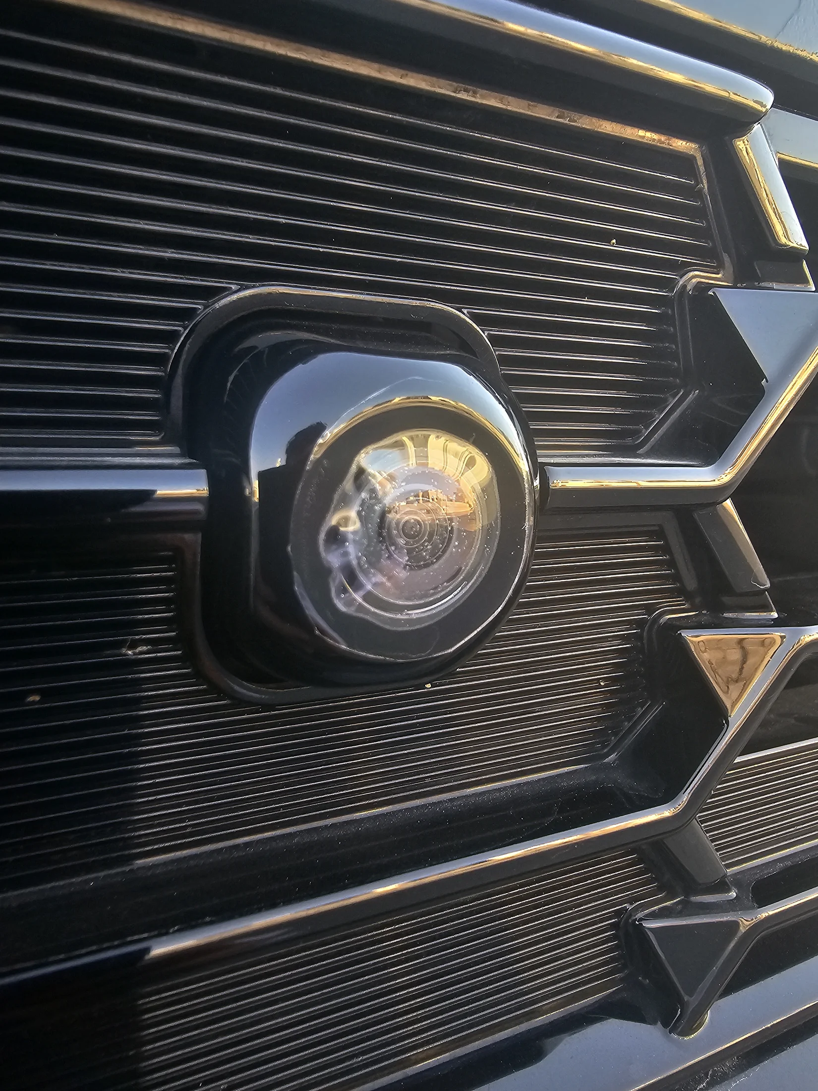

  • Front camera cover: weak and easily damaged. Mine got chipped just from normal use over 2 years. I PPF’d it, but too late.

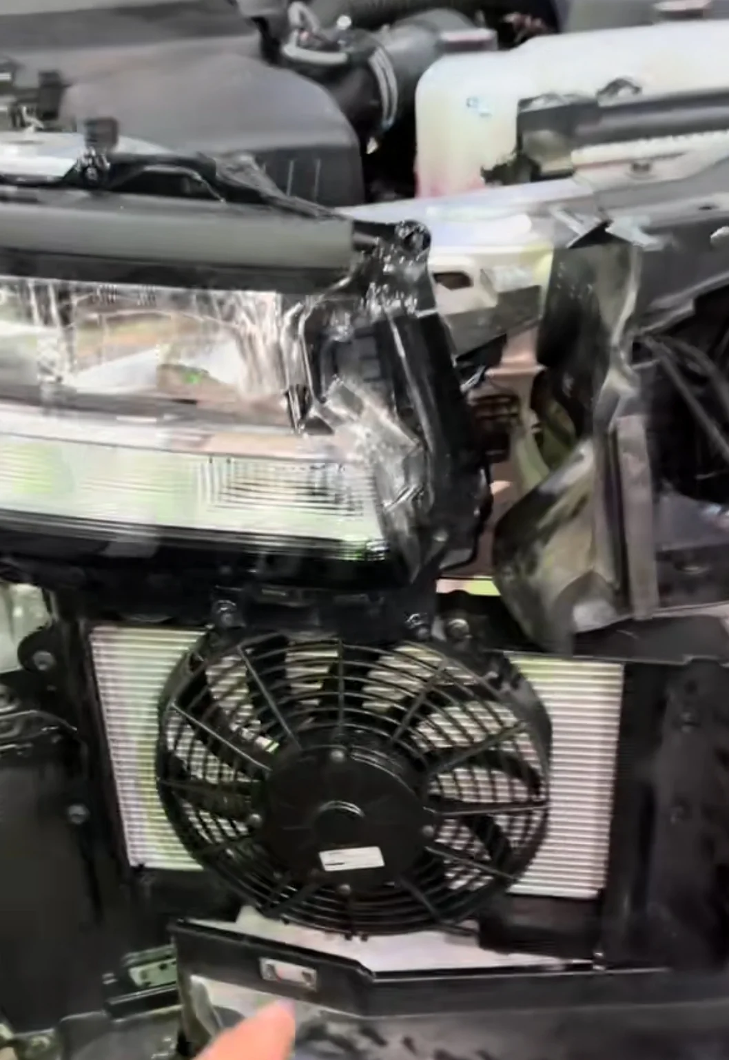

  • V35A-FTS fan clutch noise: excessive in hot weather even under light load. I support the idea of mechanical fans for off-road reliability, but Toyota should’ve tuned it better. Sounds like a turbine, kills performance, and feels unnecessary. Aftermarket fixes already exist, which says a lot. I think Toyota should have tuned it for selective markets where this is actually needed. Perhaps a modded thermostat design or even have an active fan on the intercoolers vs the current passive solution (perhaps cheaping out)
