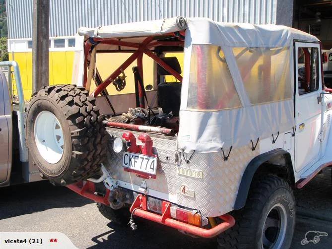

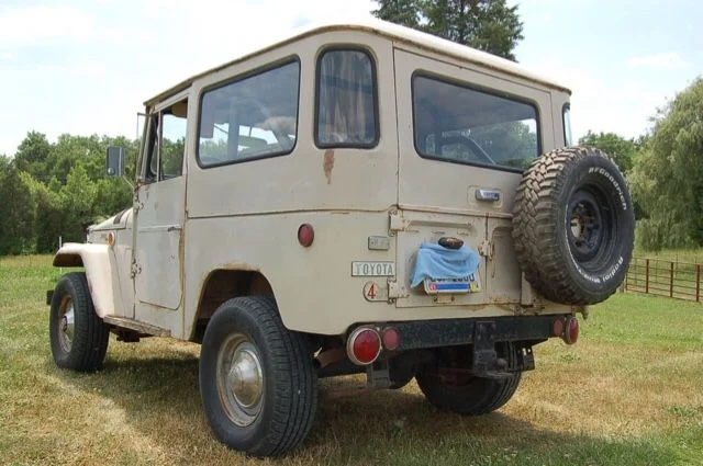

I searched 1969 FJ40 and here are some shots of emblem locations:

Hope that helps. Below the backup light is where I've seen them. There definitely should be some holes for these as they are bolted on (2 holes per emblem). It's possible they replaced the panels or put putty over them. Look from the back side - you would see putty pushing through.

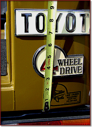

The Toyota emblem should also be fastened through holes which were originally there, similar to what upperblack posted for the 4 wheel drive emblem.

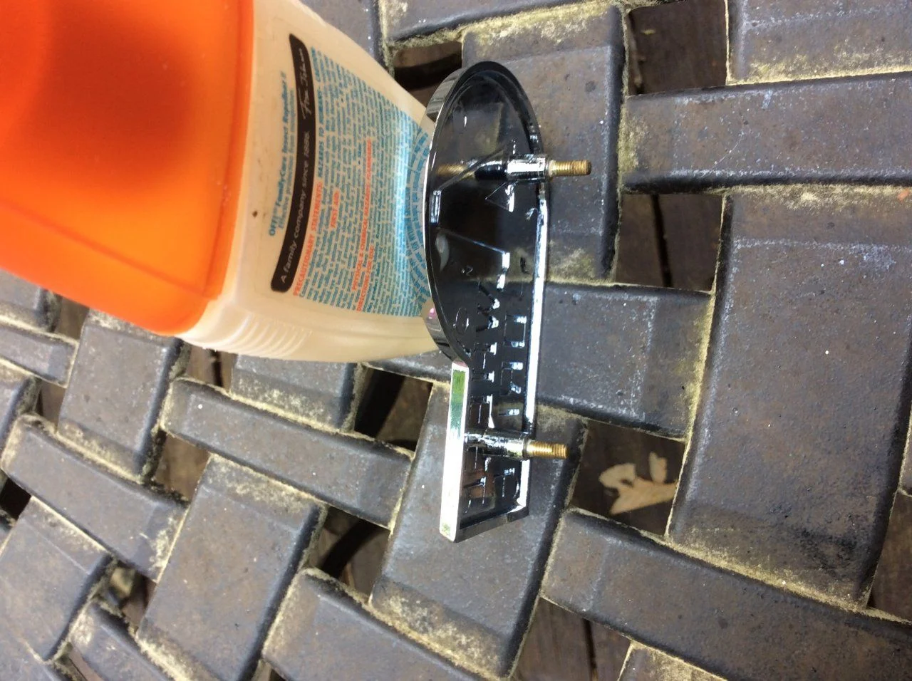

You also will need two "plateau" shaped (for lack of a better word) brackets to mount the emblem. If you notice, the mounting posts are only partially threaded and the nut will bottom out before the emblem is tight. See picture.
Definitely right on that one brian. I knew I could just put it there, just wasn't sure if it was not legit.

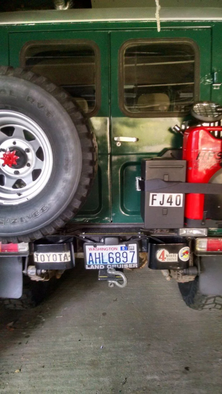

Guess that makes me the ultimate blasphemer! Years ago I added a spare tire carrier from a '68 onto my '76 to use as a jerry can holder. It blocked my OEM emblems so I removed them and stuck them on my bumperettes thinking I'd get less "nice jeep" comments that way. Didn't work though, apparently fools can't read. If I do happen to get rear ended, God forbid, replacing a couple of emblems will probably be the least of my worries. :cool:
