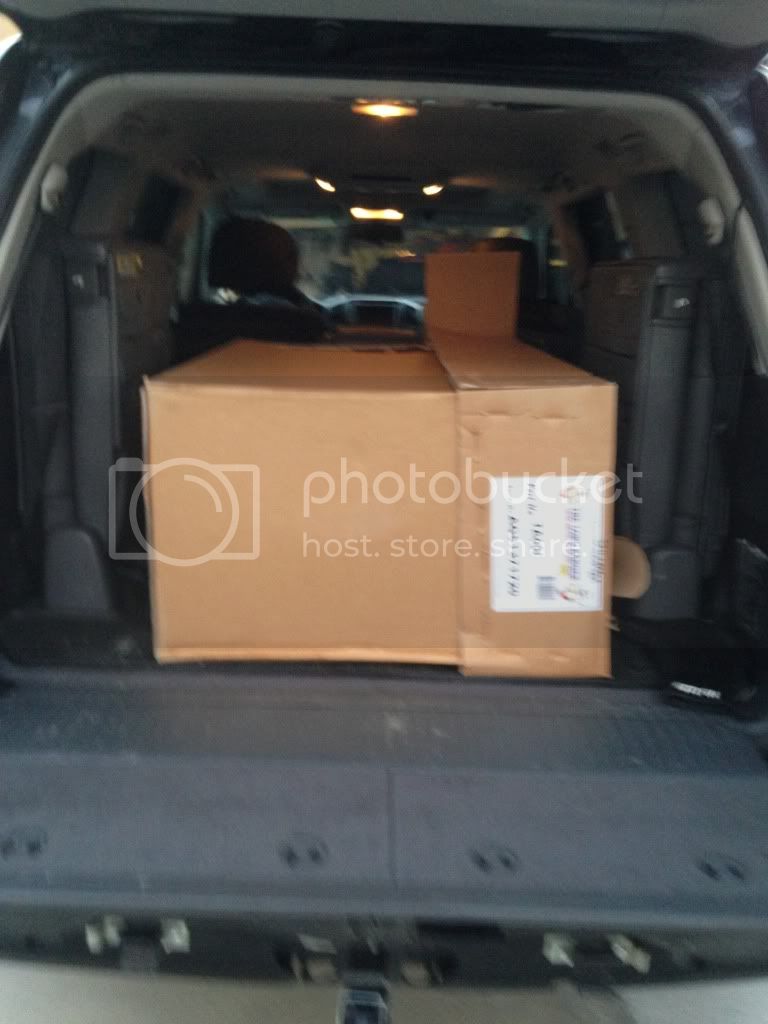

Called AUS...spoke to Dave over there at Long Ranger. Got everything all setup. They made the tank for me and sent me an invoice....I wired the money, and a week later it was on it's way to me!
Took UPS about 5 days to get it to me....came via freight. UPS freight is a PITA to deal with, but it got here:

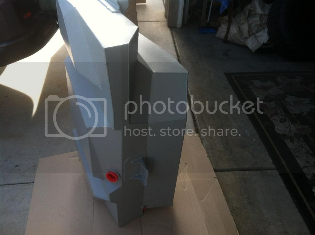

Once it was unpacked....it looked like this:

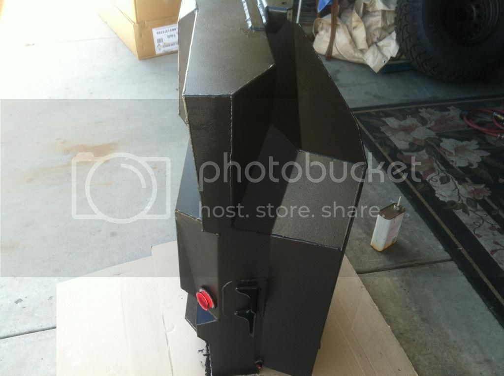

After we did a bed liner on it:
I wanted bed liner for various reasons. Wanted it black. Wanted an extra layer of protection.

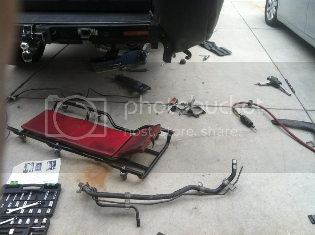

Next started the install. Here is the OEM filler pipe, pulled from my baby:

He went to test fit the tank....this is where we ran into issues.
The tubes and pipes that my guy rerouted, from the carbon canister, were not done far enough back, to avoid being crushed by the tank.
So he had to re-re-route the hoses farther back. This took time....
Had to mess with a bunch of other wires (trailer hitch) and hoses...... This took time....

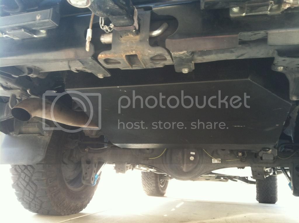

Here is a pic of it mounted temporarily on....it will end up looking alot like this when done.

It seems to be 5-6 inches from the rear hitch steel frame....and that rear hitch steel frame is behind the Kaymar Steel bumper... then you have the 2-3 inch steel swing arms....so basically , 2 arms, 3 layers of bumper steel and 5-6 inches of blank space...
So yeah I feel comfortable.
If it gets through all that....hitting the tank is the least of my worries. :crybaby:
