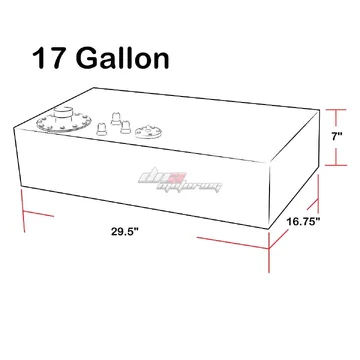

For someone with a swing out, something like this generic 17 gallon tank could easily fit the spare location - link
Sure, it wouldn't maximize the space, but 17 gallons goes a huge way towards extended travels without the killer weight.
I personally would love just a 5-8 gallon aux tank (for 400 mile range), and I think one in the right dimensions could be made to fit above the spare tire, even with the evap staying there.

For someone with a swing out, something like this 17 gallon tank could easily fit the spare location - link
