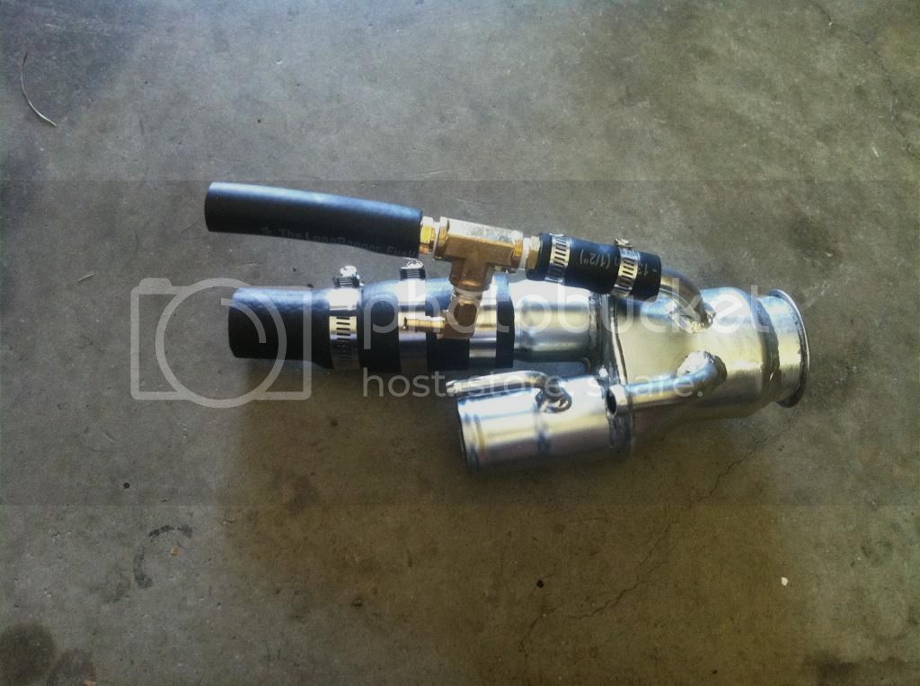

Here is the dual filler half way put together...

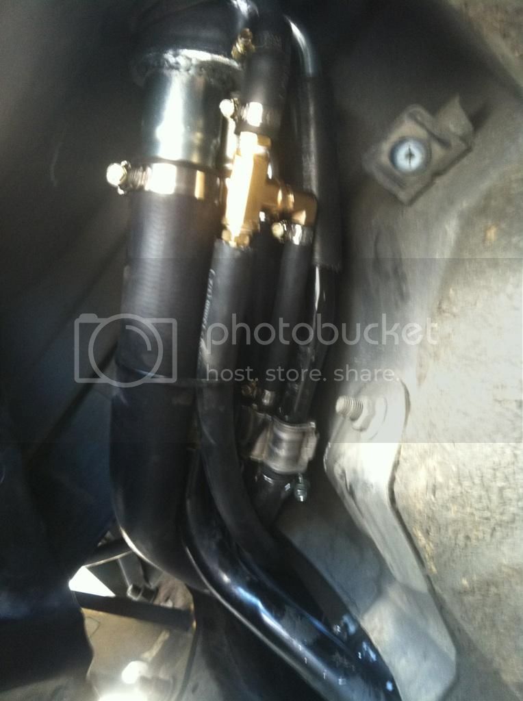

And completed and installed....
With 5-6 hoses coming off there...it tight and looks like a mess....but best we could do....

Ok all done...I just got home from a family trip so I let him keep it and work on it at his own pace. Works great. There are so quirks in the install and in the application, but overall, awesome.
