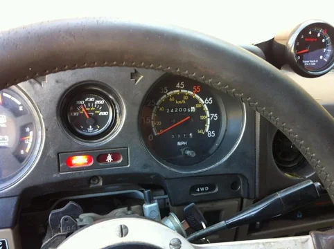

Engine has been running warm and I haven't had time to mess with it until now. I got the carb rebuilt, switched out the temperature gauge for a mechanical one, and my buddy help set timing tonight. Cruising at 190 which made me happy, I've never had it run that cool. The engine feels way better after that carb rebuild too.

Nice... Mine seems happy at 190. My electric fan kicks on at that temp then stays on for a min or so then kicks back off. I plan on putting my fool injection back on soon.
My timing seems happy at 35 ish total timing. 10-12 initial.
I'm just running a flex fan. I figure it's Arizona and all summer is 110 degrees.

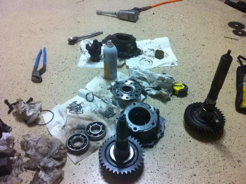

What happens when you thought you made your slip yoke a fixed yoke, but it turns out you were wrong and it wasn't a sealed fixed yoke conversion....you get a trip to the junkyard and transfer case parts all over. On a positive note, I'm happy I coated my garage floor half way through the engine swap.
hehe. Nice coating. My Dad's garage sure could use that. He refused to do it when it was empty. Now its full of car parts :hillbilly:

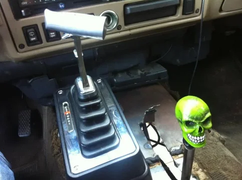

I really wanted that one off "custom" look on the interior of my landcruiser. As if a huge gap in my floorboard wasn't enough, I found this shifter knob at o'reilly for 12 bucks. Steal! The hole got pretty big when I was trying to adjust the throw of the np205 shifter lever, I haven't gotten around to fixing it....
I also installed a tach finally so I could actually know what rpms i'm running at.
76 feet but with the skull shifter that has increased the wheelie distance by at least 10%. It's a pretty essential performance mod.
