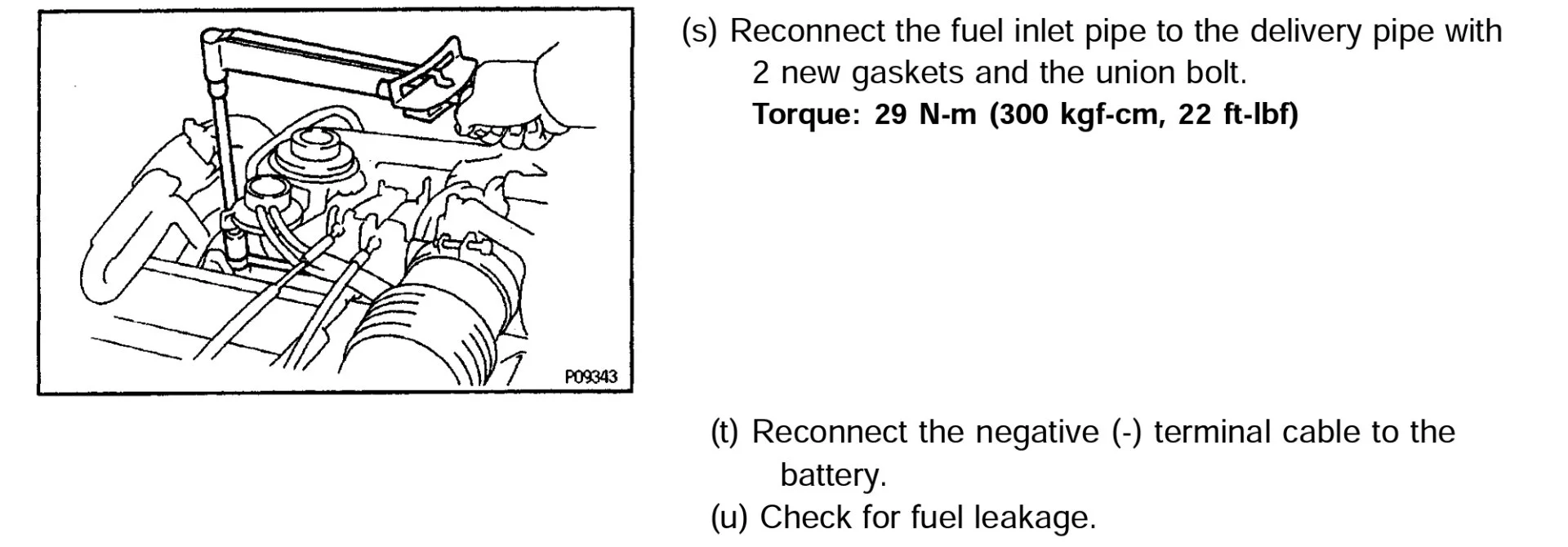

Does anyone know the specs of the banjo bolt on the fuel rail? Same as the one at the fuel tank by chance?
If you mean the one at the firewall end of the fuel rail, it's 22 ft-lbs.

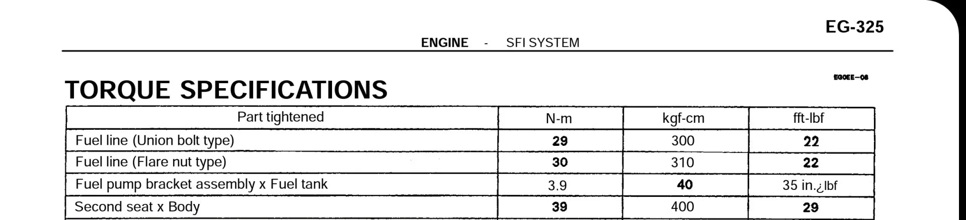

It looks like all the union and flare connections for fuel are 22 ft-lbs.

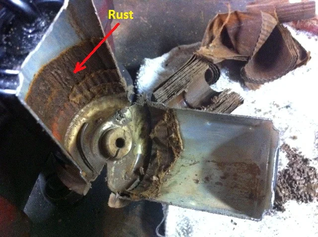

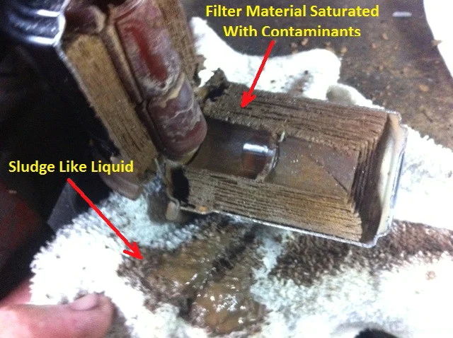

Off of my 100 series when I got it.
There's just no way this can be 'good'....whether or not it leaves you stranded.
As an analogy:
Just because you haven't had a 'stroke' yet, doesn't mean plaque in your arteries should just be ignored. ;)
Yikes! How rusty was the inside of your tank?
Tank was perfect. I looked closely when I installed a new fuel pump. Something about the metal in the fuel filter doesn't like water/moisture.
No kidding? All that rust was from the case of the filter itself?
