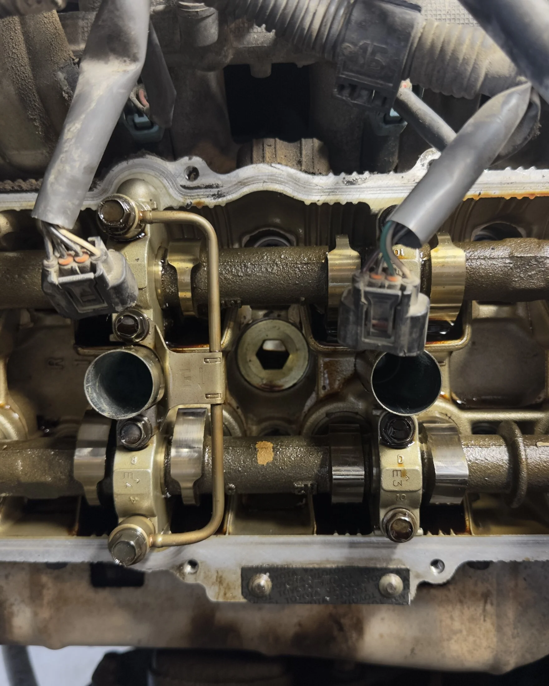

Hey Dudes,
If you have the 4.7L 2UZ-FE Engine and you've never had a valve cover gasket job performed on it, there's a very good chance you have an oil leak somewhere, whether it's coming from the valve cover gaskets themselves, the half moons on the heads, or your spark plug tubes are filling up with engine oil.
These engines by now have racked up a whole lot of miles and this is a maintenance item you'll be facing at some point, unless you don't mind engine oil leaks or your coil packs becoming fouled out from the intrusion of engine oil into the spark plug tube well.
This video in great detail will walk you through this job step by step so you'll have the confidence to get it done right.
I hope you Dudes like it. Happy Wrenching and Sic Mods for All!

I need valve covers bad- haven’t watched the video yet- any other gaskets, seals, thing to replace while in there?
Edit- I clicked on the link- awesome write up and detailed info- THANK YOU SIR!!
I just checked, and found myself guilty of this! I hadn't subscribed to you. Your rear wheel bearing video for the 100 series LC/LX was super helpful - I kicked some beer money your way too just now! Thanks for all the quality content.
You're very welcome. I'm glad you found our rear axle bearing/seal video helpful. Thanks for the beer money. We really appreciate it and thanks for subscribing!
Yeah, we replace the spark plug tube seals and reseal the head half moons. We replaced the PCV valve, PCV valve hose, and some other associated hoses that we found that split from age.
