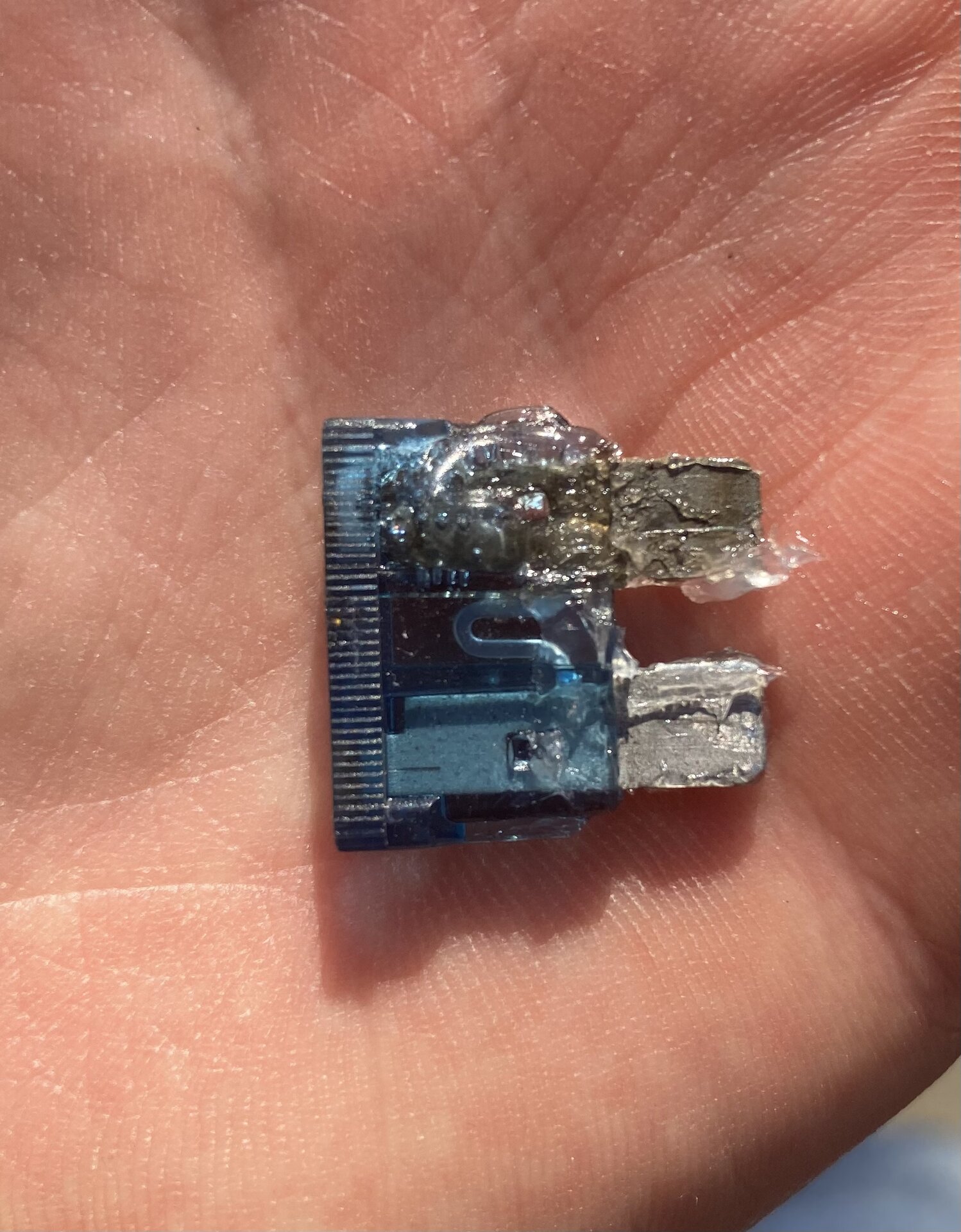

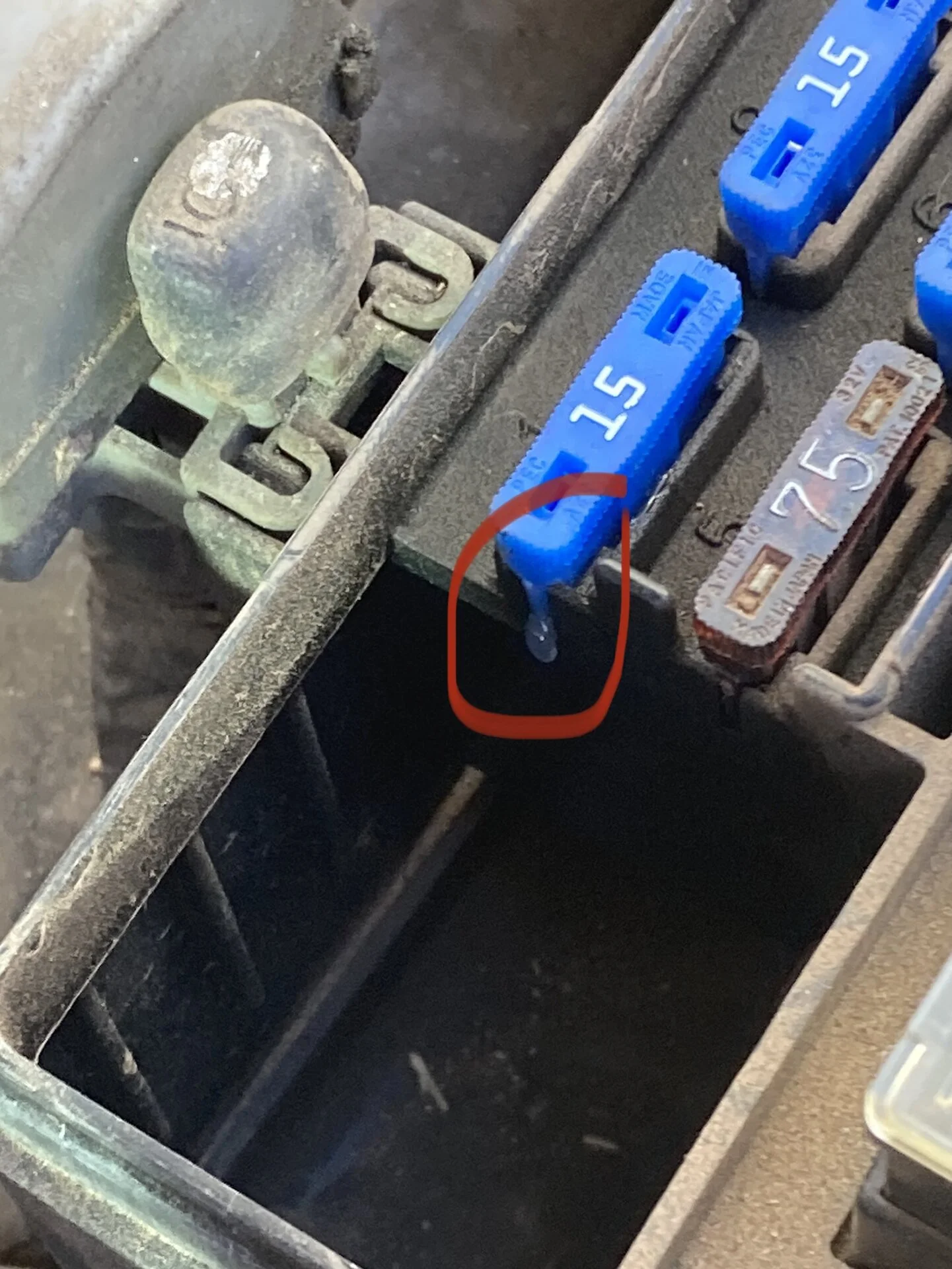

OK - Getting somewhere. Pulled the EFI fuse in the main fuse box (engine bay) and it has burnt up on one leg. Melted the plastic shroud of the fuse there.
So now the question is - what the hell caused that?
Jesus…Swapped in a new fuse and it’s also already melting after 5 min of the truck running.

Also, I picked up a cheap aftermarket EFI relay and swapped it in after the new fuse started melting. Fuse is no longer melting and truck is still running 40 minutes later. I’ll check the O2 sensor wiring now.
