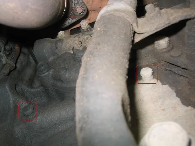

When you guys talk of the rear plug, is this the one you're talking about? It's beind the oil cooler.
No. If my eyes are correct, it is the 10mm plug to the left of your mark. You should see at least three of those plugs along the oil gallery that runs from front to back on that side.
gb
No.. those are bolts for the cooler. If I'm seeing them right they are in the block below the cooler. I see two of them one almost under the cooler and one in the very back almost near the bellhousing. Let me see if I can grab a pic. I had to get under the truck to see them.
Ok.. here is looking up. THe upper left is the exhaust the middle is the blow by tube with the oil cooler above. Both look like they have the 1/8 bsp theads. So when you guys say rear, the one to the left in the very rear or the one in the middle which is circled on the right?
Beat me too it...:D
Yup, below where I was mentioning.
There is a plug right at the rear of the block, one right below the oil cooler section in your pic, one for the stock oil sender in front of the oil cooler, (there is another sender on the oil cooler), then one more plug right at the front of the block.
I took the one right at the rear for the gauge on my BJ42.
gb
Awesome, Thanks! Something I would have never known about or looked for without this board :D
It's easy to see following the galley rib and I spotted the first one too, thanks. When you say there is one on the oil cooler, isn't that the one a circled in the first pic?
I don't know the correct ports on the oil cooler, other then one that the stock sending unit screws into. That is the one I am referring to.
