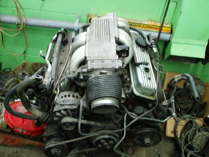

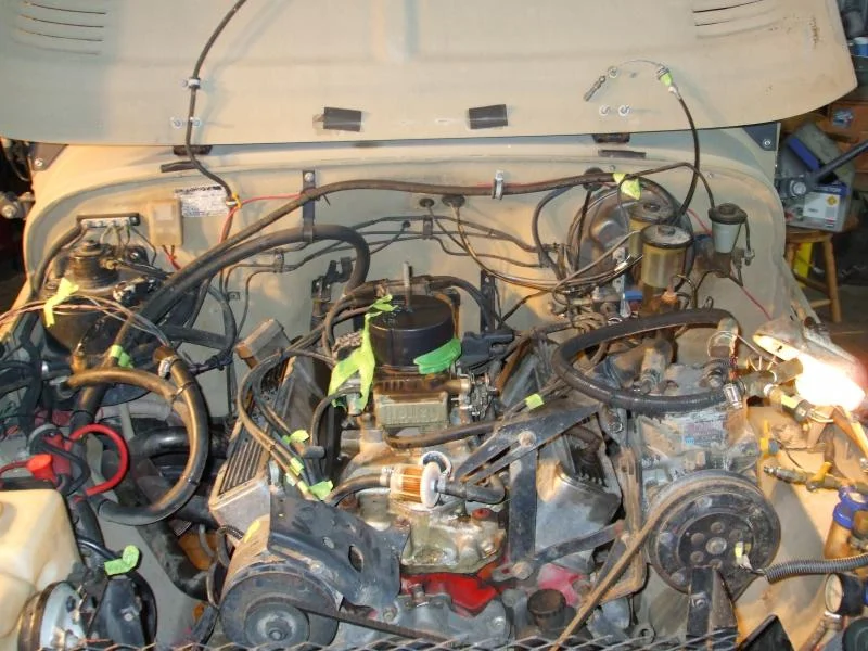

ok let start , i have a 77 fj40 and my carb 350 sbc is dead , it is mated to a downey bell and 4 speed , i just buy a 87 tpi firebird 5.7l . and i have read all i could find on mud for about a week :hhmm:
at first i was to buy an intake to put my holley 670 truck avenger
but since the engine is complete i said why not switch to efi

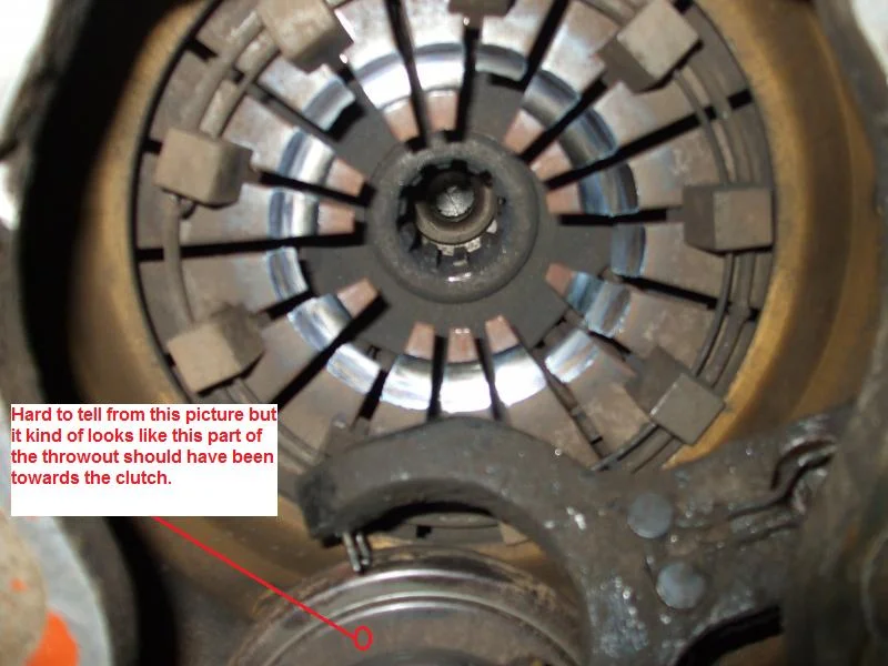

i think i need a new clutch:
I think something was not correct with your clutch components. From the picture, it looks like the pressure plate fingers where being contacted in the wrong place. Could be mismatched throwout bearing to pressure plate or maybe something on the clutch fork was making contact on the pressure plate.
I would definitely be suspect on how that was assembled or what components were used.
