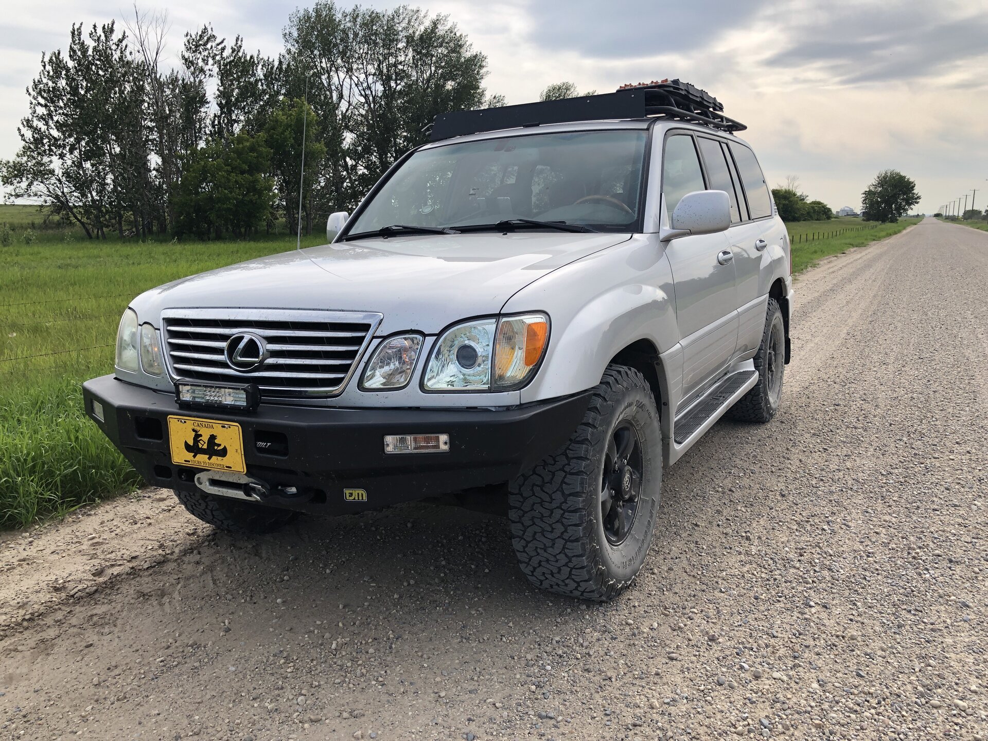

A 1-1/2 to 2" lift is all you need. You can get that by cranking up the front bars and replacing the rear springs.
A 1-1/2 to 2" lift is all you need. You can get that by cranking up the front bars and replacing the rear springs.View attachment 3533456
Not correct, changing ride height will not help fitting bigger tires, they will still rub the body under compression or when flexing, probably touch UCA's too.
To fit bigger tires you would need to use either wheel spacers, body lift, different UCAs or something else that changes the suspension geometry.
Yeah come to think of it I think those are just 33" tires in the pic. I have 35" on my 80 and they fit with just a 2" lift. Thanks for correcting me.
