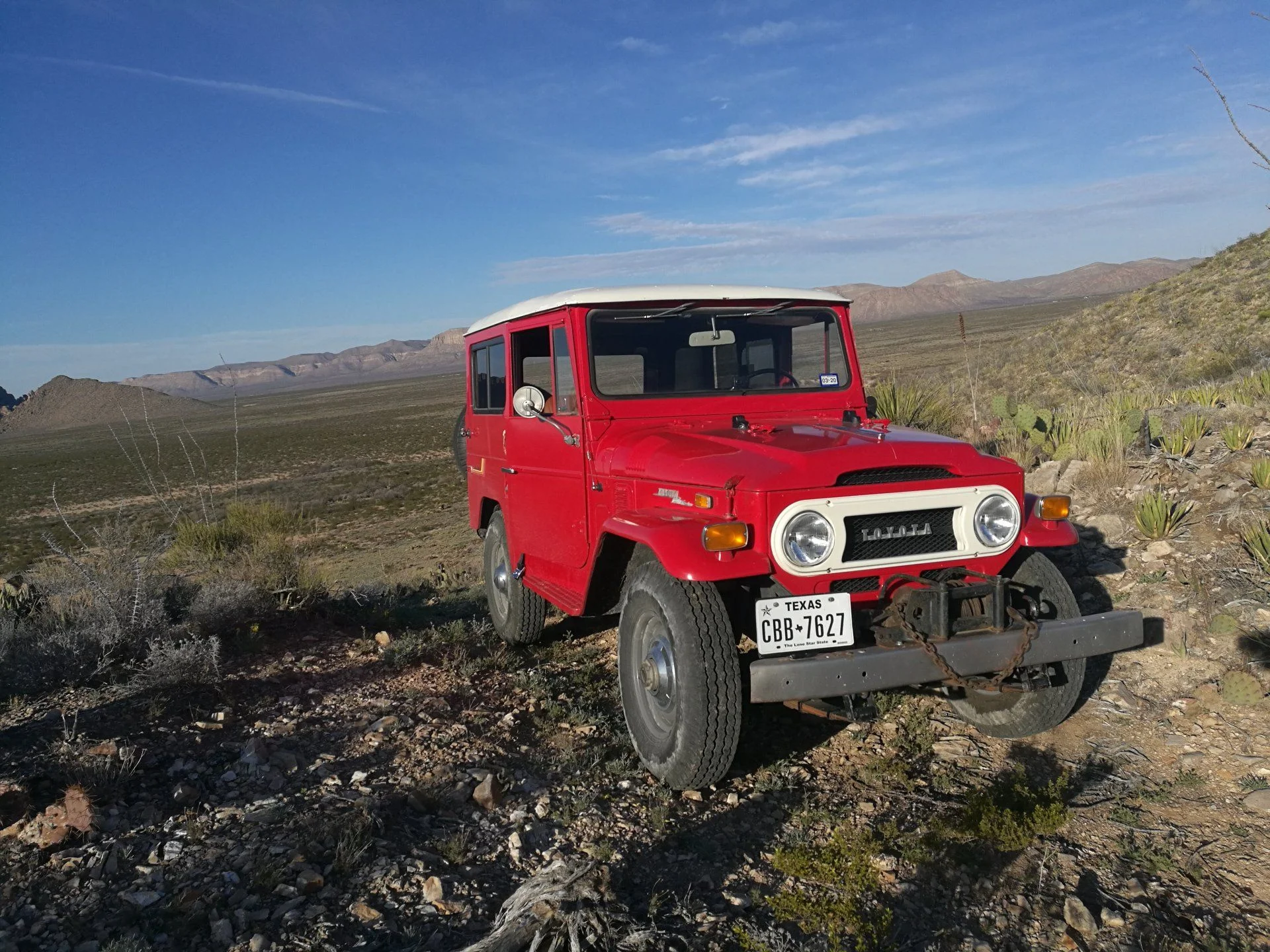

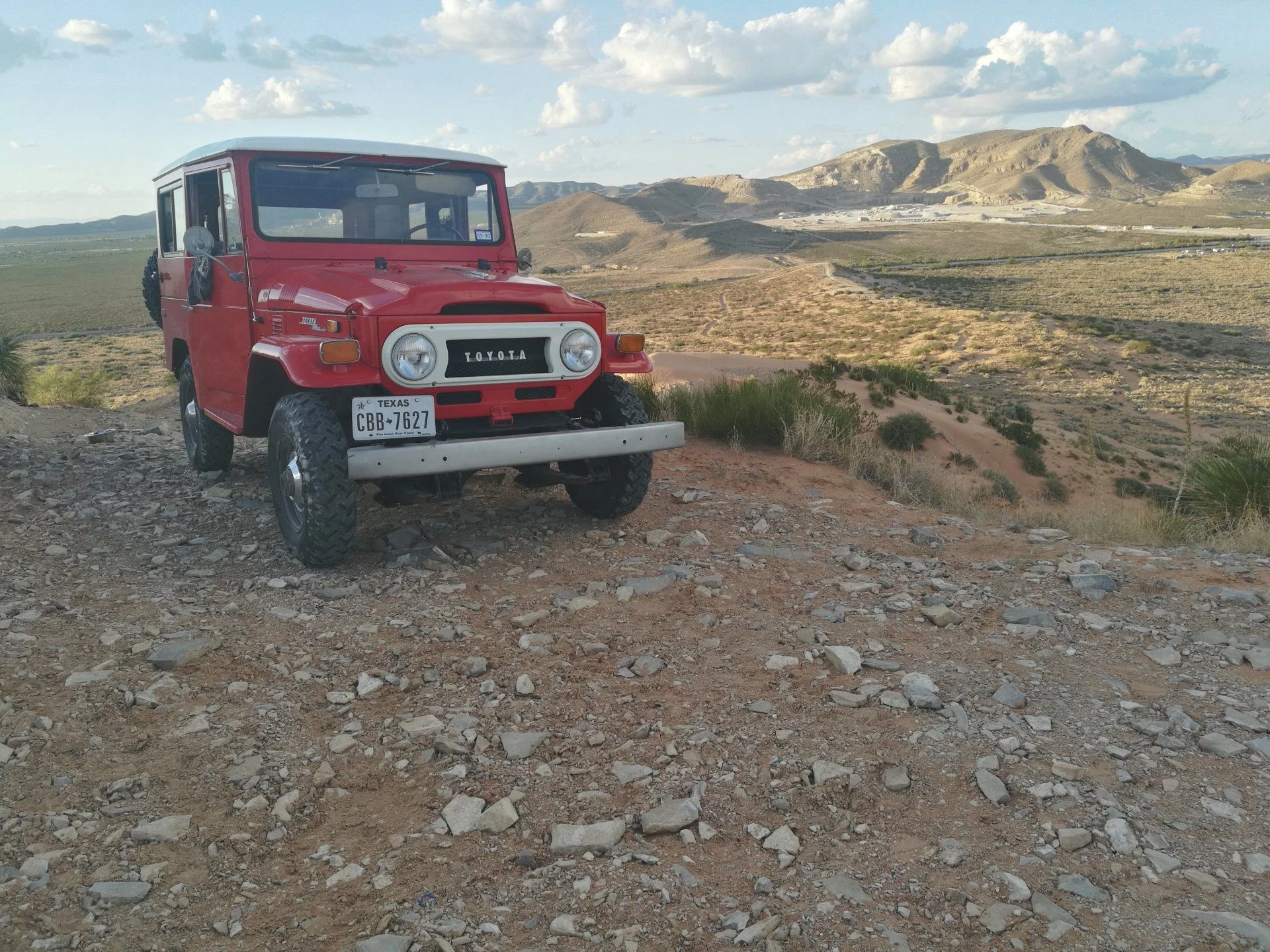

Is the 30” tire enough to support a 65 mph highway cruise with 4.11’s?
If you’ve use this tire and have pics, please share your opinions.
I really want 235/85r16 but I don’t want to buy another set of wheels.
I’m not a fan of the sidewall bulge with the narrow wheel and I don’t want to lift the truck. I did that combo on my 60 and I didn’t like it.
It's for my 40. I also just like the look of a narrow tire. I don't expect I'll be doing much highway in it. I need to do an RPM calculator to see that numbers I'm really playing with.

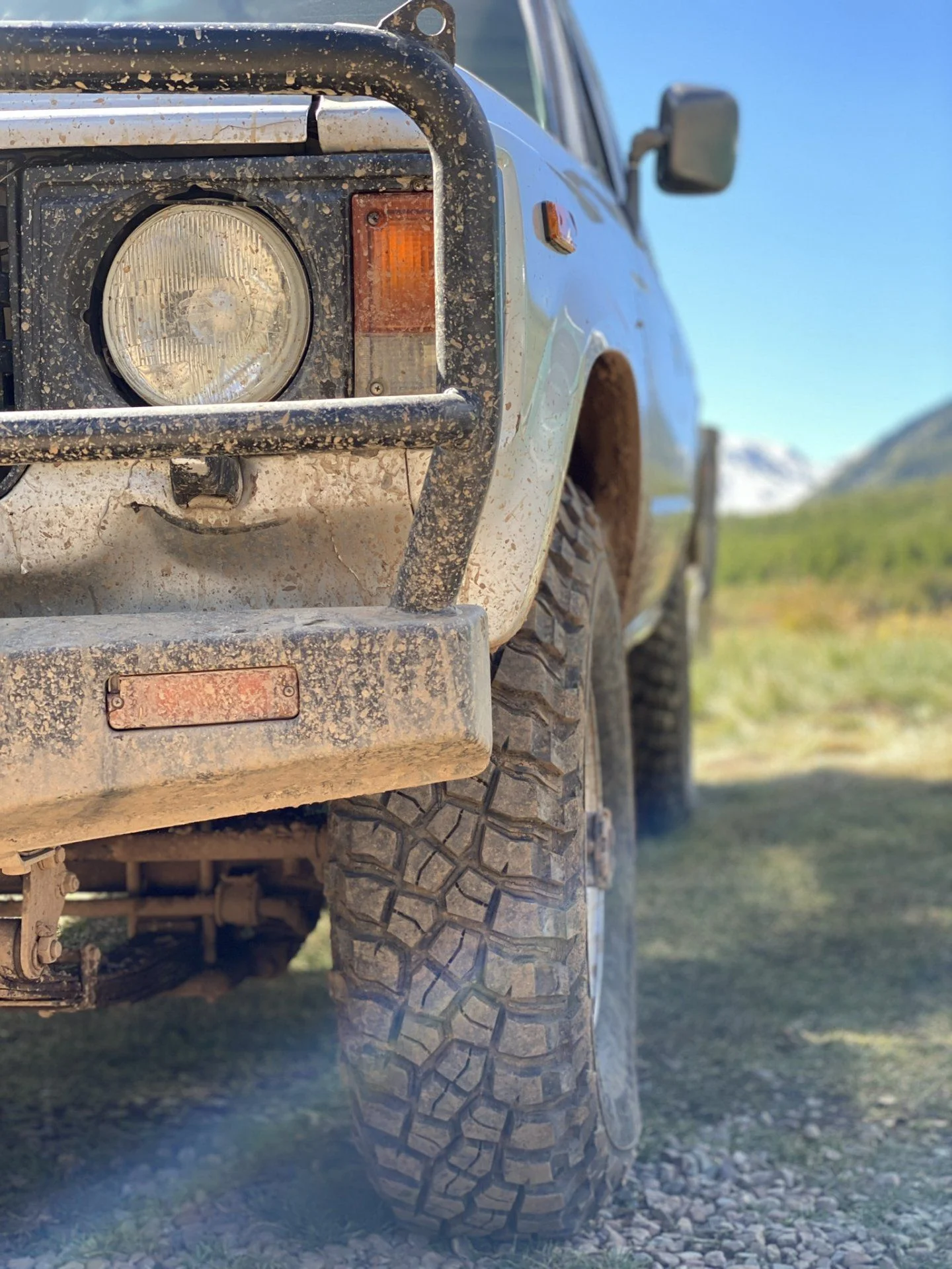

I’m running 255/85r16 on 70 series wheels on my 60. It drives really nicely and I’m hooked on narrow tires. I can do a set of 16x6 Steelies for $500 with narrow tire and keep the highway rpm below 3,000 rpm if I try.
