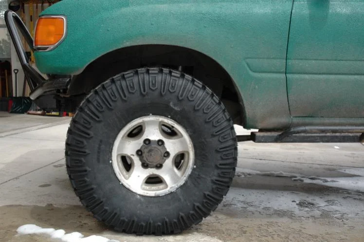

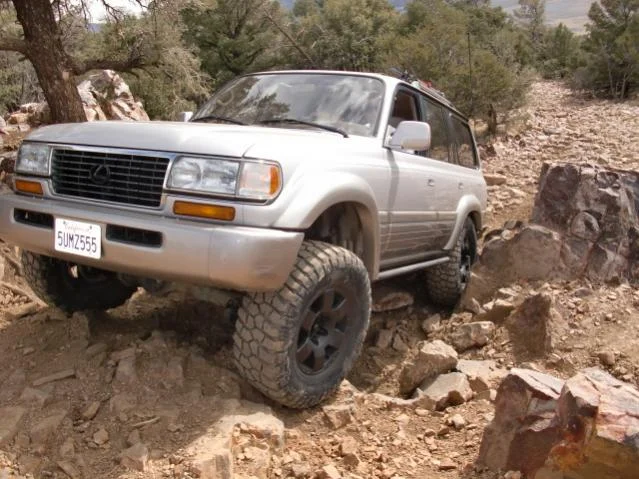

Some pics for you.

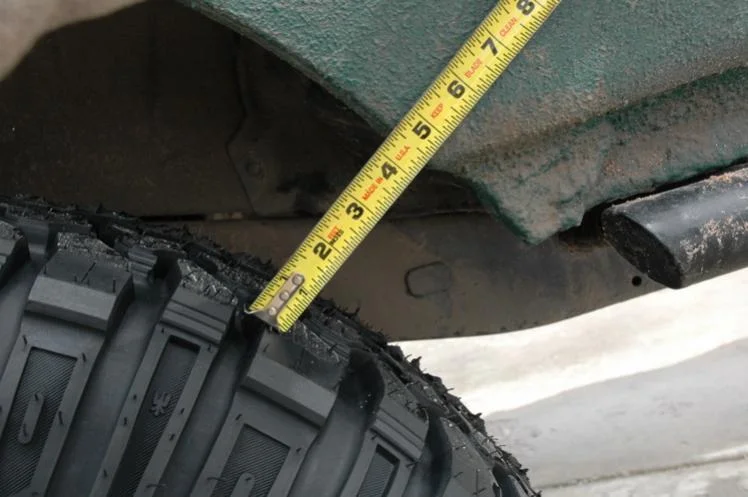

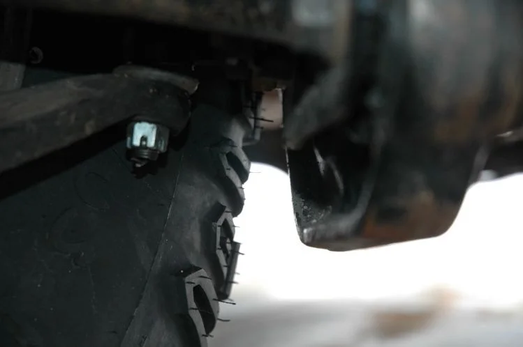

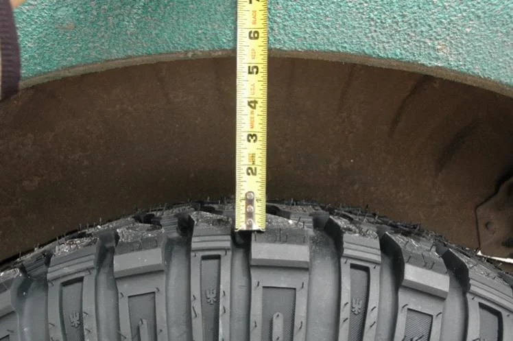

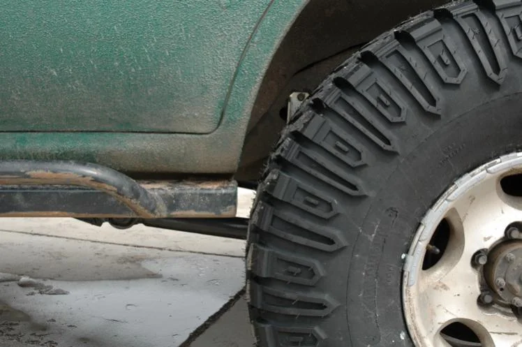

A few more. I lengthened my LCA's 3/8" - the tire would not have fit to the front of the rear wheel well without this.

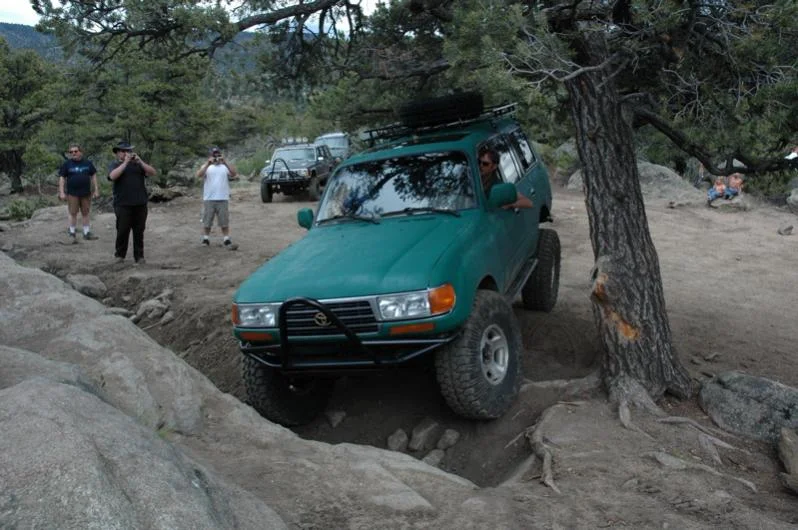

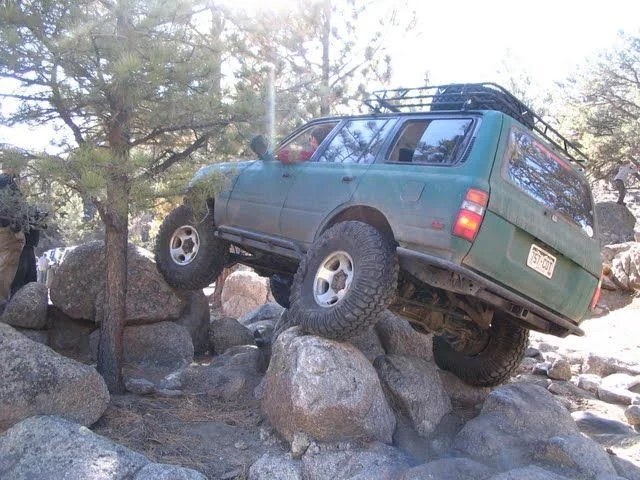

I could not go a half inch more tire without getting into real cutting. And I need a good hardcore wheeling trip to refresh some of my best pics :eek:

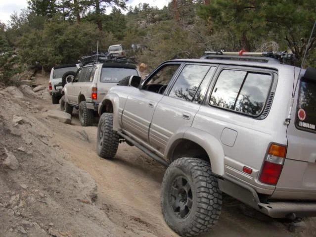

OME Js with a trim pack up front and 37" BFG ATs on Tundra alloys with 1.5" wheel spacers
Here is mine with "J" lift & 20mm spacers up front with true 35's.
