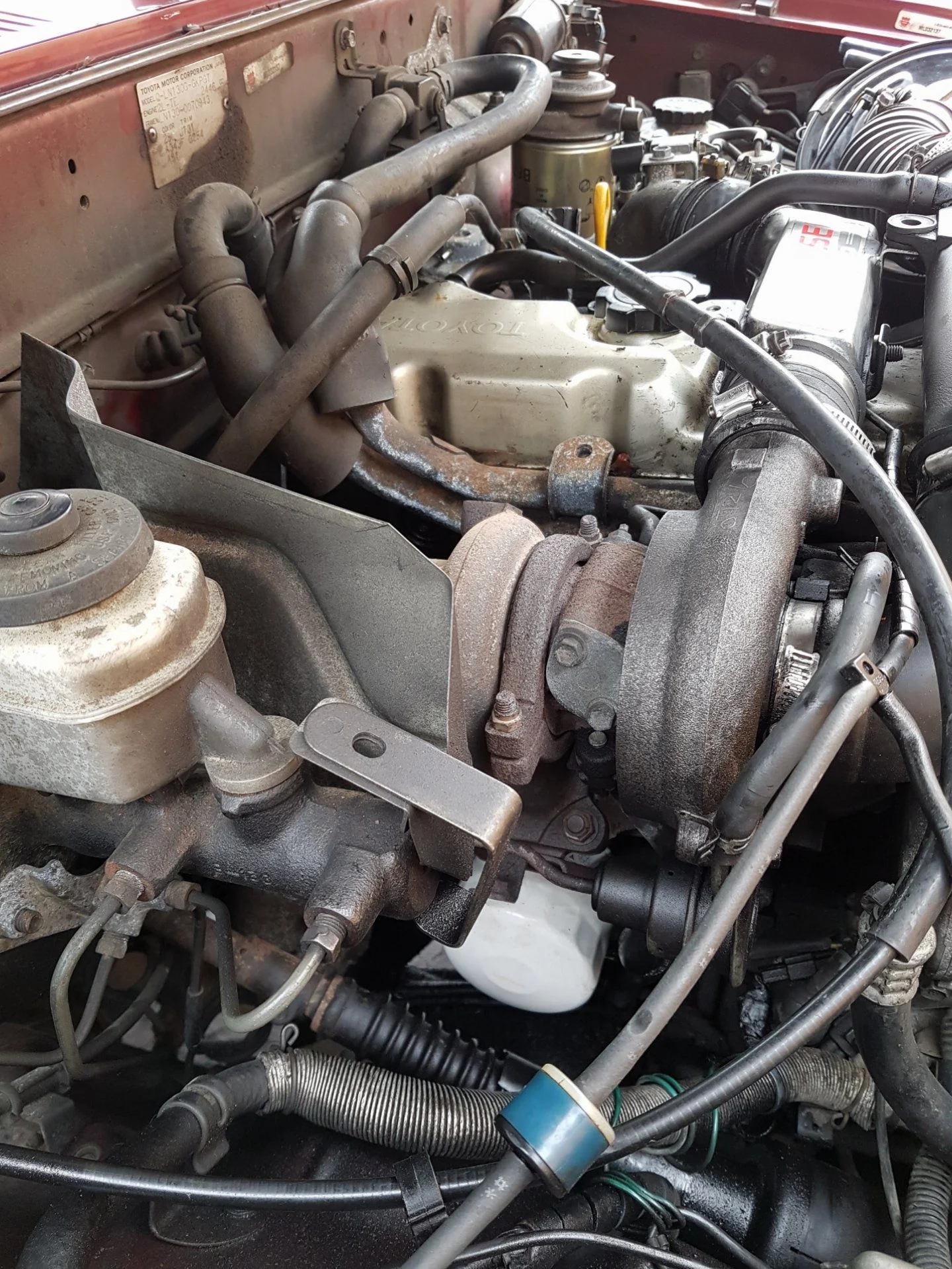

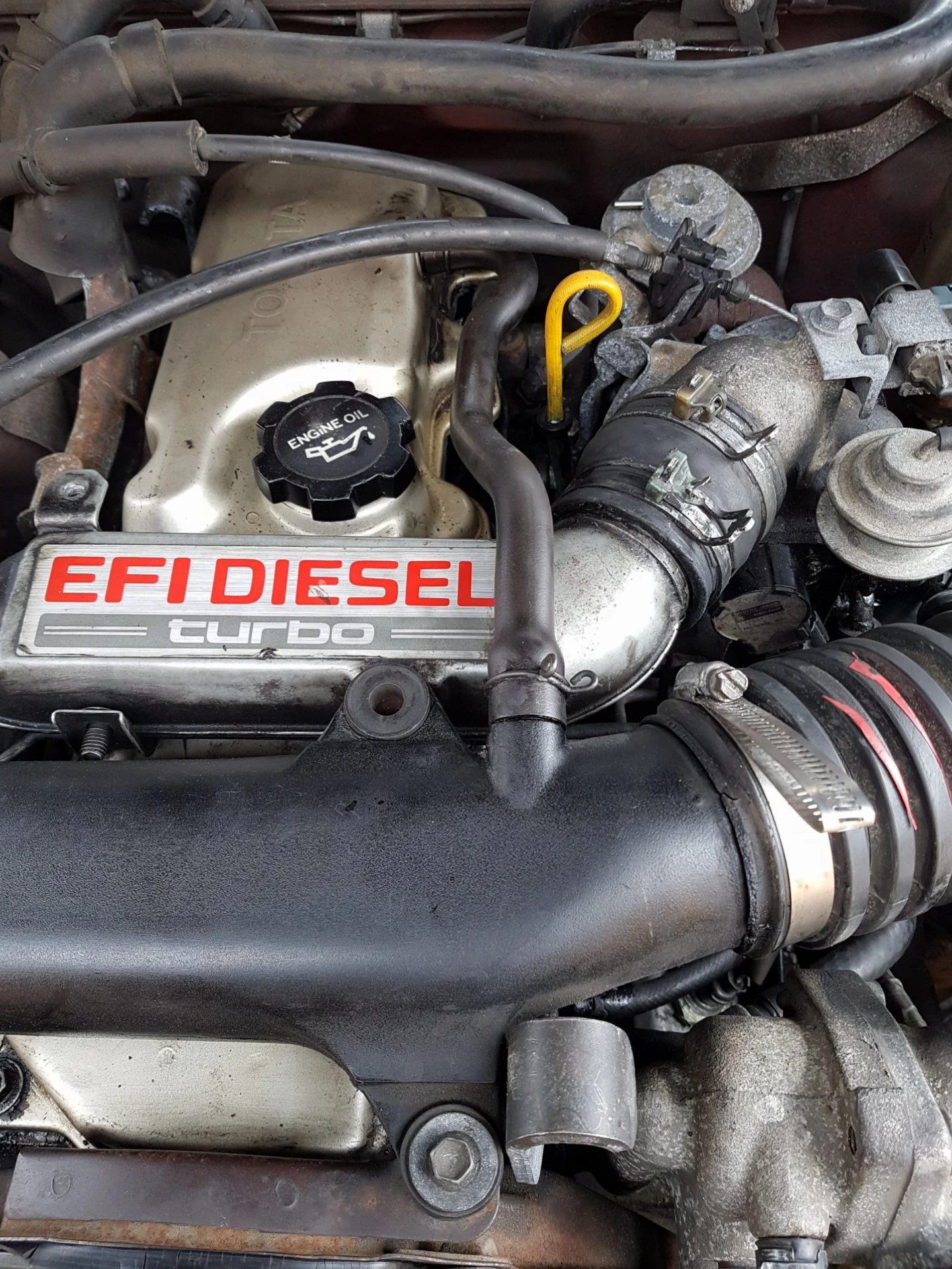

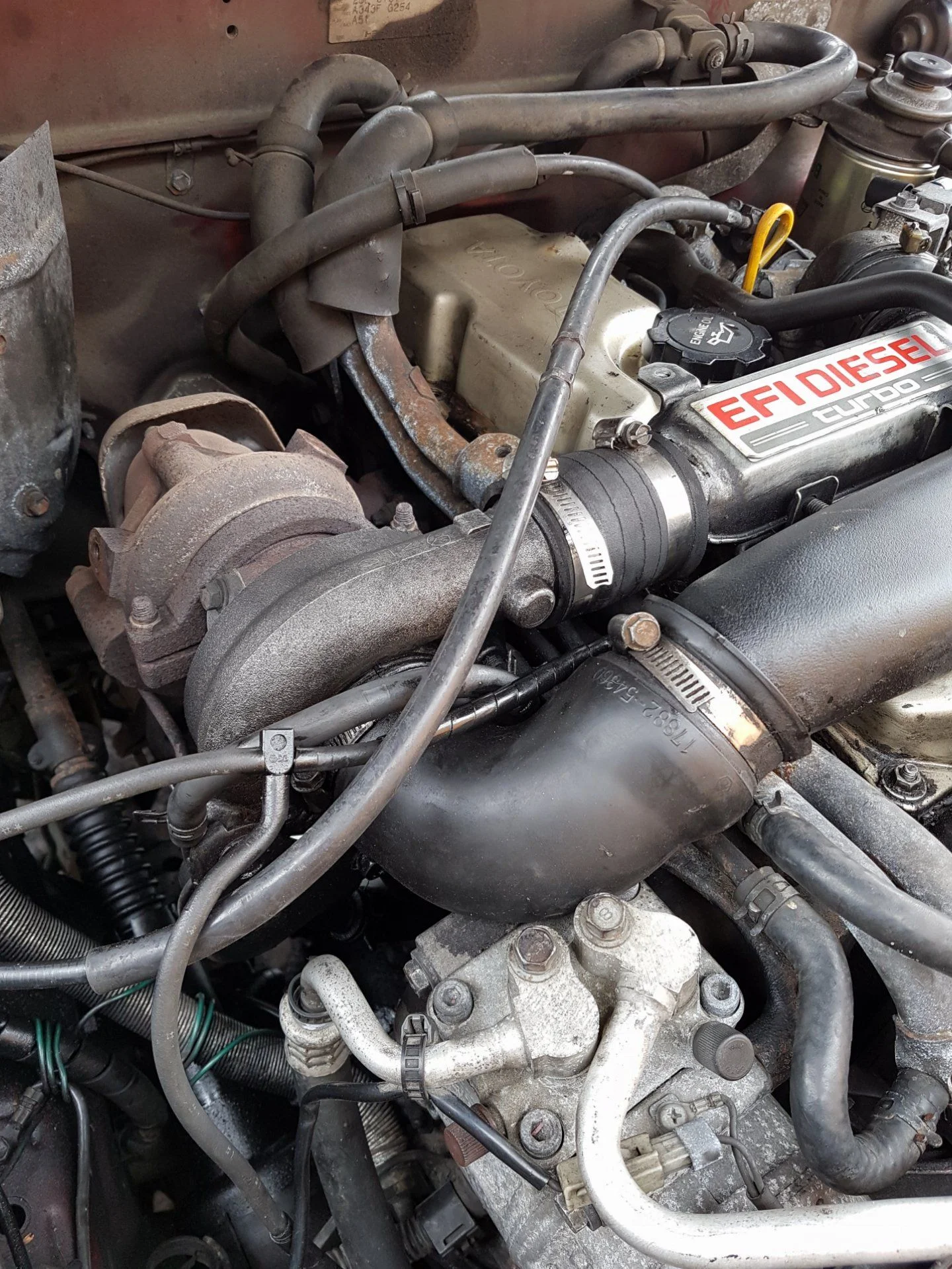

That kinda sounds like why mine won't run. Green light comes on starts boosting . But if u are heavy on the pedal or going up a hill it falls flat on it's face. Kinda irrelevant but can someone help me out i just bought the truck and joined the forum. Drove the truck for a hour so far. The rest of the time it's been in the shop and they haven't come up with anything besides it happens when it's hot . Tried swapping sensors and even the ecu with no chanhe

Post a picture of your engine bay; specifically the area on the turbo side of your engine, and we can help identify if there are any obvious problems.

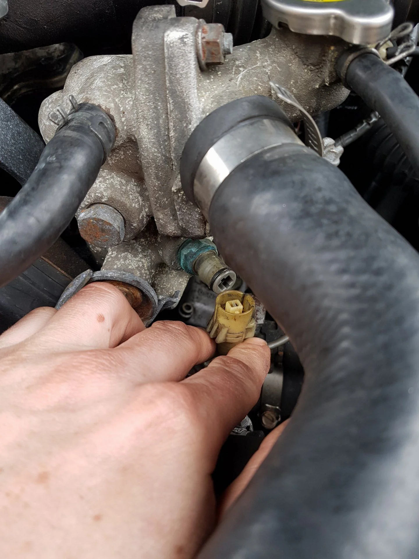

Just got the truck back today will take pics tomorrow. He had a boost gauge hooked up on test drives and said it was making 10psi then dropping off under load. I was also wondering if the cts is supposed to have the same plug as the crank sensor .square hole with a notch . I went to lordco with the part number I got from the mechanic and it came up with a completely different looking plug. With 2 prongs. Is it possible to have them switched?

I'm not sure which sensor you mean by CTS.

I'm in Duncan so I can try and get the codes off of it i found a plug not connected that comes off the sensor he told me yo check. But it's got a plastic cover that it's plugged into but not anything else I'll see if I can post a picture
This is the plug he said was the coolant temp sensor. But part number came up as a different looking sensor. And by matching it by what it looks like it is the same as the crank sensor
