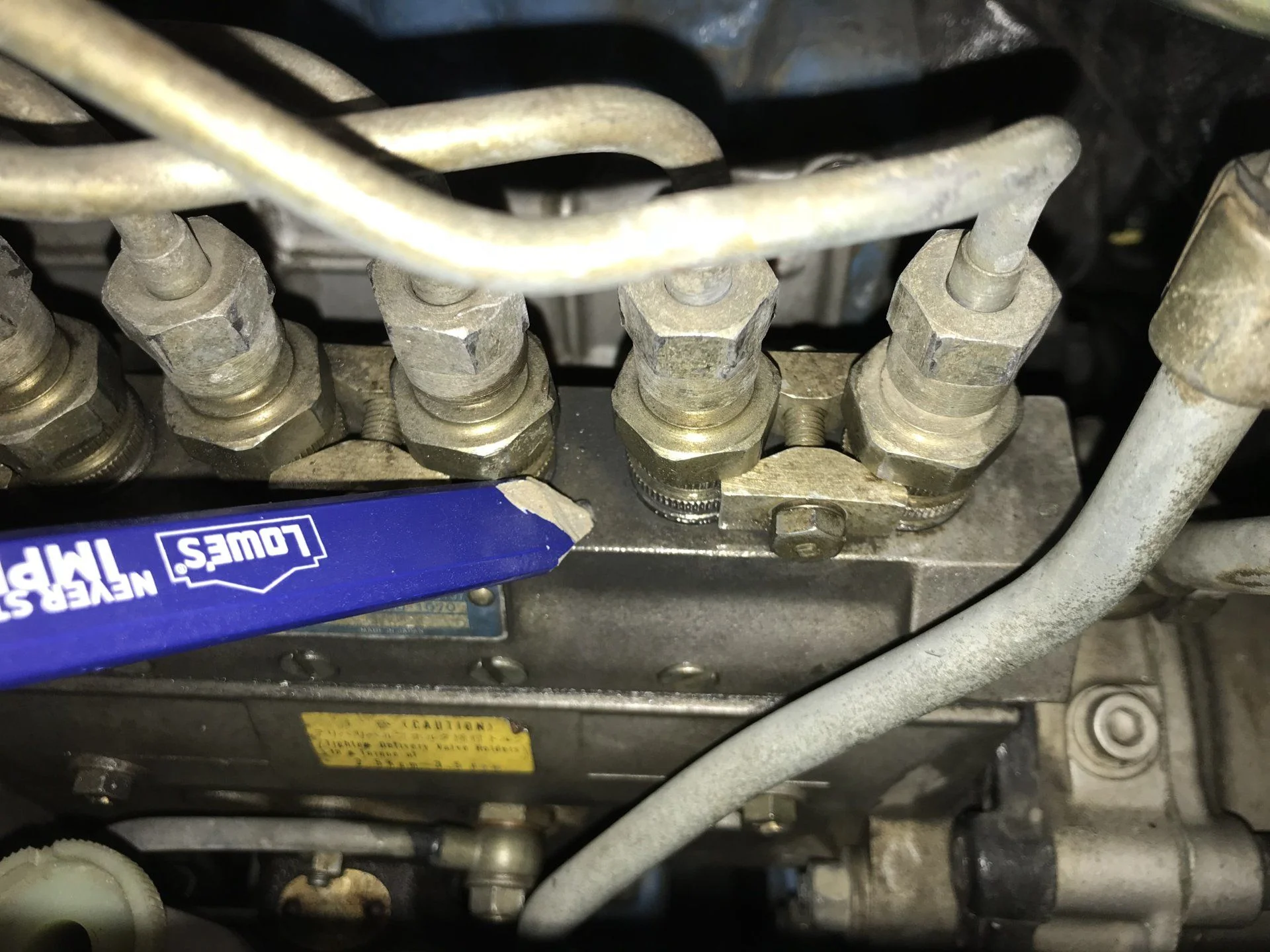

So, looks like I got a leak from the second delivery valve holder. Anyone know if one can remove this delivery valve spring and holder to replace the gasket #22149-76010? Or do I need to remove pump and take it somewhere to rebuild it? Or can I try and tighten it down a little? Thanks.
Try loosening the keeper and snug down the element......gently. I've had loose ones on my 3b before. Leaked a bit when parked and made my starts rough till the air in the line purged. Tightening it just a bit stopped the leak.
g
+1 on gerg - thats the first step.
In addition to the good link above, I wrote a small guide on how to change them, complete with pics..
Nine times out of 10, snugging them down fixes it though.
2H Delivery Valve Gasket changing
Mine was puking fuel. Loosening the clamp revealed a loose nut (that's what she said). Tightened it down and solved all kinds of problems. Although I have not ruled out replacing the gaskets, the problem was fixed for now.
