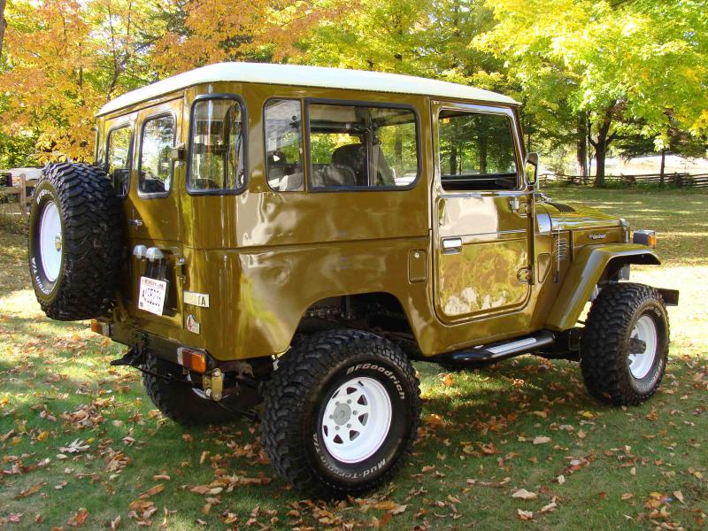

Hi All-
I have just completed the restoration of my 78 FJ40. The truck came out BEAUTIFUL. at this point the engine and all mechanical are 100% original, and running excellent. I am a realist, and know that the I will out live my 2F, and want to throw it out there to see what the suggestions would be for replacing the engine when the day comes. I would rather take my time and find one now, and just mothball it until I need it than try to get whatever is available at the time..
My needs. More power, the 2F is sort of a dog at higher speeds. I like the low end torque, but the only 4wheeling I do is in the snow when the roads are bad. I have no need for something that is more suitable for crawling or mudding. The truck is really more just for my summer ride than anything else. What engine gives you the most bang for your buck? 350SB? Also, it would be nice to have a 5 speed...

that 40 looks awesome. why not just rebuild your 2f when it craps out and add some headers and fuel injection?

That thing is WAAAAY too nice to bastardize with a Chevy or any other engine for that matter...
Mark at MarksOffroad.net is the guy you need to call. He has the down low on the best headers and can work wonders with your carb and would be the go to guy for that project.
Who did the resto work? Where are you located?
Oh yeah...welcome to 'MUD :flipoff2:
