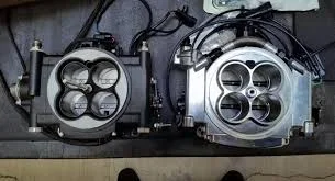

Ive been doing some research on the FiTech EFI and Holley Sniper I posted in the FiTech thread and figured I would drop in here as that is in the 60's section.
Both units are designed to bolt to standard 4 barrel intakes and replace carbs. They have internal ECUs so it is a clean install. Wire O2 sensor, temp sensor, coil (-) for an ignition signal, power, ignition, ground. Both have built in regulators which eliminates the need for an external one. FiTech says it will support engines up to 400HP with its smallest unit. Holley says 600.

I reached out to Fitech. They say the minimum for their 400HP kit is 150HP (however they have been open about padding their ratings in the other direction with the 400HP being able to handle 450.) It will flow up to 750CFM. Holley says the Sniper kit (600HP) has a minimum of 200HP.
I pressed both of them about CFM and displacement because its not like a 3.9L F or 4.2L 2F are small engines, they are just designed to make torque. Both kept defaulting to the HP numbers rather than CFMs. FiTech is definitely the smaller of the two and the more likely option to work. I thought that after seeing it run on 4 cyl engines which presumably move less air at idle than our 3.9/4.2Ls, but Im not going to buy one just to try (maybe I can convince my brother to get one for his 289 Mustang).

Then I got more info from FiTech. As mentioned above, my thought was the limitation would be with the injectors and how little they could flow at idle. However a 3.9/4.2 moves as much volume at idle as other higher HP engines with comparable displacement.
This is what FiTech told me:
"Hi
the system would start and run fine, but with that large of the throttlebody. When you go to wide open throttle the large dump the air. You could possibly lose all intake velocity and it will fall on its face momentarily and probably even backfire through the intake. This is why we have the minimum horsepower requirement."
Does any have any thoughts on this? This would also be true for the Holley contrary to what Woody said.

I think I understand the concern of the tech at FiTech about flow. Essentially it is about intake velocity during acceleration through the manifold/throttle body/air cleaner. It would probably run great at any RPM when the flow is steady and established, but when reving up quickly the wide opening of the throttle body could result in a drop as air tries to fill the void (like a pressure/flow bottle neck). This could result in poor throttle response and air pulsing through, ultimately leading to a backfire. There is some discussion on this physics forum. My idea of adapting it to the stock intake and using the stock air cleaner for a stock look would probably result in the worst air flow due to cross section differences.
Im imagining it ideally as one volume of air you want to move as a slug of air with constant velocity (think air moving down a long straight 4" intake pipe and a draw on one end results in a constant flow at the other) rather than changing its cross section which would result in changes in velocity behind it during acceleration. A wide spot will slow the air down as it moves to fill the space and draw back air moving to the engine (backfire) and a narrow spot will restrict flow (my stock air cleaner.)
That said, people are running 4 bbl carbs on F engines and others put these throttle bodies on 120HP 1.8L VWs so perhaps in practice this concern is wouldnt be an issue.
