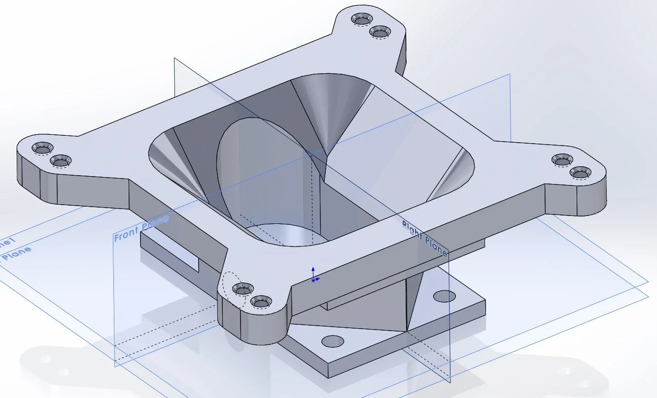

Interesting design. I like it. I ended up buying an old stock 2f to holley 2300 (downey adapter). From there a holley to 4 barrel. This would be great for stock intake.
I was going to pull the trigger on this setup but still waying my options. I now purchased an offenhauser c series intake manifold and 3fe exhaust manifold. This might work but need a spare head to mock up. More precise measuring will be taken soon but some milling would be required in the offenhauser.

I imagine that would also be true for the holley. I like the FiTech and Holley because it was no specific to these size motors like a custom built system or the EZ-EFI. If I wanted to do a 350 swap or go back to a carb I could use/sell the FiTech/Holley so for me there was less risk in the investment.
EZ-EFI did reply to me when I inquired about their kit designed for Jeeps that I have also seen on Ford I6's.
"Ryan,
We could run that kit on the Toyota engine I'm sure. The adapter that comes in the kit for the Jeep intake obviously wouldn't work, but you could adapt it to the Toyota intake, or come up with a different style. Our throttle body systems us a 4150 flange base. The Jeep kits are limited to about 350HP and flow upto 1250 CFM. We offer them with or without universal fuel pump kits for both inline and intank applications.
Let me know what you think and if you need more information or help placing an order, as we can set your up directly."
I need to research if the throttle body they use for the Jeep kit is different than the 4150-style Throttle Body they say supports up to 650HP. If it is not Im not sure why their kit works on our size engines and not the FiTech.
