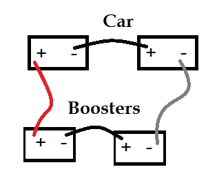

I just made a drawing and I think that point number 1. should be the positive terminal of the right truck battery to the positive of the 1st spare battery

Maybe I didn't understand what you were doing properly. What I would do is connect each spare battery to one of the truck batteries in parallel. With that your left and right batteries would each be being jumped individually. The other thing you could do is use two cars at once to jump the cruiser.
So for Option two make a pair of the non-car battery/booster just like the car (in Series, 1 positive to 1 negative only).
Then treat both pairs as if they were one big battery of 24 volts. Connect the free positive of your off-car pair to the main positive post on the car, the one NOT linking the batteries together. Then connect the unused negative of the off-car set to a good ground on the vehicle.
Perfect, thanks jblueridge! That's the best diagram I've seen yet and confirms my 2nd option! When I first wrote it out it sounded logical until I drew it out like you did. It's just 2-24 volt batteries in parallel.
