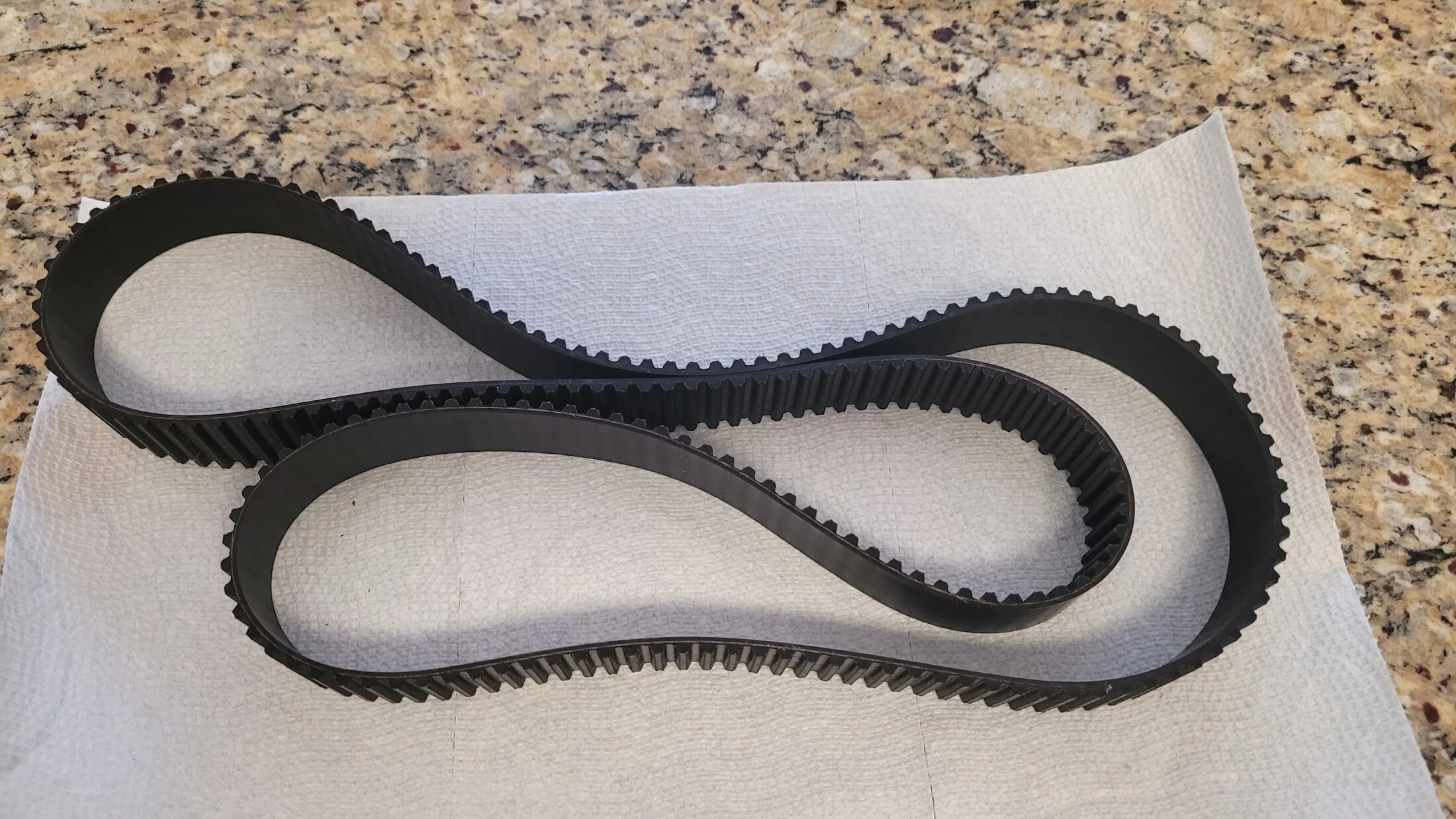

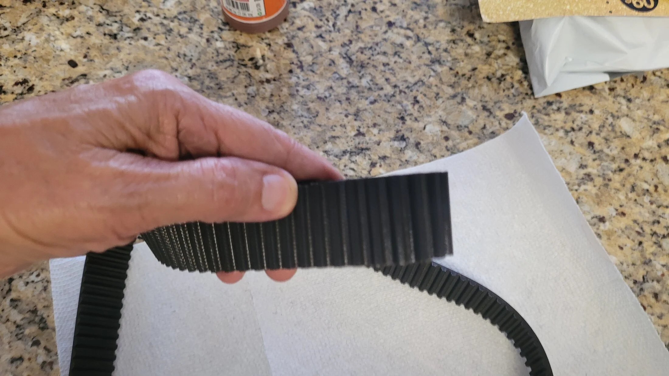

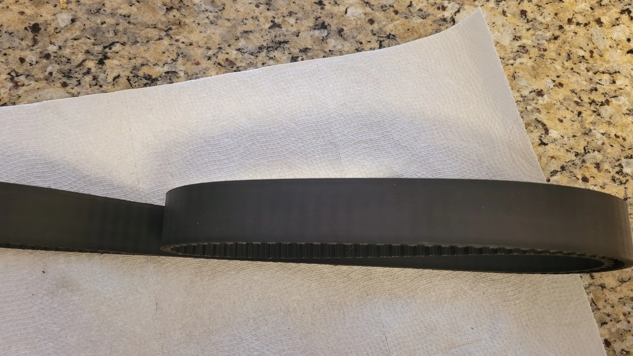

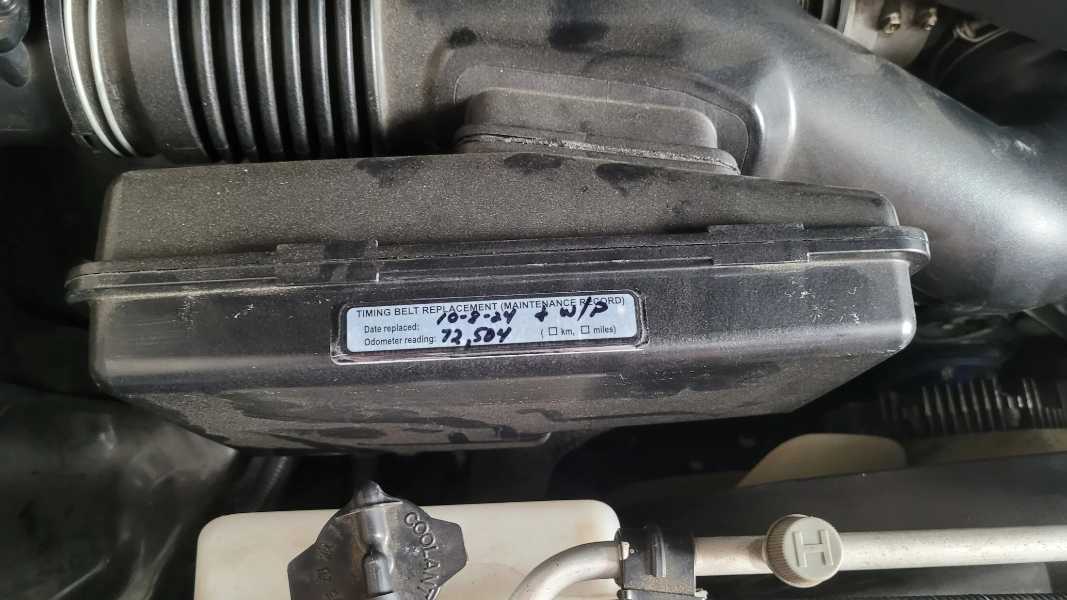

I just had the Timing Belt replaced in my 2002 LX470, along with Water Pump, Idler and Tension Pulleys, Crank Seal, flush Brake System, and Serpentine belt.
I thought for conversation showing what an original 22 year old Timing Belt looks like with 72,506 miles.
My LX470 was pretty much pampered all its life living in a garage and primarily a "Mall Cruiser". I did do some towing with my Travel Trailer.
It spent its entire life in California and then here in North Carolina.
The Serpentine Belt did look about worn out with some cracks but nary a crack with the Timing Belt.
So what do you guys think about the "replace Timing Belt at 10 year intervals"? Maybe a little too conservative?

Just replaced the original belt on my 2003 with 104,000. Car lived in Maui until now in CO. I too was surprised by how good the belt looked. No cracks or strange colors though I am no belt life expert. The work was fun and I’d say the peace of mind was well worth the replacement efforts. How did your water pump look? Mine showed signs of leakage insignificant enough to show on the ground or skid plates.

Yes I think those intervals are very conservative and rather costly.
Totally depends on vehicles usage / environment that it lives in. 10 years /90k miles is a good rule of thumb for all belts but doesn't always mean they are worn out. I just think since it's just a critical part of the engine working that it's more of a preventative maintenance thing.

While I generally agree that Toyota's recommended replacement interval is conservative, I'd rather be safe than sorry, A someone pointed out, the engine failure won't come in my neighborhood, it's going to happen in BFE!
Also, in hot dry climates rubber components deteriorate at a much faster pace. When I did the first timing belt replacement on my '99 (at ~125K) the belt was in similar condition as the one pictured here. I'm aiming to do a second replacement this coming spring, at about ~100K.

Don't timing belts stretch over time? Would that affect timing? Any way that you could measure the length of your original timing belt and compare it to the new one?
Ironically it's chains that stretch with miles and wear. A well made belt does not stretch - that's one of its great advantages over a chain.
