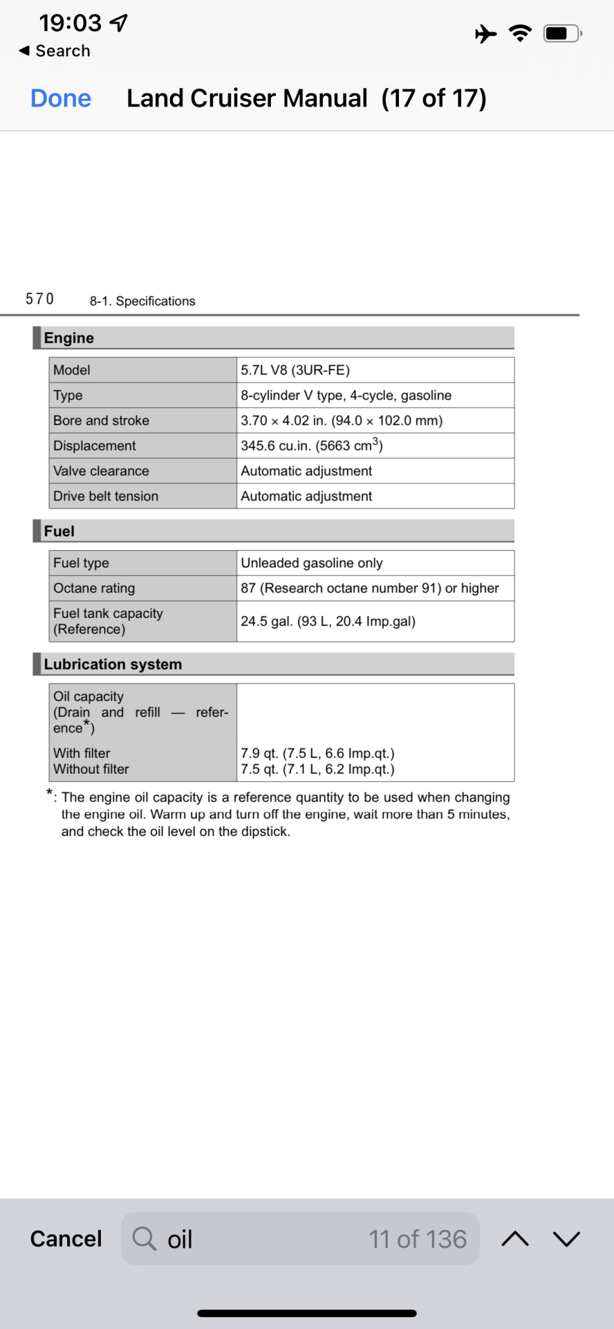

Had looked all over online to confirm oil level. Those with the green dipsticks used 7.9qt of oil with a new filter. I changed my oil on my 2021 HE yesterday, installed the fumoto quick drain valve, and changed the oil filter housing to the metal corolla one while swapping out the inner metal tube.
Filled her up with 7.9qt of Valvoline full synthetic 0w-20 oil, and was right at the middle of the two dots on my dipstick after running the truck for about 10 minutes and taking a quick trip to autozone to drop off my used oil.
HOWEVER, the manual I have says that I'm supposed to be using 8.5qts of oil with an oil change. Did the oil pan change for the 2021 models?

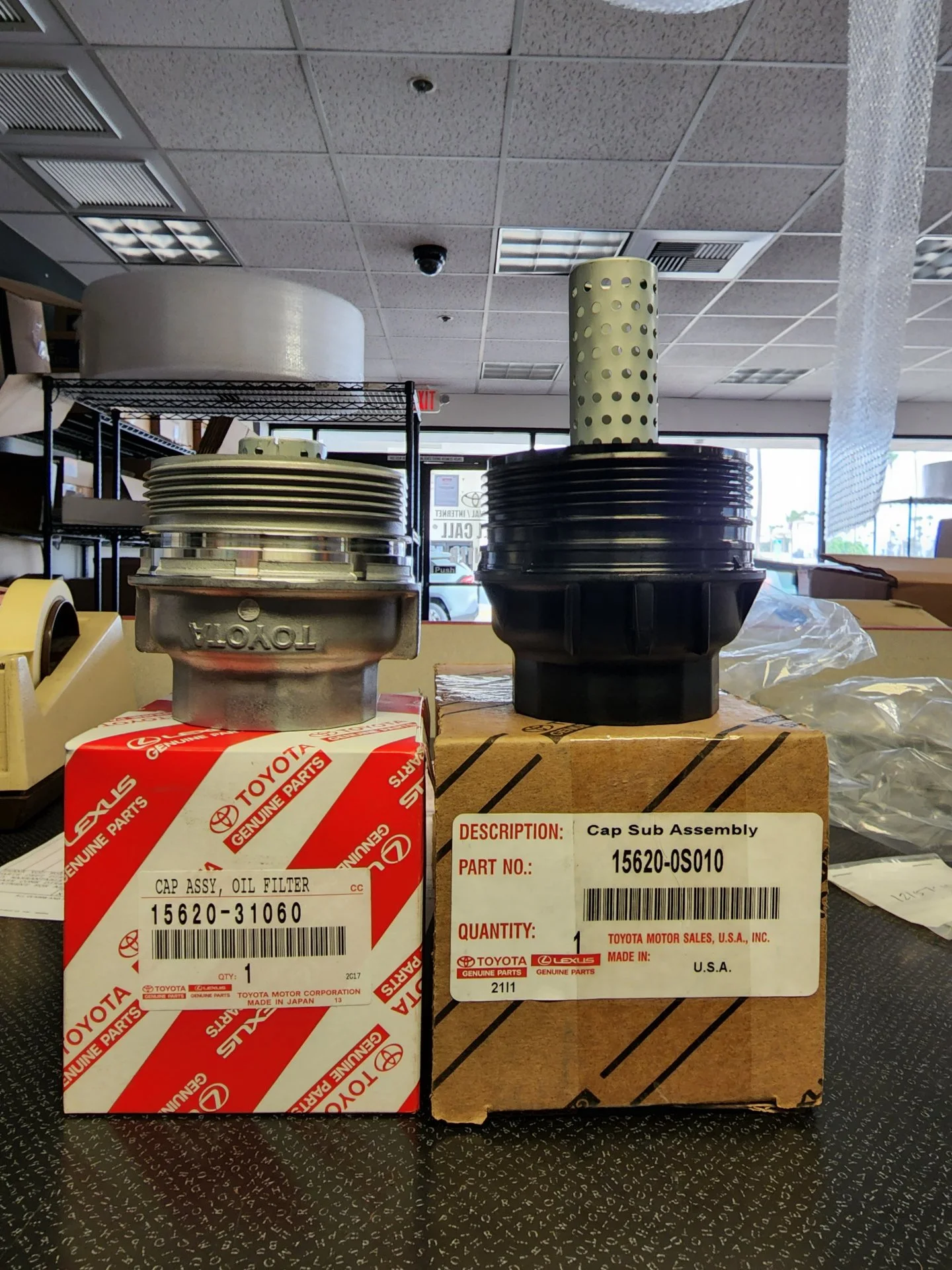

I also want to switch out my stock oil filter housing to the Toyota metal version part number 16520-31060. Here is a comparison of the two. Obviously, the perforated metal sleeve is much shorter on the metal one. Will I need to switch out the perforated metal sleeve between them? Just want to make sure that I am installing the right one.
Yes, bend the tabs to change them out. Bend tabs back
Thank you. Figured that it was going to be simple. Just wanted to make sure that I was picking up the right one.
