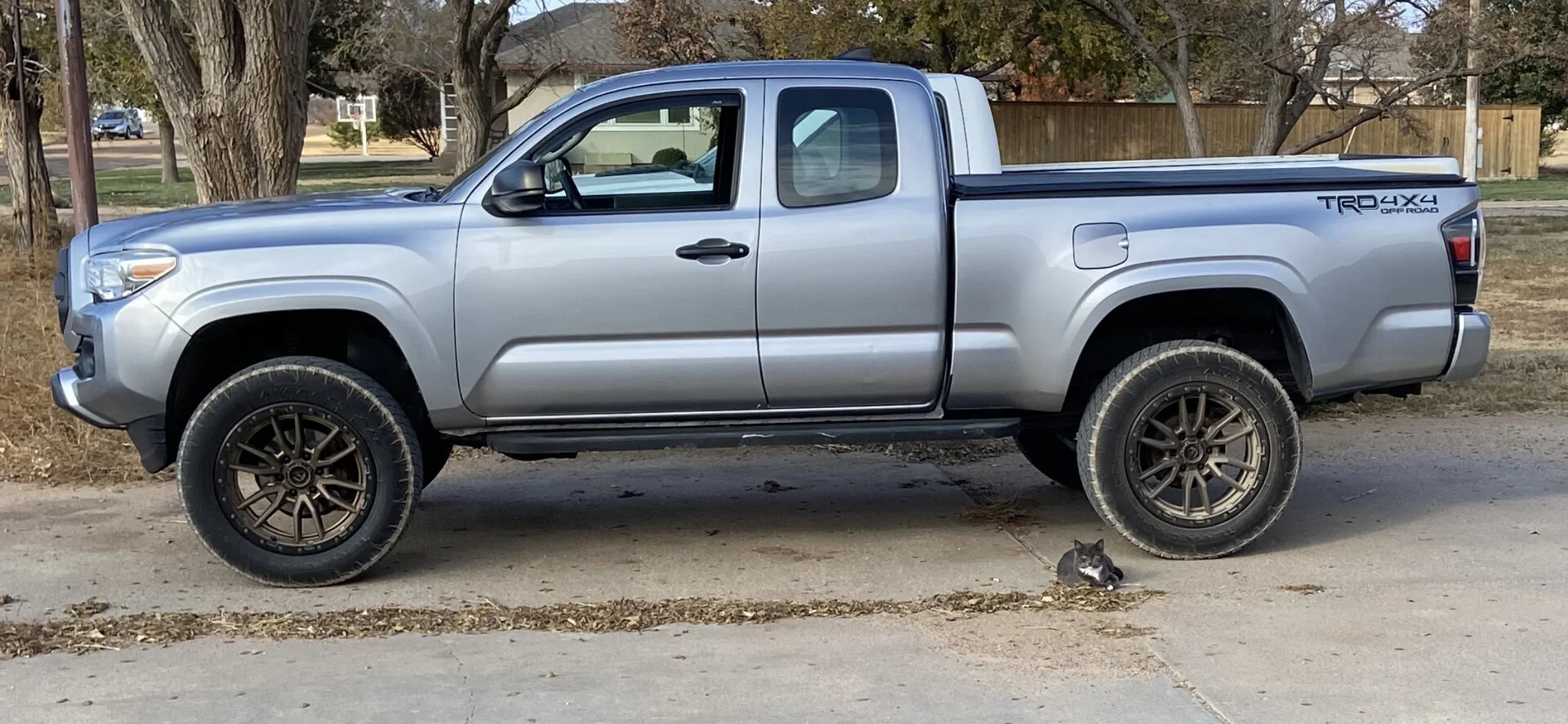

I got a 2017 Tacoma that I'm using as a college pickup. Wish I would have found a manual but the 2.7 Auto is alright ( 22RE is what I'm used to in a small pickup). The biggest annoyance that I've had with this pickup is that it doesn't stay in 6th gear on the highway too well. The previous owner put a lift and large tires and I'm guessing that's making the problem much worse. I don't need the lift and I would actually like to use my bed for work. Returning the rear back to factory ride height seems simple enough but the front seems more difficult.

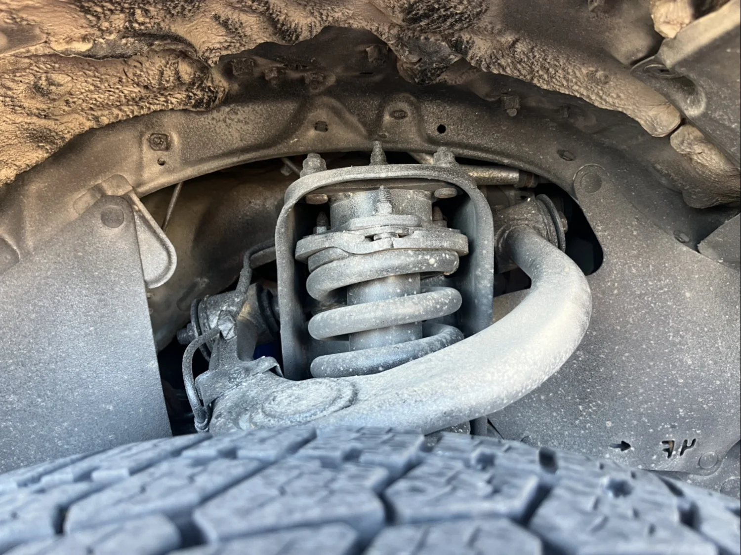

The left pic is my front coil spring while the right pic is of another Tacoma's coil spring I saw in a parking lot:
It looks I'll have to track down a rubber grommet and some other parts but other than that it doesn't look like he put on different shocks or other parts. Will taking off a coil spring mess up the alignment? Is it something that requires a lift or can it safely be done in a garage?

They all hunt on the highway in 6th. My stock TRD off road cannot for the life of it keep the converter locked while doing highway speeds. Its always locking and unlocking and downshifting. Front what I hear it can be tuned out. Your front lift is just a spacer. Remove the spacer that is sitting on top of the strut and re-install it. Spacer lifts are the cheapest and easiest lift to install.

Now I'm working on breaking loose the bolts so I can get it lowered back down.

Didn't see this answered...
Grommet may actually still be there - covered by the spacer. If not, ToyTec usually has them.
Yes - easy to do in the garage.
Yes - you'll need an alignment
