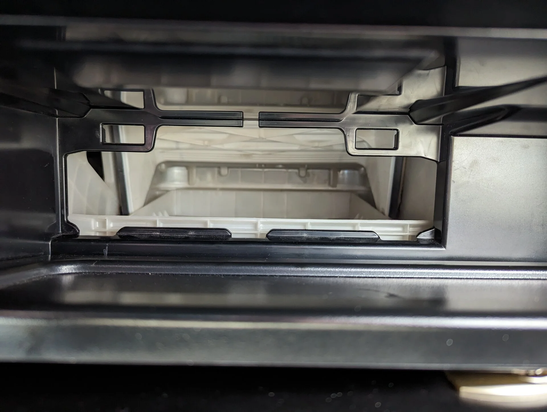

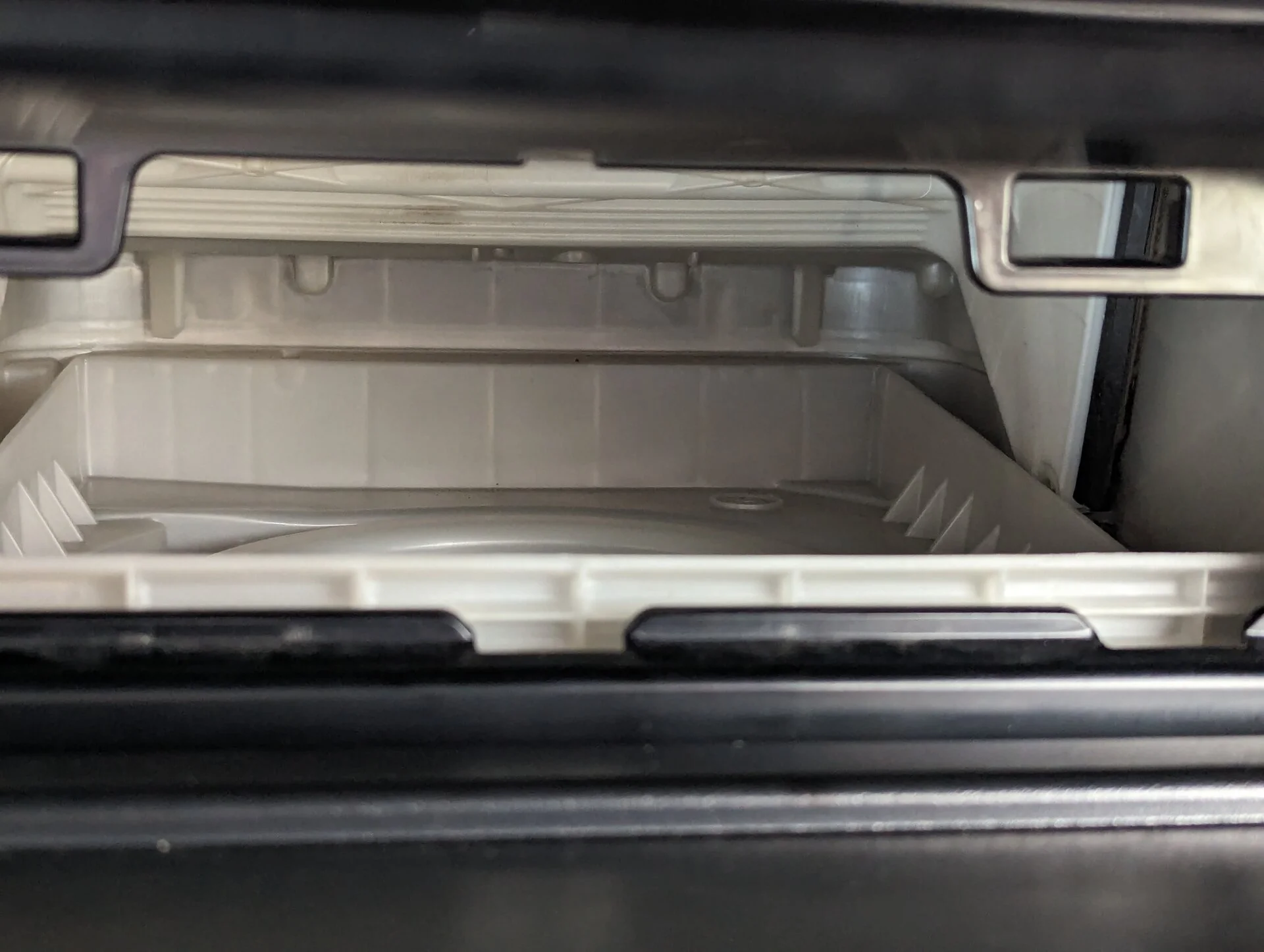

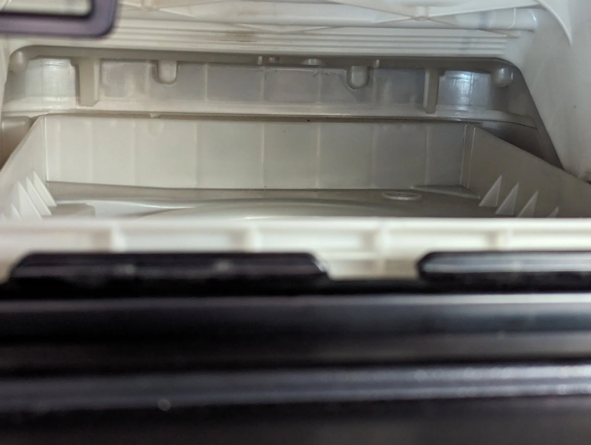

My windows were fogging like a champ last night in my 13 LC. Can someone take a video of a fully functional flap? I’m unsure what I’m looking for. Thanks!!!

My flap can be easily moved by hand to both the closed and open positions with zero resistance. The light does change from one to the other but no movement or sound. Here in Colorado, the cold causes pretty bad fogging so I would prefer to lock it in fresh air mode until I can fix it. Fresh Air Mode would be the flap being down correct? 2017 200 LC.
