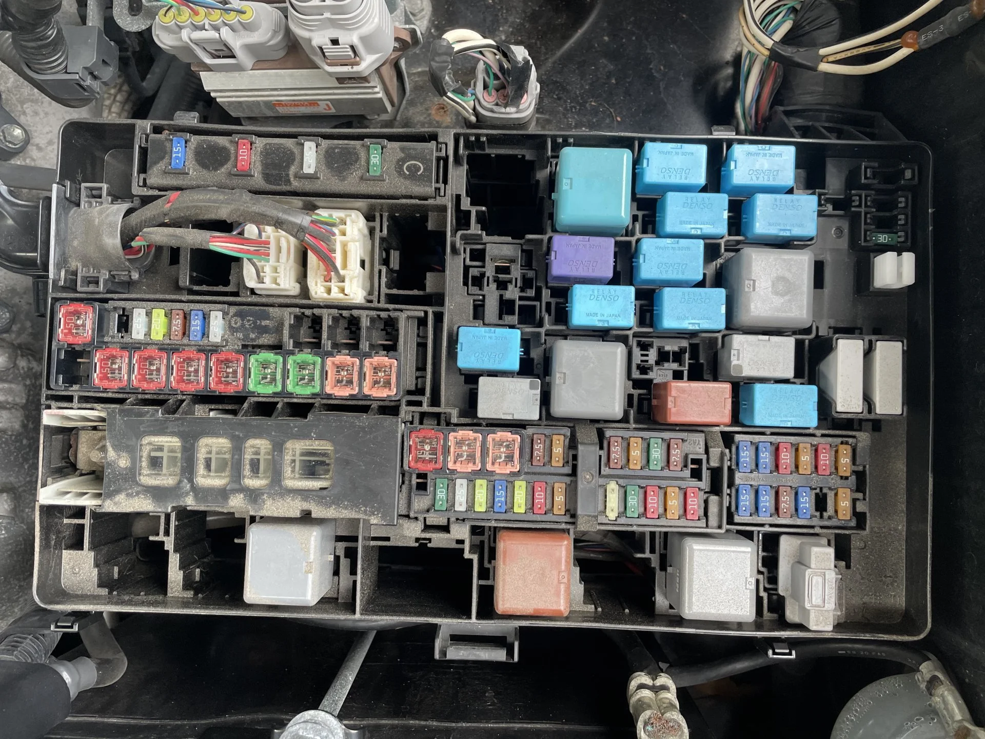

Of course I checked all fuses, one by one, just to make sure I wasn't missing anything.

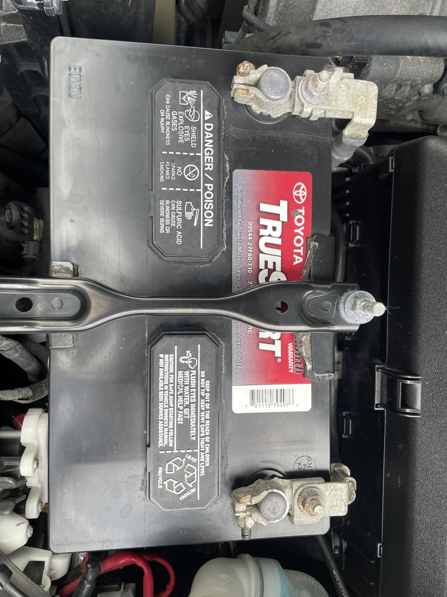

I did read one post where someone mentioned corroded battery connections caused some screen glitches. I feel like my terminals look good - but I'm no mechanic...

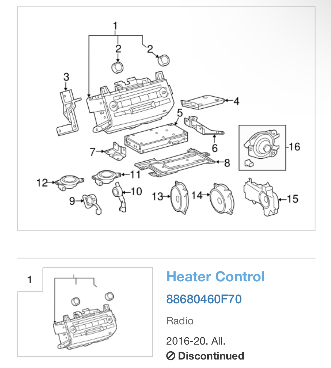

As I remember it, the lower section with the physical radio knobs has a large electronic element to it and.. pure speculation here.. may be important to the operation of the screen. Pretty sure it has important stuff like the hard drive and processor for navigation.
When you got the used screen, did it come with that part too? Was it available? Being the brains of the system I fear that lower part is what needs to be coded to the vehicle and VIN, but we’d need someone more experienced than I to confirm.

This is what I would suspect as well. There are like 3 or 4 metal boxes all hidden behind the center dash (even on the lower sides of the center area) that all work together for the infotainment system.

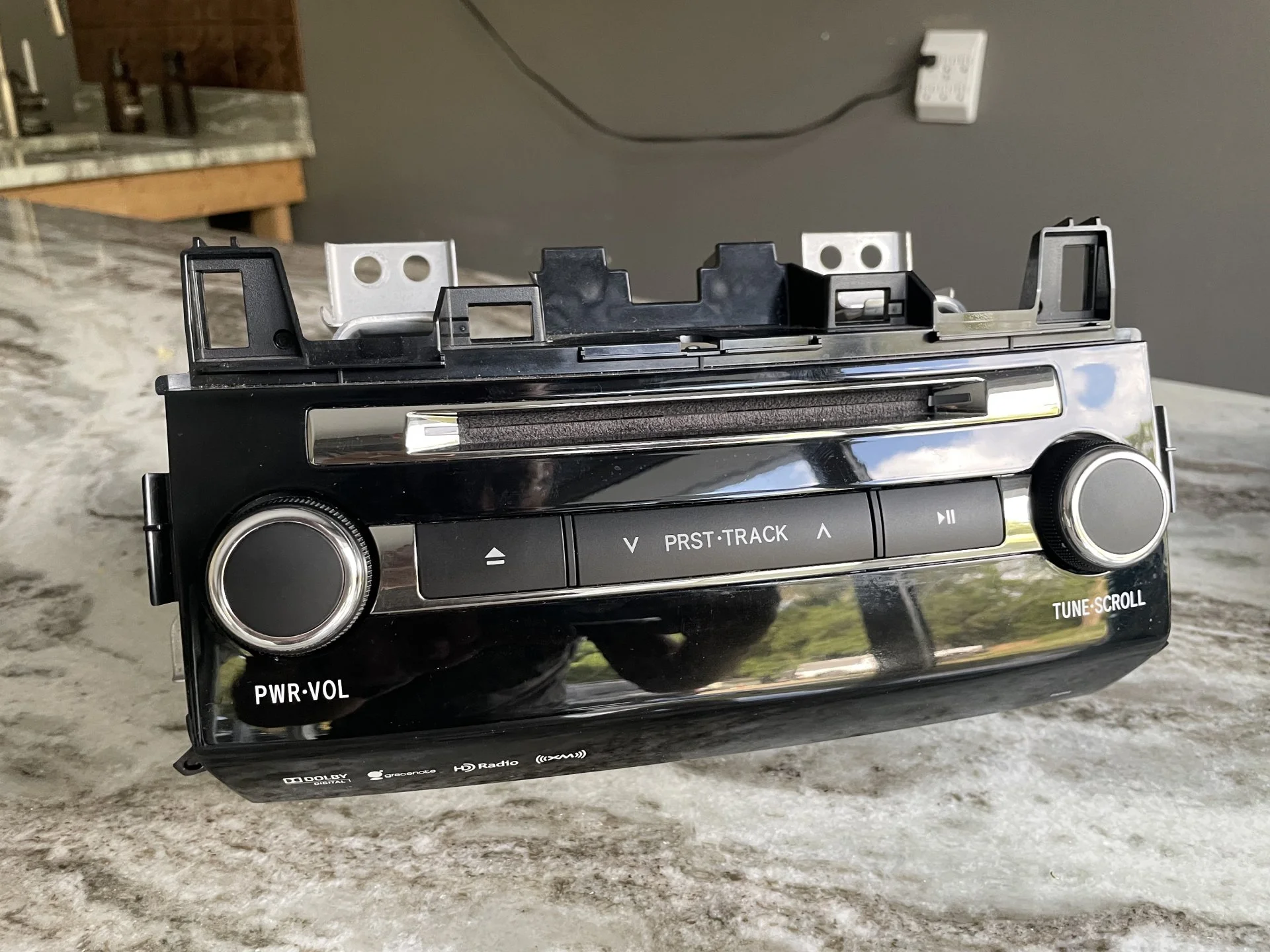

Firstly, thank you so much for your help and quick response.

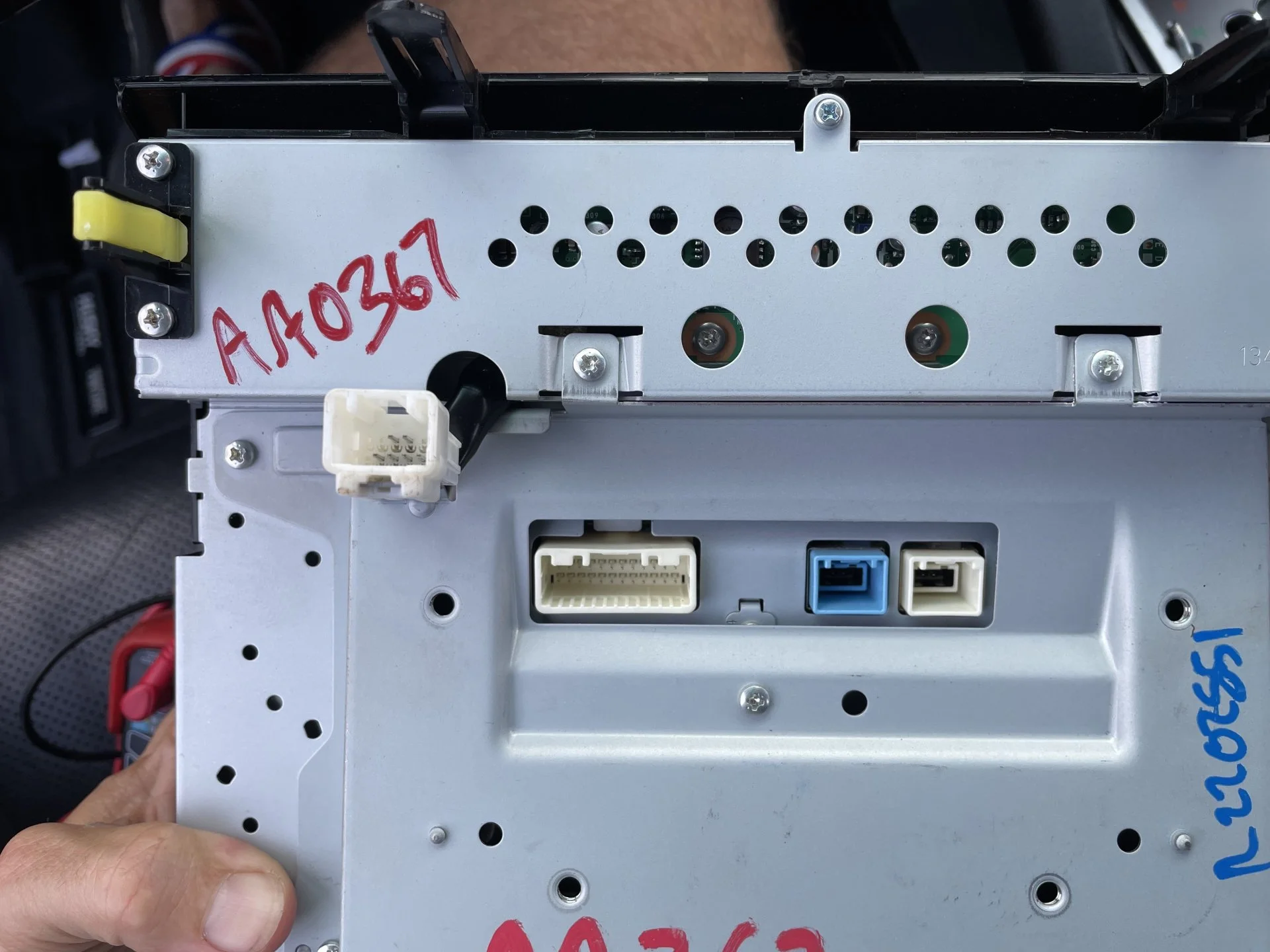

The unit below (that houses the CD/DVD drive and perhaps some other critical components) is a separate unit and was not included in the display I bought. I suppose I can try and find one of those used as well - perhaps I should have started with that. The dealer told me the display was the problem, though - however, not sure how they would have tested that specifically.

Strangely called heater control.
And the box below it is an amplifier:

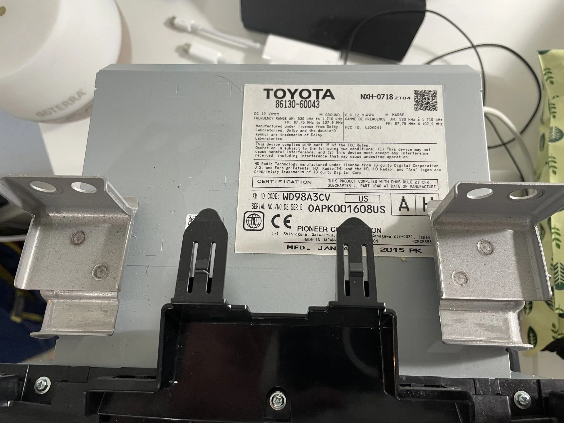

That unit says it's for a 2016 model. I've still not found the part number I'm looking for.
On the unit, it says 86130-60043 - I can find part number 86120, but not 130...
Super stinks since this is likely a part that would be affected by the dang chip shortage we're dealing with.

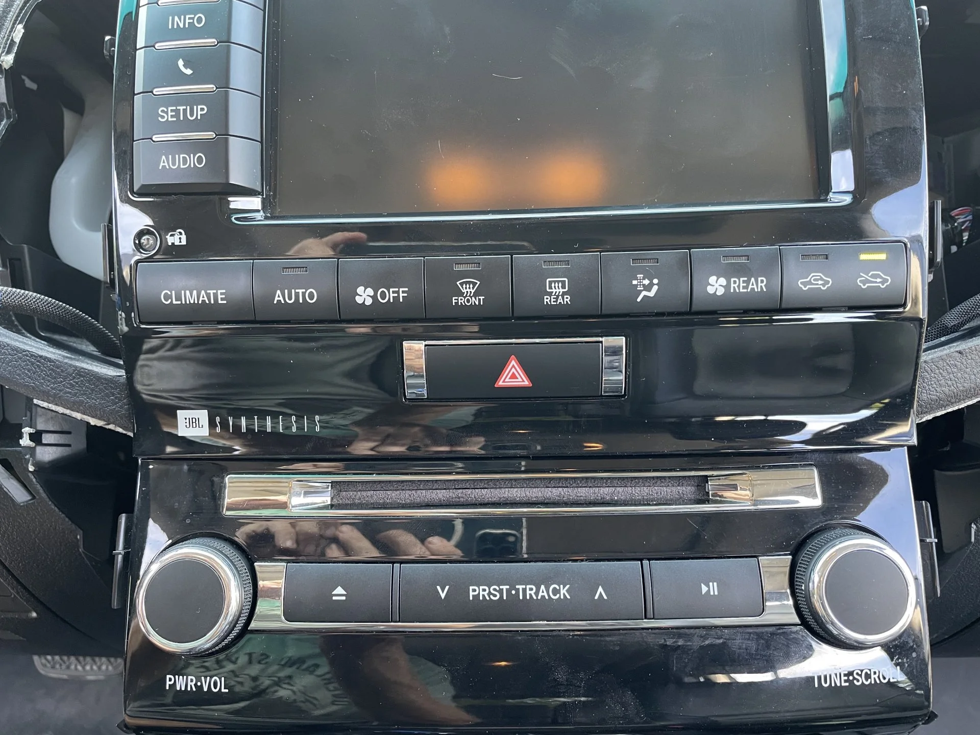

1. is there any feedback or sounds when pressing anywhere on the screen?
2. do all the physical buttons on the navigation screen work?
3. is the screen turning on but is "black lit", or the screen is fully off (you need to try this in the dark)

Nope - wish there was... it would be something. I get nothing.
There are 8 buttons below the display (Climate to recirculation) - and all of them seem to work. If flipping Toyota would have just added a dang AC button there... I'd be good! So dumb this is as reliant on the screen interface.
This is a great question and interesting thing to try - which I'll do in the dark tonight, just so I can be sure.

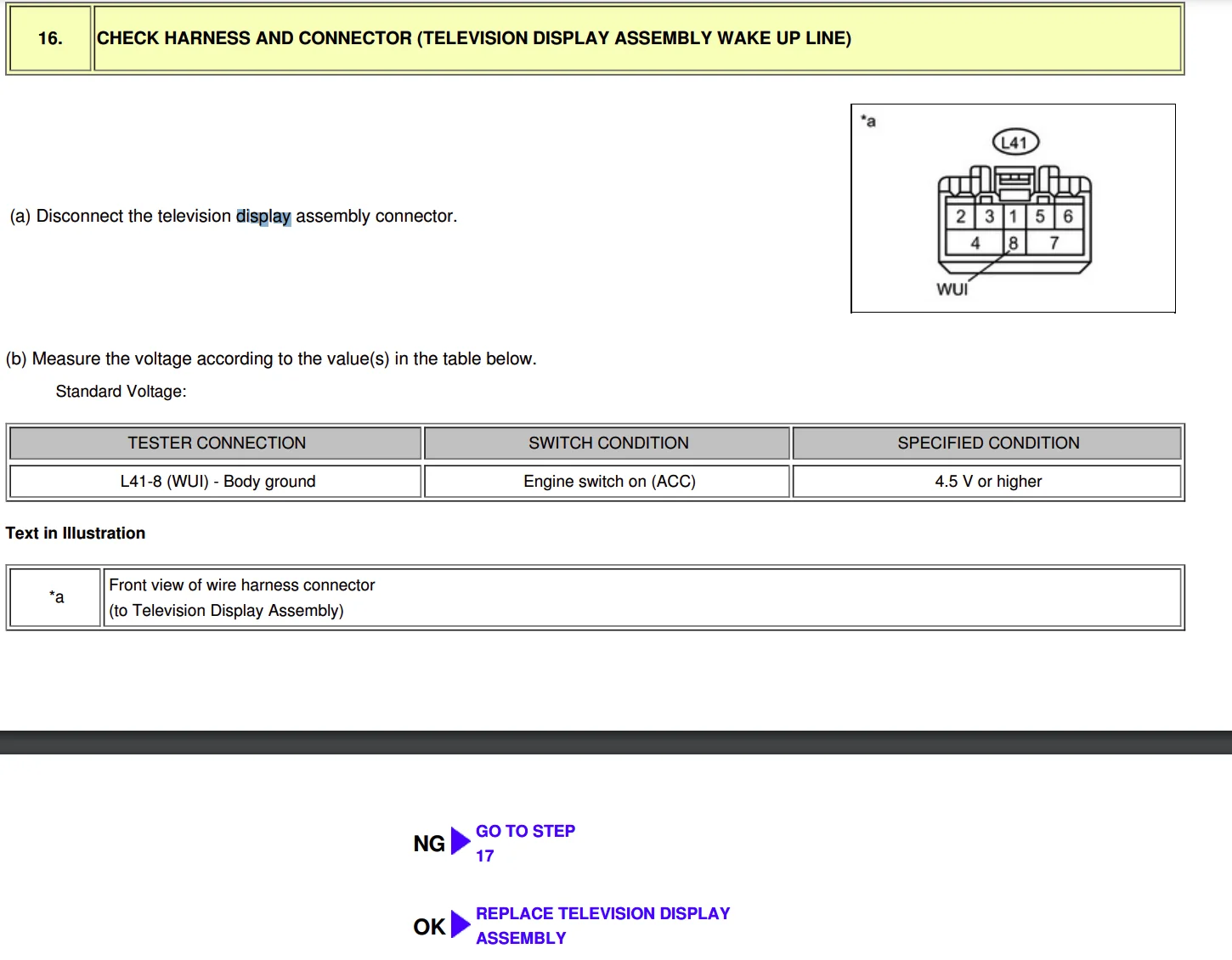

Did you check for DTC codes? The FSM has quite a few related to the display. Could provide information either way if one is registered or not. Did you check the voltage on the wakeup line as detailed above? That is the first step in the troubleshooting guide, and would determine the next steps based on the answer . . .

I apologize for my naivety - DTC code (I had to look that up, diagnostic trouble code) - I don't have a way to pull the code. I'm sure a dealer could, but that's a bit of an adventure that I'll have to do later in the week. Is there another way I could do this myself?
The other bit about the voltage wakeup, etc... I didn't understand.

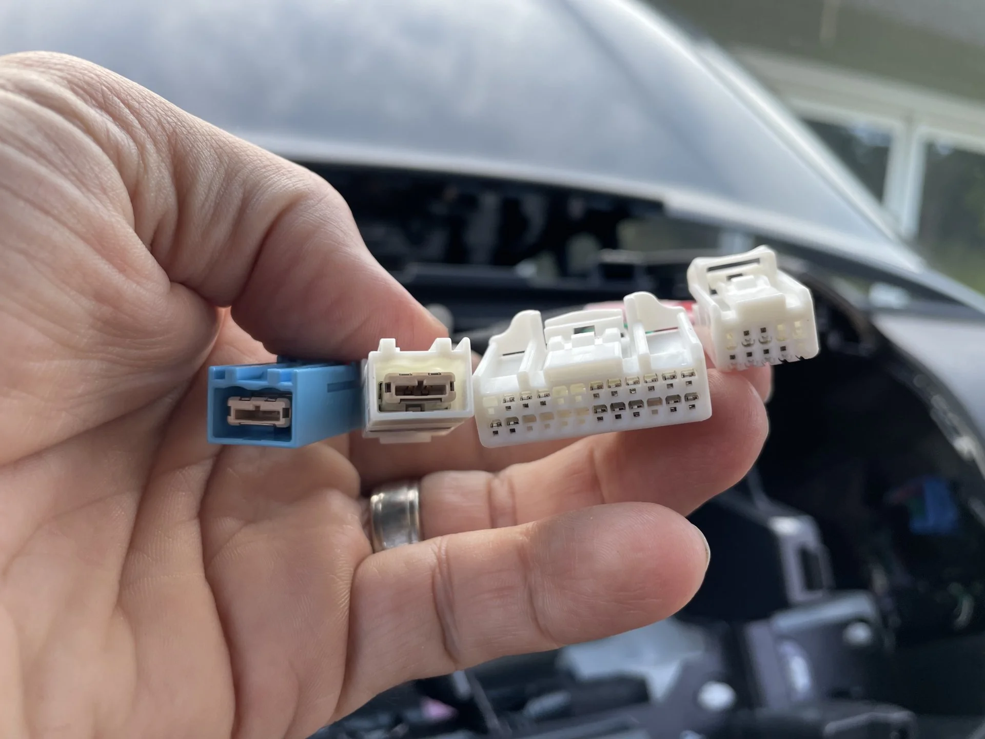

I disconnected the four connectors for the display and upon looking at them, none of them seem to match the graphic you shared. Pictured in this post - are these the connectors you're referring to? Or should I be looking for something else?

None of those plugs look like the FSM plug pictured, which isn't too surprising, There are many regions and models and nav/non nav too. I'll look for one of the two white plugs pictured. I suspect it is the smaller, 10 pin, just need to figure out which pin.
You'll need a voltmeter to test voltage. These are also around $20 at your local walmart, target, hardware, or auto parts store.
