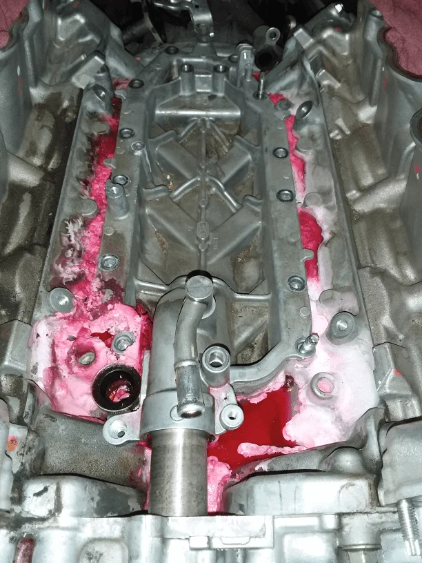

The day after drop off, they sent me this...
Needless to say, there was some work do to. I had them take care of the leak and replace the radiator/hoses/serpentine belt too. My radiator had "the crack" at the top, even though it wasn't leaking from there. Figured I might as well get it done.

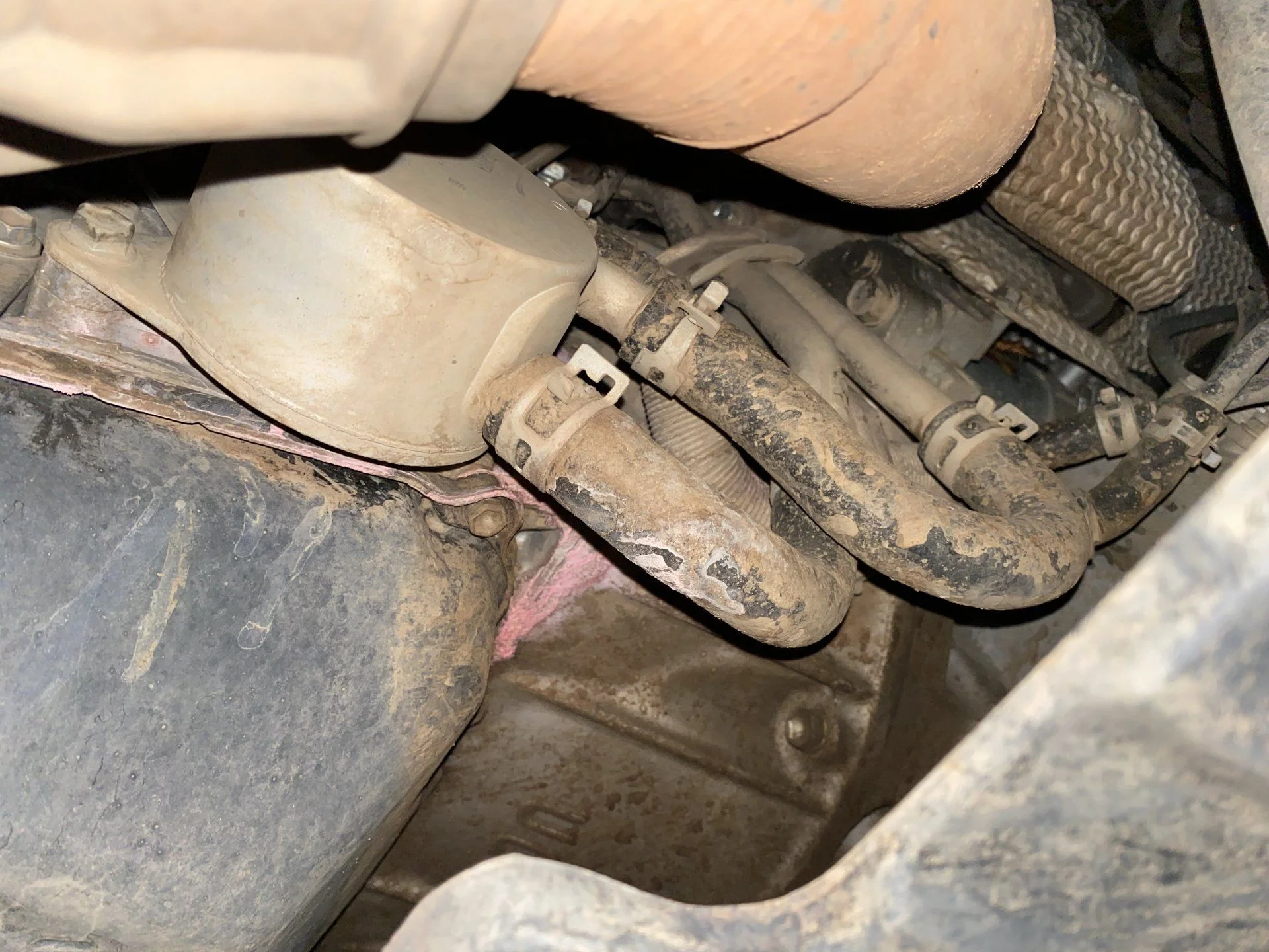

I suspect this is what I just found on my 2013 at 99,820 miles. Was underneath looking for where I could run an air line to the rear, looked up and saw pink just above the rear edge of the factory skid. Thoughts?
This is a common issue with the 1UR-FE 4.6L in the Lexus GX460 as well. I have my fingers crossed that this issue won't impact the later year models but I fear that they are just too new for the issue to have reared its ugly little head in anything newer than 2014 at the moment. It sucks that this issue is such a PITA to repair and slightly costly at that.
