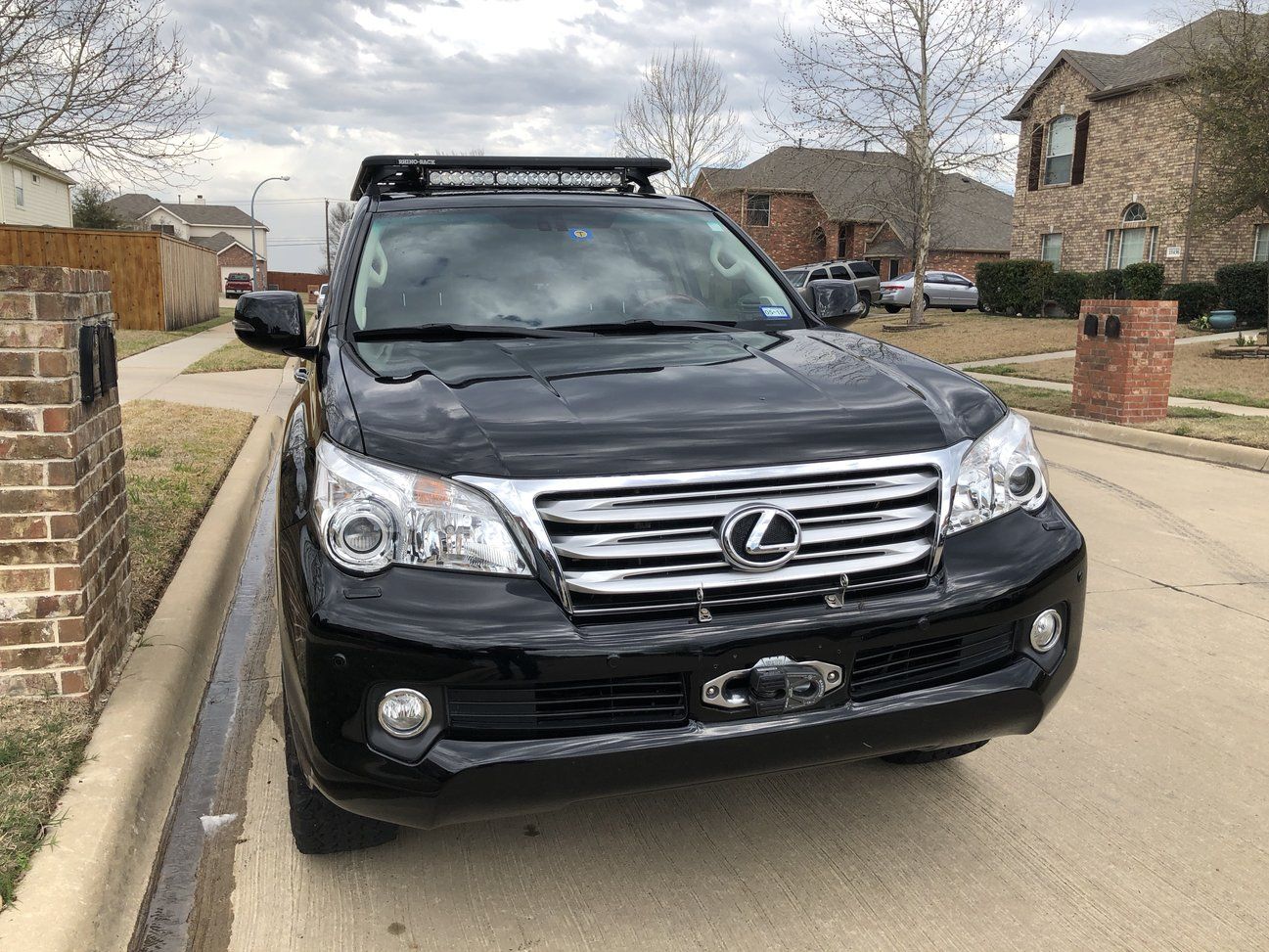

Sounds like recovery is higher on your list too. IF you do wanna run a winch without much visual change, check out this one: LFD Off Road - Adjustable Hidden Winch Mount - GX460
last post cut off - those sliders look great, and it’s nice that they function as a step as well. The one thing that threw me off is that (I think..) they say on their website that theres some drilling / welding needed if you want to use them as full on sliders. I could be wrong, but that’d be a bit of a dealbreaker.
As far as that winch mount - haven’t seen that one before and it looks awesome! May need to give them a call...
