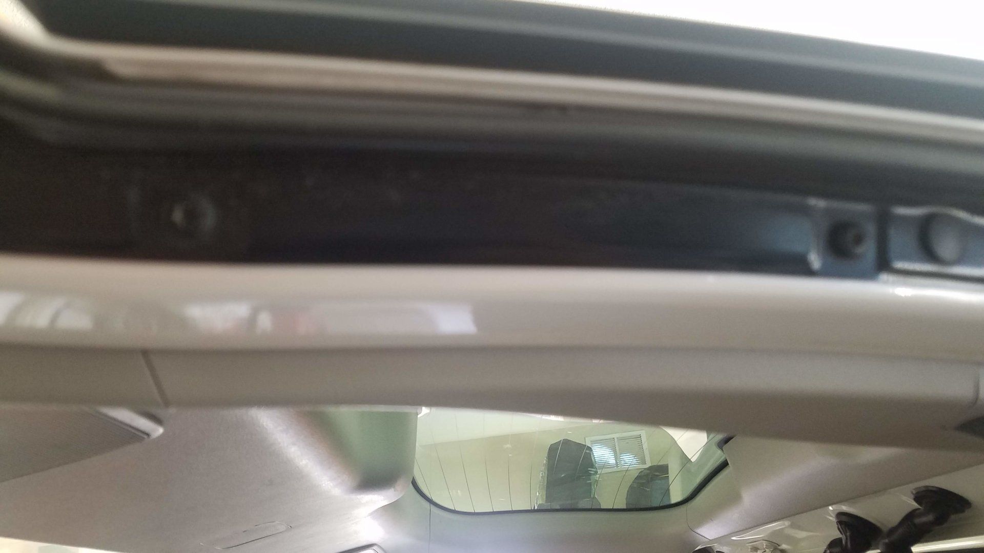

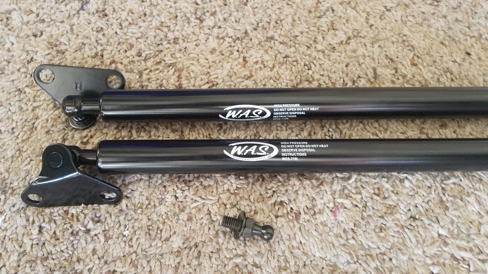

I'm sure it's been covered but again adding to thread for my own prosperity. Today replaced the rear hatch struts. Got THESE from Amazon. Figured could replace them about 8 times and still be at about OEM price. Not difficult if you remove the 3 torx screws to pull out the molding, you can then get a socket on easily.

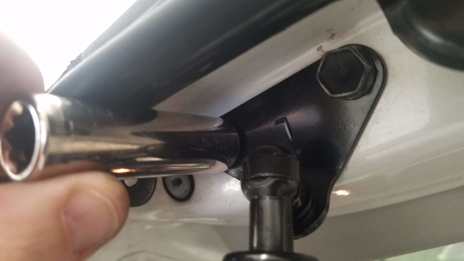

Bolts hit the edge I found if molding isn't loosened. This pic is after loosening and pulled out, just showing how it would hit.

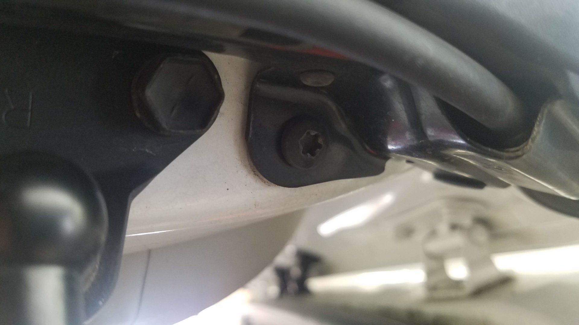

Remove these 3 torx screws, T25 I think it was.

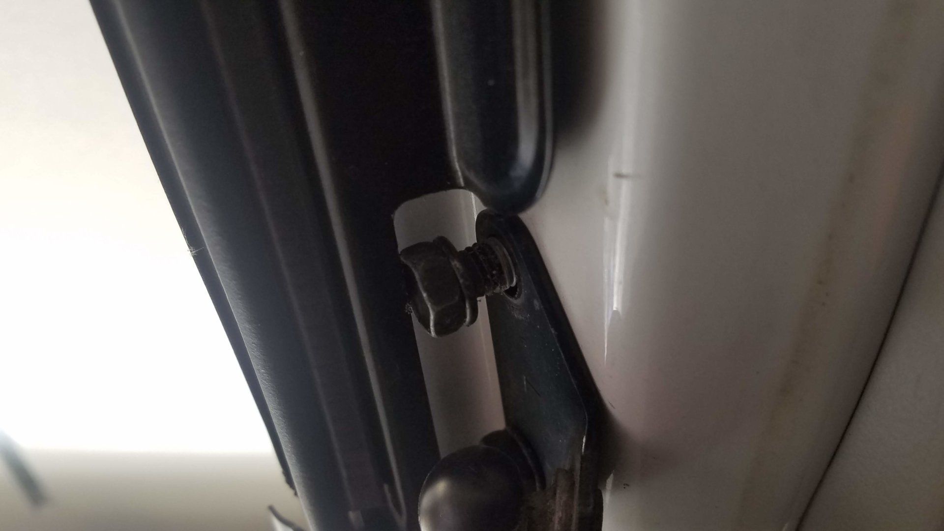

The plastic circular clip to the right breaks. Not sure of its purpose.
I'll keep the covers on for now. Cleaned them up and bought New Clips, again from Amazon.
Thanks for the pic. I've been meaning to do this; I ordered the exact same item and it's sitting in my garage.
I couldn't get the torx screw to loosen no matter how hard I tried.
Did you have to remove the rubber molding first?
Thanks for the pic. I've been meaning to do this; I ordered the exact same item and it's sitting in my garage. I couldn't get the torx screw to loosen no matter how hard I tried.
No mine came loose without problems. They were snug so have a some good leverage with whatever tool you're using. Looks to be all one piece so I don't think the rubber part separates, at any rate that wouldn't affect the torx screws anyway. Try using some penetrating oil and let it sit there for a bit.

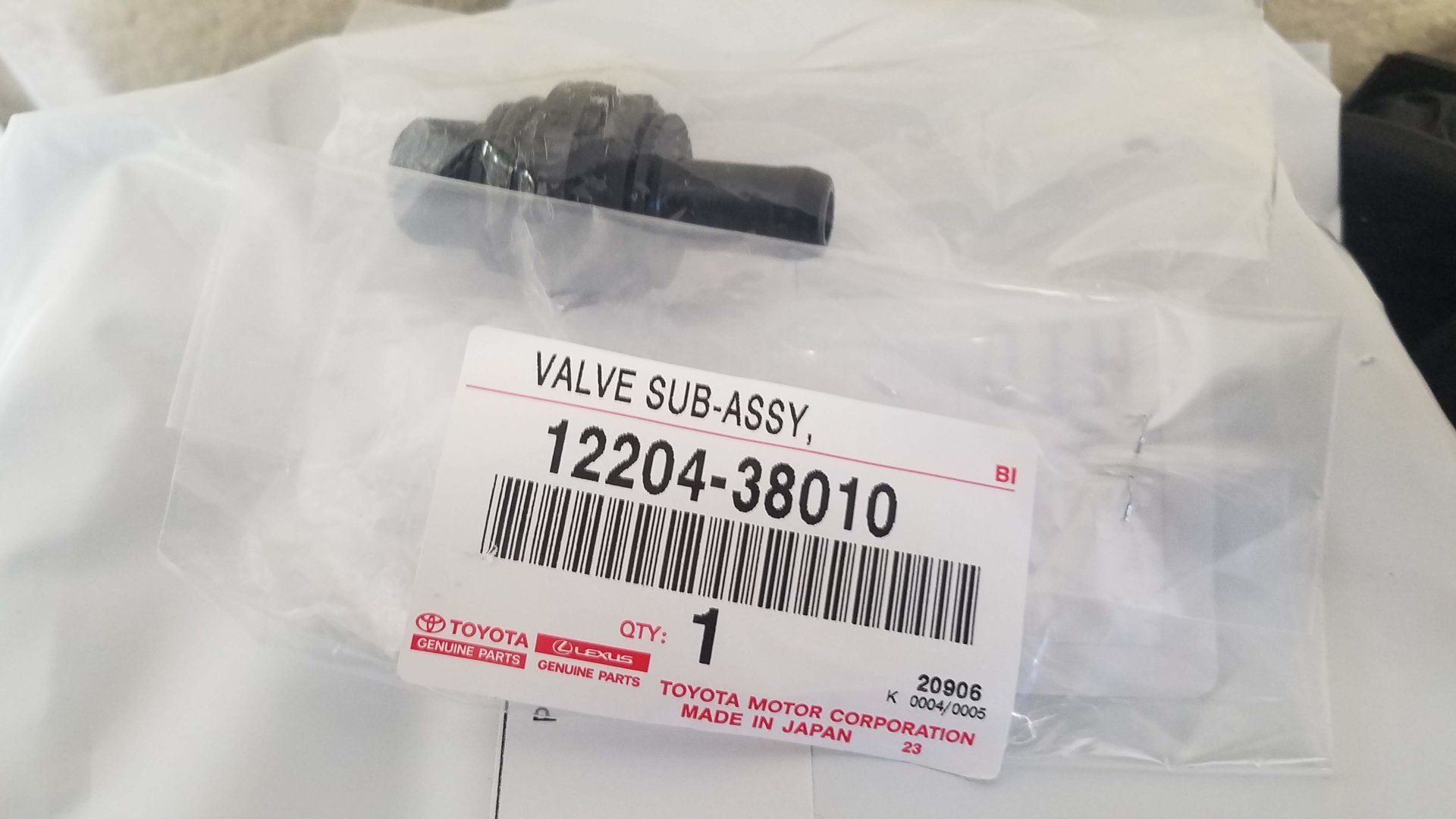

Also replaced PCV valve. A little discrepancy on the part number but both seemed to check out. Original was 12204-30830 but when ordered 30810 also said fit an '09. New one didn't have green.
