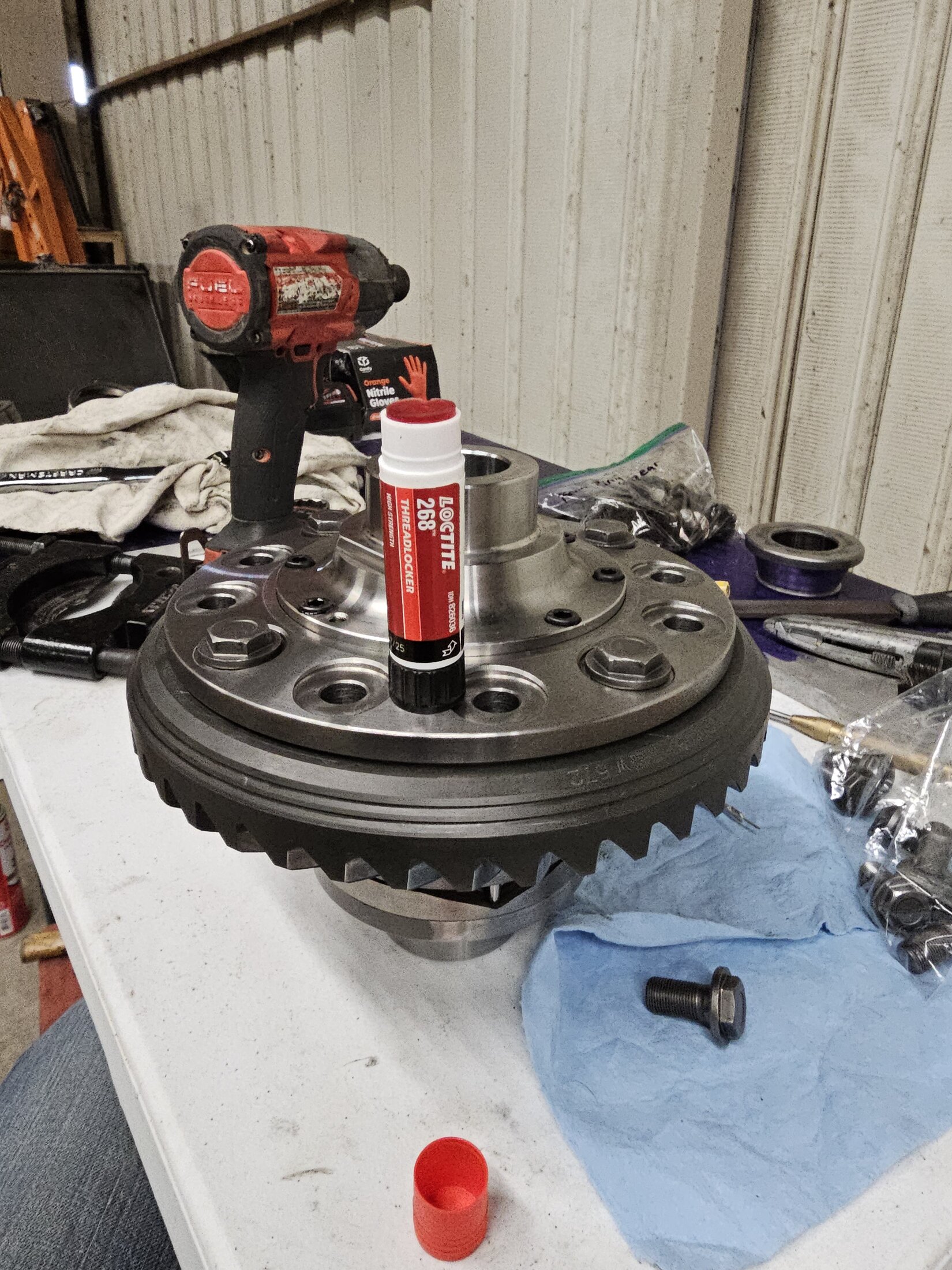

Well, I was up late last night working on the front differential. I started pulling the bearings off of the pinion and installing new ones on the Eaton carrier and pinion.
I got the ring gear on like an angry gorilla since I don't have a way to heat it at the hangar. I ran a fine file over the carrier face and back of the ring gear and cleaned everything up. I set the ring gear down and clamped it with my hands while turning a little at a time. I then started 4 bolts and tightened them finger tight. Then I put a piece of scrap plywood on the ground grabbed the ring gear against the carrier as tight as I could and smacked it straight down onto the plywood. Tightened the bolts finger tight and repeated until it was seated. I finished it off with a dead blow around the circumference to make sure it was down. Then I applied the loctite stick and all of the bolt were rattled on setting 2 of the impact and then torqued to 101 lb-ft.
The inner pinion bearing race was the worst part of the hole operation. I also found while installing the initial shims that toyota managed to order 11 side shims for the rear and no pinions. I should have had 7 side and 4 pinion. I intended on starting with the rear but couldn't.
