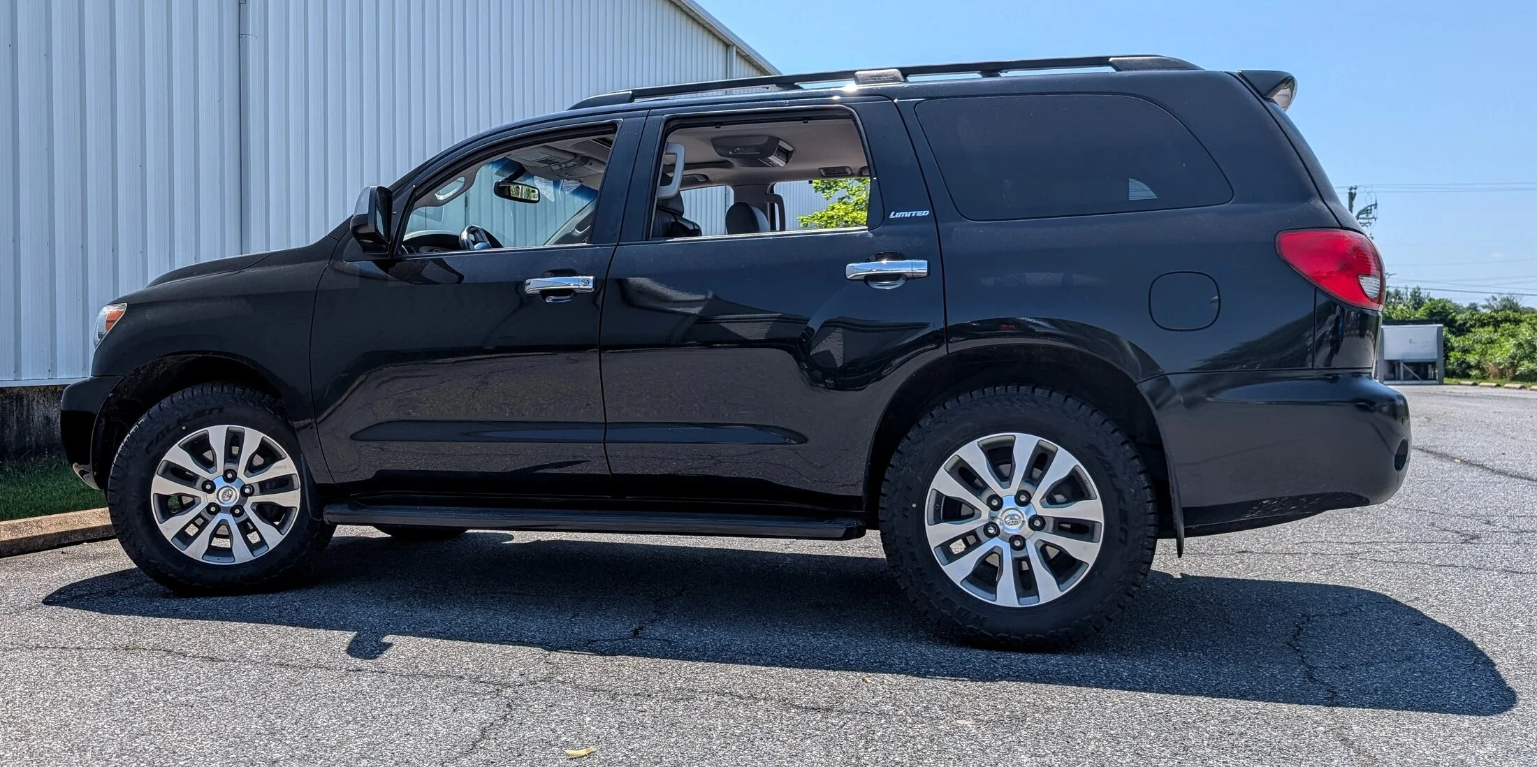

Howdy,
Got a 2017 Sequoia Limited 4x4 with 100k. No rust!
Added Falken Rubitrek 275/65R20s today. Much better ride than the Michelin Defenders that were on it. No rubbing while driving on flat surfaces, but does rub some (mud guard i think?) when there is compression from braking turns and/or uphill turns.
Got an Eibach suspension kit that will lift it 1 to 1.5". Might make the change next week. If the new suspension doesnt solve the rubbing, I might cut some. My idea is that a suspension with 8 years and 100k could use a refresh.
Any questions or advice are welcome. I had a GX460 and loved it, but I'm digging the greater heft of the Sequoia quite a bit.

Yeah that should be a .2" taller and .8-1.0" wider tire. Offical specs on the Rubitrek 275/65R20 are 10.6" w and 34.1" diameter. Tread depth is 18/32". Maybe that does it.

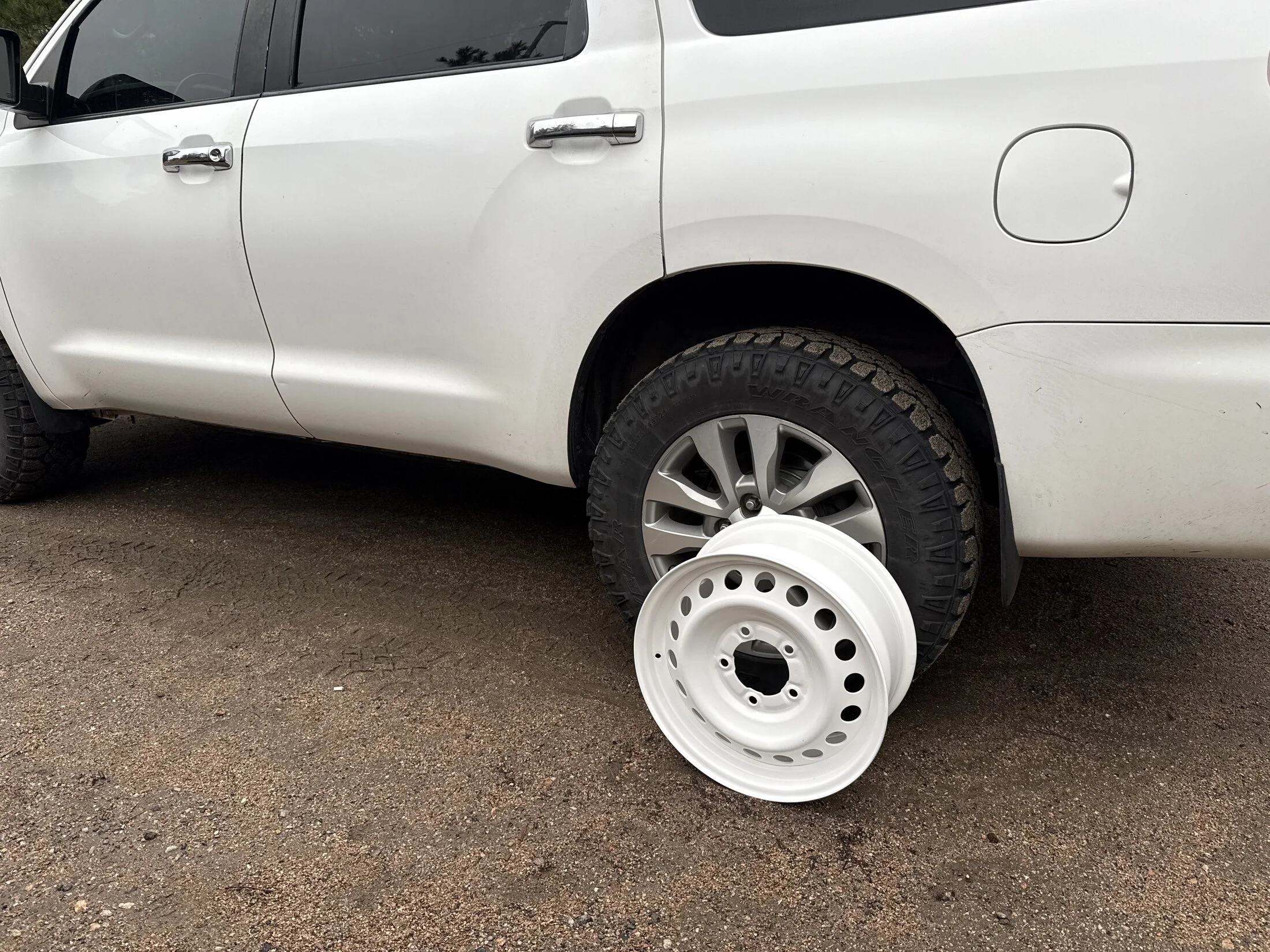

I think I’m going with RCI rock sliders, i already have all their skids. Also doing new tires soon on 18” Tundra steelies.

Looks great, you should be able to just trim the ears of the skid plate about an inch back and fully clear.
