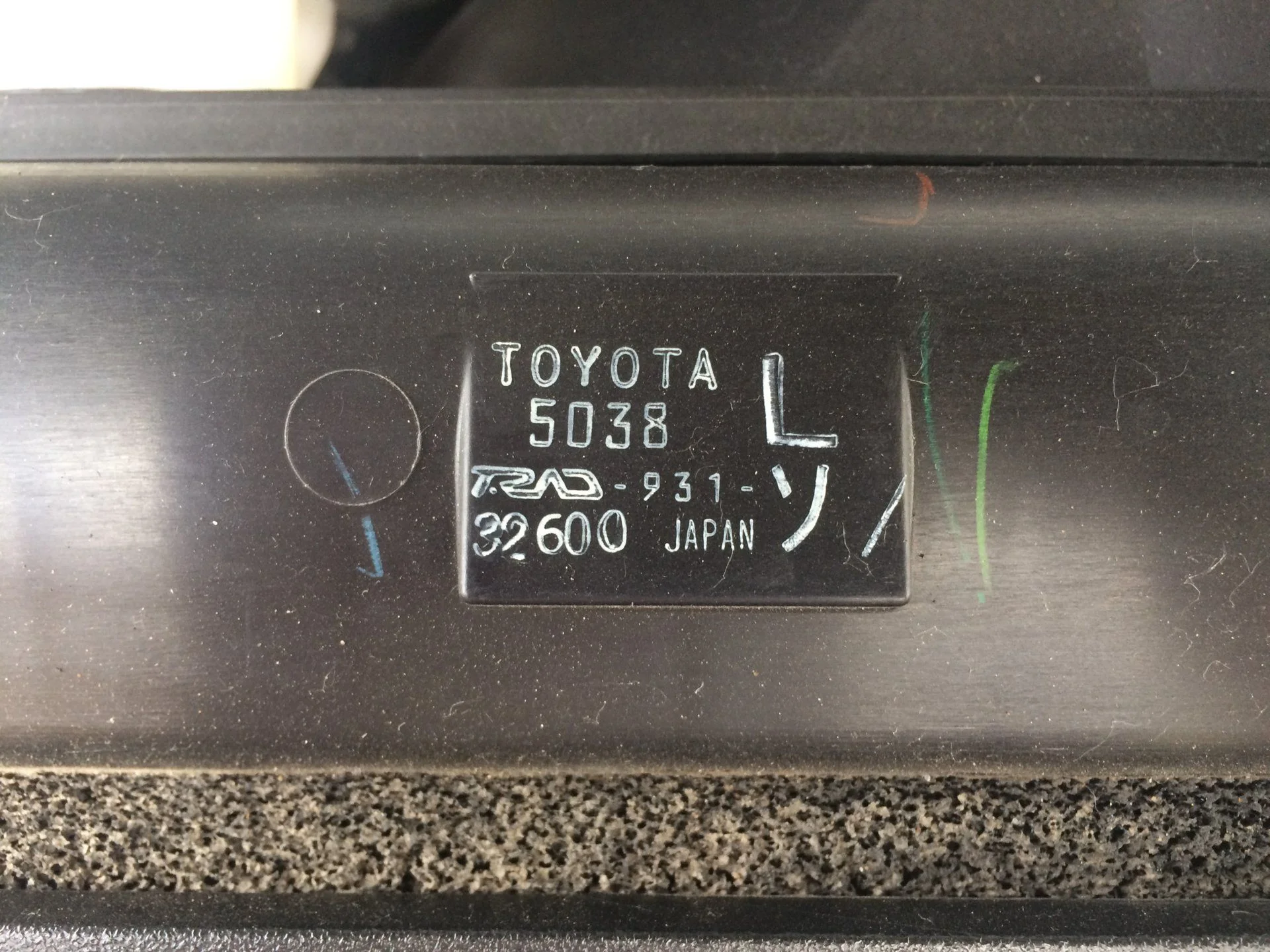

mine finally got the crack. 2008 lx w/ 147K miles. Looking at the radiator it seems to make sense why the crack develops there. as the plastic expands and contracts on its heat cycles, the thicker portion will expand/contract at a different rate and therefore there is a flex point at the base of the square portion where they part number is painted on. this creates a failure point. they need to lose the 'raised square' portion and everything will be fine.

Has anyone correlated lot numbers on the failed parts, assuming that's even possible to determine by the user?
Also, I haven't seen any 2010 model year owners chime in with failures. Mine is a 2010, 140k miles, and as far as I know everything under the hood is original. No sign of crack or leakage of any kind.
I assume the 931-32600 is a lot number or code for manufacture date?

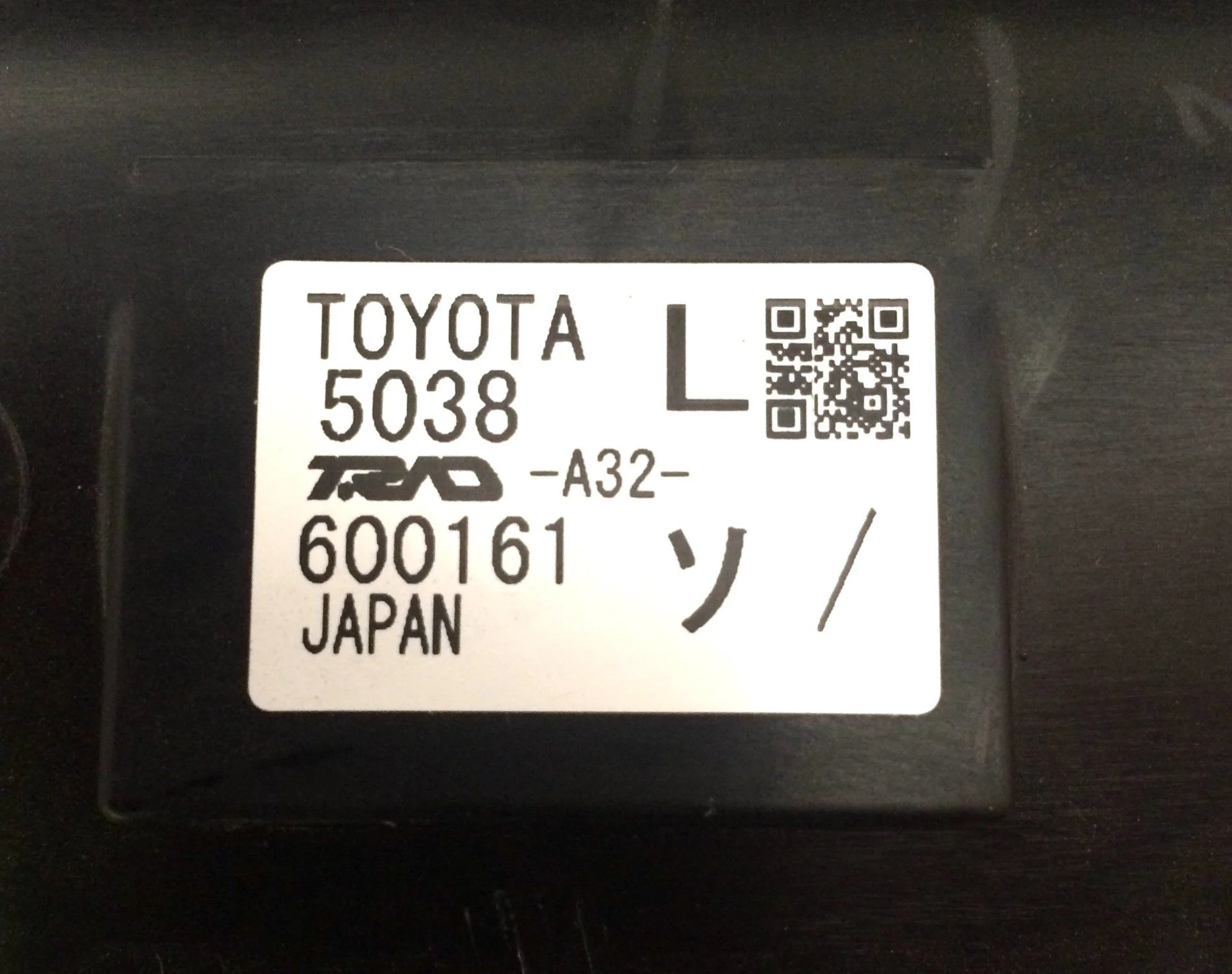

I read with great interest the above thread. Thanks to all who contributed such helpful information. Then I said to myself, "self", surely Toyota got the message on the design of this part on later model 200's. Nonetheless, I had to go out in the garage and pop the hood on my 2017 to see if the top of the radiator had that same raised molded area for what appears to be a part number. Yes there it was, in front of god and everybody! :bang: Now I have no way of knowing if the manufacturer got the message or if structural changes were incorporated but I guess the stupid question of the day is, are owners of later models going to have to deal with this too. It maybe just a rhetorical question at this point and I owe it to myself to do a little further research but it sure came as a surprise.
