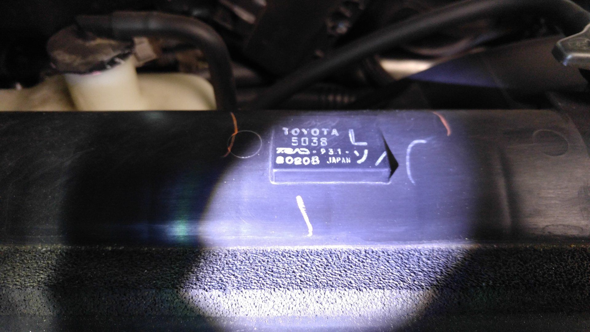

2008 with 90K miles.
No failure yet, the white line at the lower edge of the part number boss is sign of weakening plastic and immenent failure.
Surprised to see an 08 with only 90k on it. Even more surprised to see the radiator failing with those low miles (low for a cruiser anyway)
I see now, thanks. Now I'm paranoid as I'm currently monitoring my 09 LX's coolant levels.
That's the spot. Keep an eye on that lower line, if it starts to turn lighter or if you see a hairline crack forming , change it out. Not too expensive and can be done in the driveway.
Looking through this thread, I'm thinking the posted results indicate that the failures are much more closely related to age than miles. To me, it makes sense that age and heat cycles would be more of a factor(s) than miles.
That photo above maximizes the appearance of the current "crack" that's developing. I wiped it down to remove the dust, and the light highlights the dust that is deposited in the crack/joint. For example, there is zero crack at the side joint, yet the dust makes it look like there is. I have other photos where you pretty much can't see any crack at the bottom joint. I'm going to keep an eye on it, probably replace it in another year or so, or sometime when I feel like it. Or, sometime sooner, after the wrecker tows me home after it blows. :D
You may want to go ahead and order the newest updated LX570/LC200 replacement from Toyota or Lexus and keep on hand, because it seems very, very likely you will need to replace it. Why not have it on hand and do it when you have the time. The best part about not paying robber baron prices for an original '08 radiator is that the updated ones, like I bought last summer, still have the raised number boss, but it sticks up less and is smaller. It should be less prone to cracking there, but who knows? It just looks less sketchy than the '08 design does to me.

It occurs to me that one could proactively strengthen that stress point with a fillet of something like JBWeld (specifically PlasticWeld Epoxy Putty). It could potentially repair a leaking seam. But for a radiator that is still stable and intact, it might completely head off any potential failure indefinitely.
I've just talked myself into this. Going to do it. No harm or foul if it doesn't work.
Brainstorming...
Tried that first on my old radiator when it was merely seeping a few drops a day.....did not last. A week later the seeping was back, so I went ahead and ordered a radiator. But, like you said, if it is not yet leaking, it may work. Why not try it? I even tried plastic welding on mine but it was too late. These tanks should be metal in my opinion, but I am old school.
I'm planning to do that. I was going to do some research to see if either the OEM radiator or the Denso model might be any less prone to the crack, but it sounds like you may have already researched it, or at least learned that the OEM has been revised in the crack-prone area. I'm a fan of Denso parts and inclined to go with their version, all else being equal, but if the OEM has a unique upgrade I'd pay a few more bucks for that one...
Yeah, it's probably much trickier once it leaks as the coolant is under pressure. The corner there is a stress riser that fatigues over time with the heating and cooling cycles. I'm thinking a fillet of material will reduce the concentrated forces at the stress riser to prevent fatigue and failure over time.

So my 2011 LX570 with 101,000 miles has the hairline crack of doom starting to show at the usual place. I'm gonna try to do a high temp, for plastic epoxy patch with a sheet of fiberglass or kevlar, etc. to reinforce it before it starts to leak. I'll let you all know how it goes.

I'm not sure this isn't actually the best place for your radiator to fail. If you make it too stout there, might it fail someplace else and be much more catastrophic?
