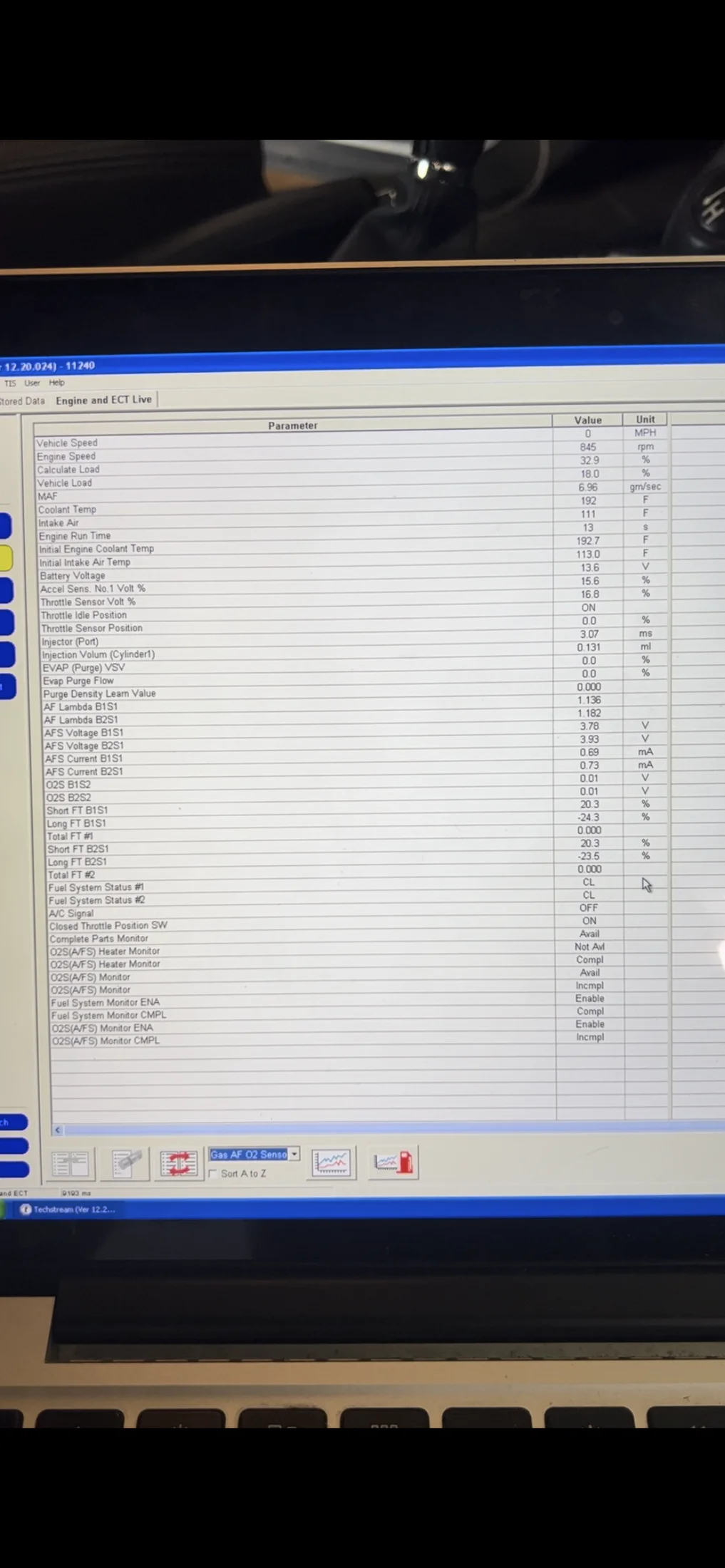

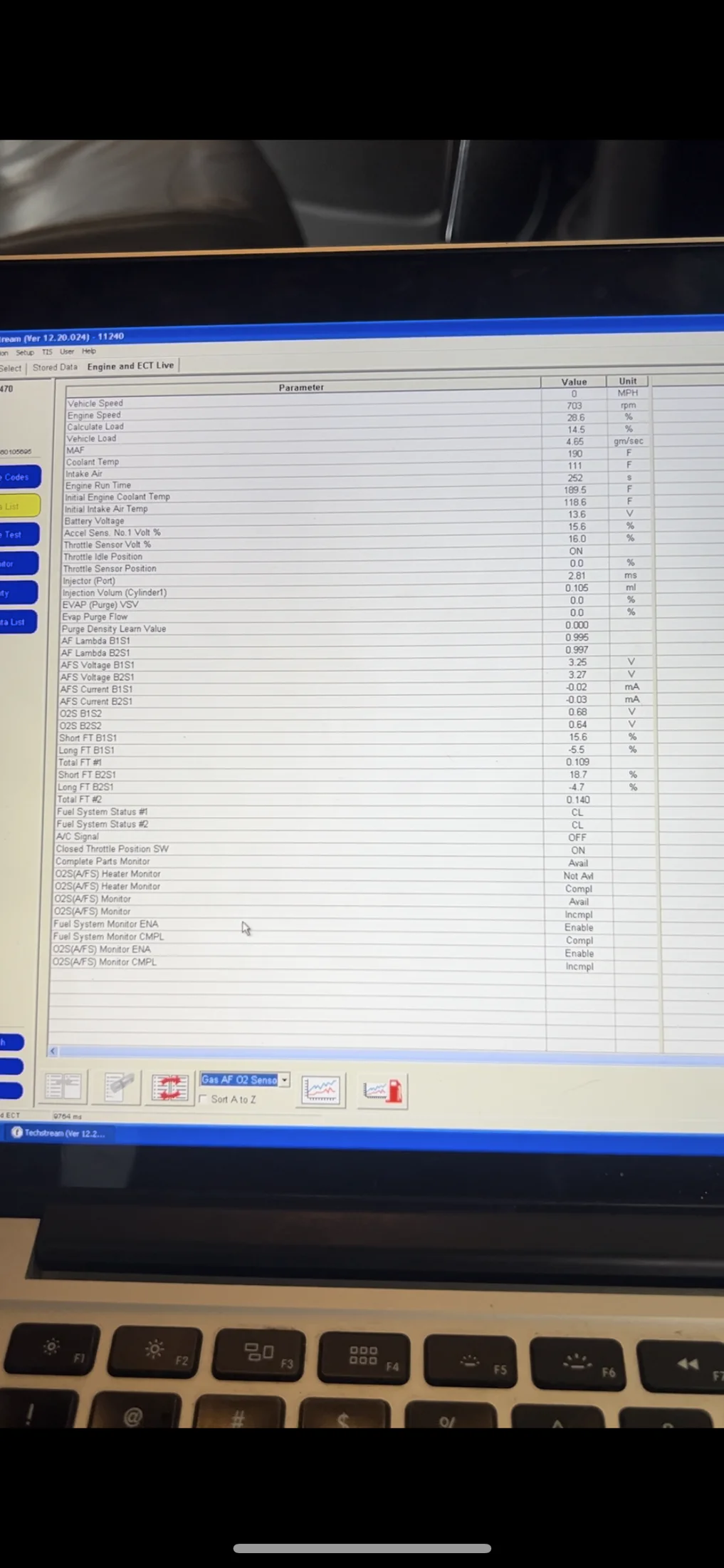

Unplugging and replugging the MAF whether through the Hewitt bypass or direct, sometimes made it run okay. But not consistently. Sometimes MAF reads around 10g/s other times it reads 5g/s. Honestly not sure what to look at next. Will post the data here in a bit.
Mine had very similar behavior. At idle (no AC on) it should read around 4 to 4.8 g/sec. If it is jumping all over the place it's likely you have a problem with the MAF or the MAF connector.
The two data sets above are like 1 minute apart and all I did was disconnect and reconnect the MAF. I can’t replicate it every time. And sometimes while it’s running rich it’ll start to run normal and vice versa. Very odd.
I'm pretty sure that's a MAF issue., If you notice on the first screen shot, you are at idle and a MAF reading of 4.7 g/sec, which is very normal and within spec. Your combined fuel trims are about +15%, which indicates the computer is having to add fuel to reach the designated air fuel ratio.
On the 2nd screen shot, your MAF reading then jumps to 6.9 g/sec, which is nearly 50% higher despite a 100 or so RPM increase. Your combined fuel trims then go to around -3%, indicating that the computer is having to pull fuel to reach the designated air fuel ratio. This is probably happening due to the MAF reading more air that is actually coming in - so the computer thinks is needs more fuel - but the O2 sensors then tell it to back off the fuel.
Either way, you have some really weird fuel trims going on. Long-terms are around -5% in the first one and -20% in the second one, which indicates your computer is always having to pull fuel. They should be pretty close to zero. I'm not sure if that is related to your MAF issue or something else causing it to run very rich (like a fuel injector).
I'd suggest adding the new MAF connector, re-setting the ECM learned values (either via Techstream, if it can do that, or by unplugging the battery for 10-15 minutes), and seeing how it runs. If it's still running super-rich with those negative fuel trims, you probably have another problem causing that - whether an injector or something else.

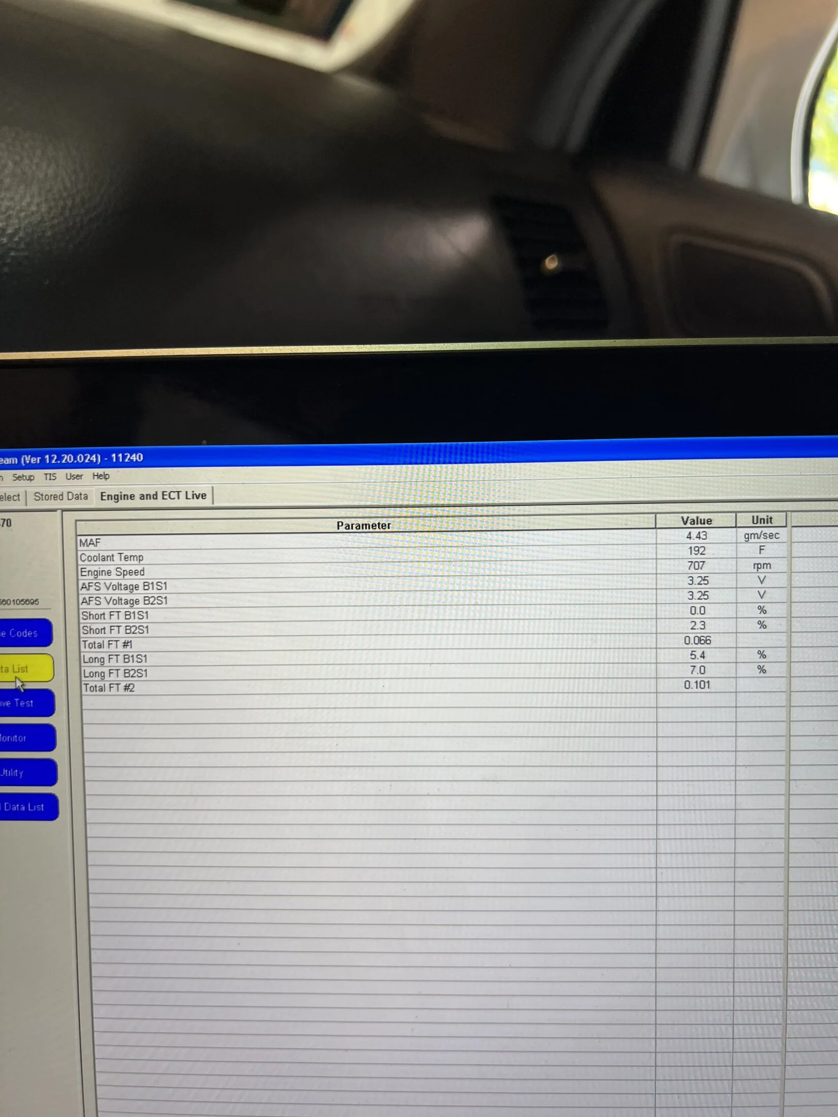

New MAF connector installed. Also really cleaned up the air box. Noticed the air filter gasket was pinched. Idk if enough to affect anything but did my best to spruce it up and may grab a new filter. Truck is running and driving great now. Although, I’ve only idled it for maybe 15 mins and did a 15 min drive. But MAF numbers look good and it doesn’t have any weird shifting behavior. Will post a screen grab of the numbers I’m seeing now shortly.
