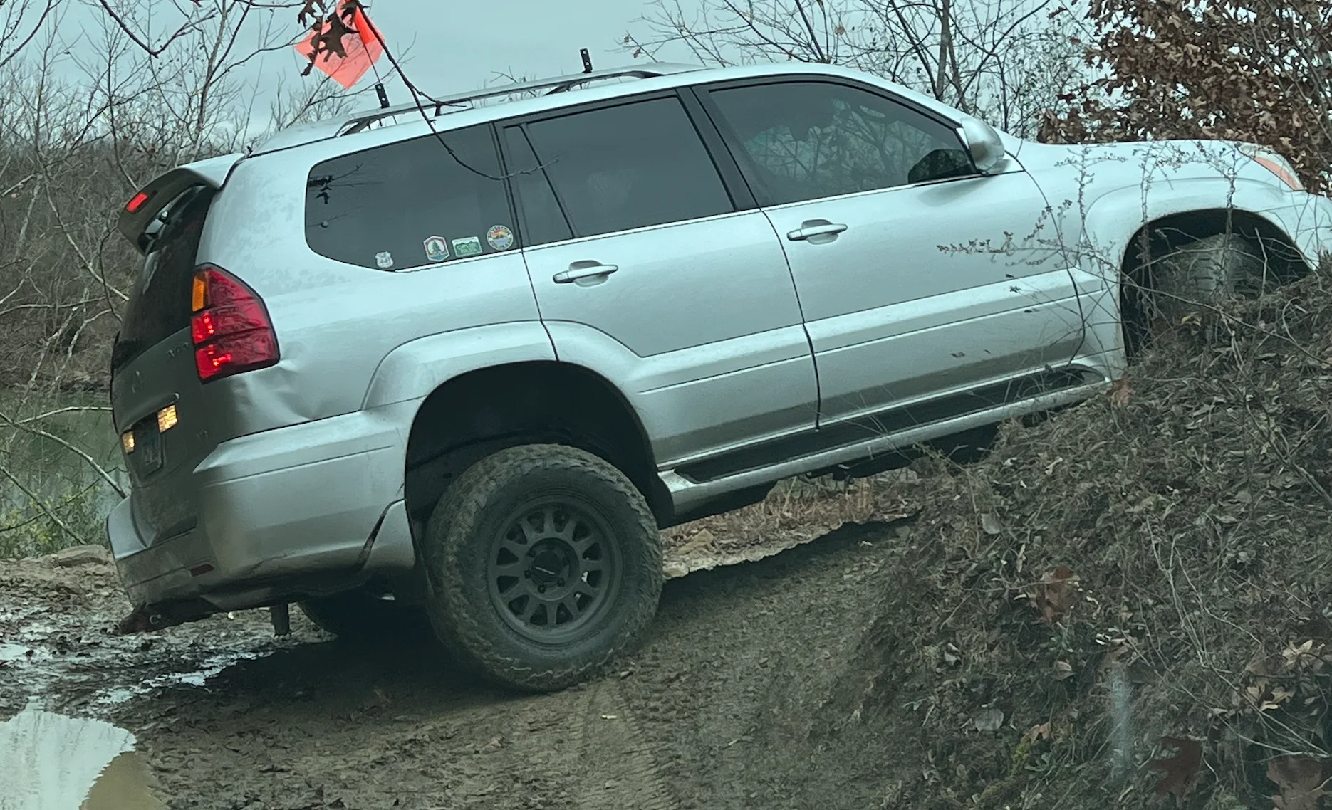

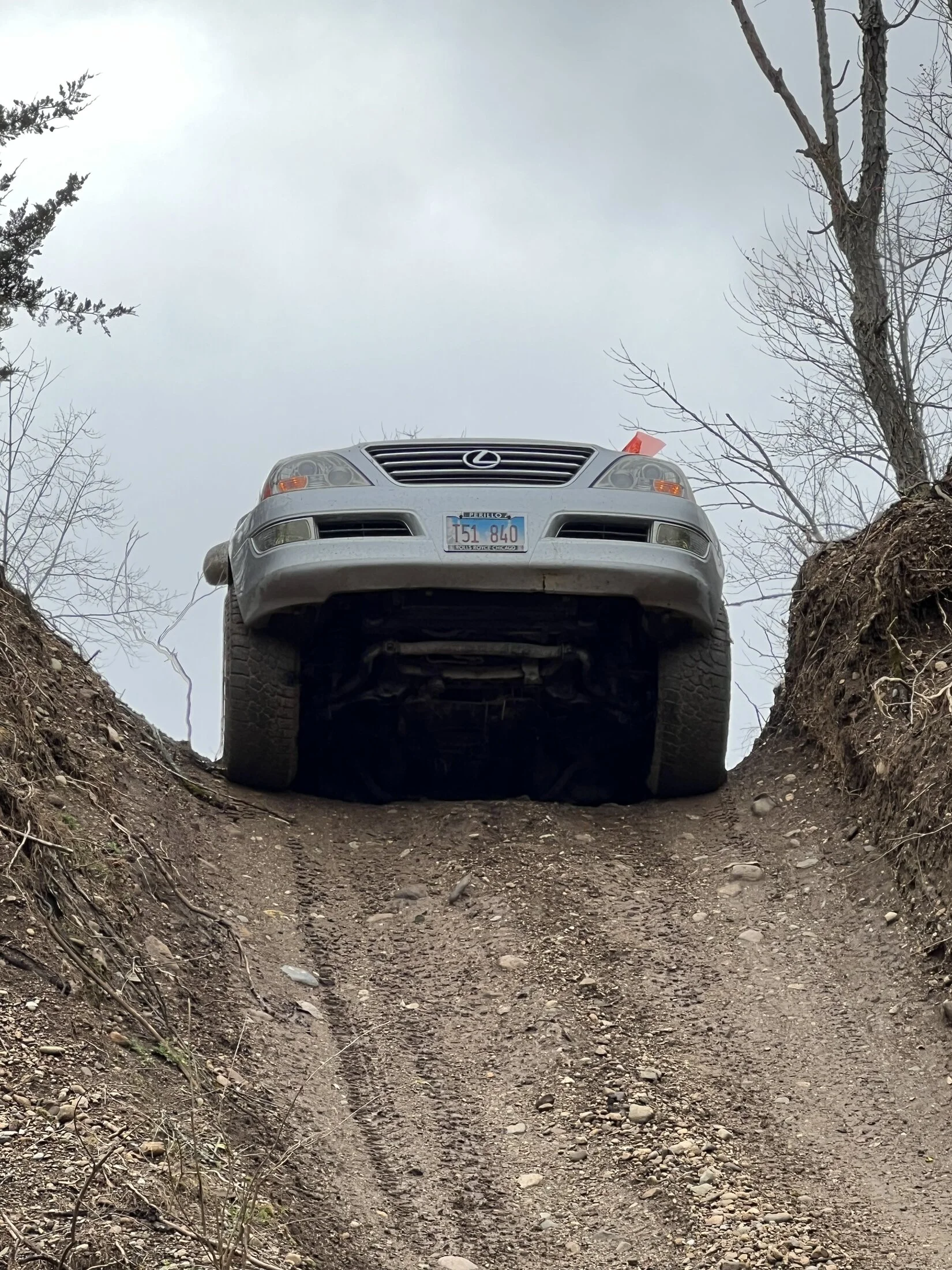

First off road park adventure went sort of predictably. Need sliders ASAP. Maybe some better skids as well. Tires didn't do so hot either at their current stage of wear. But man what a BLAST lol

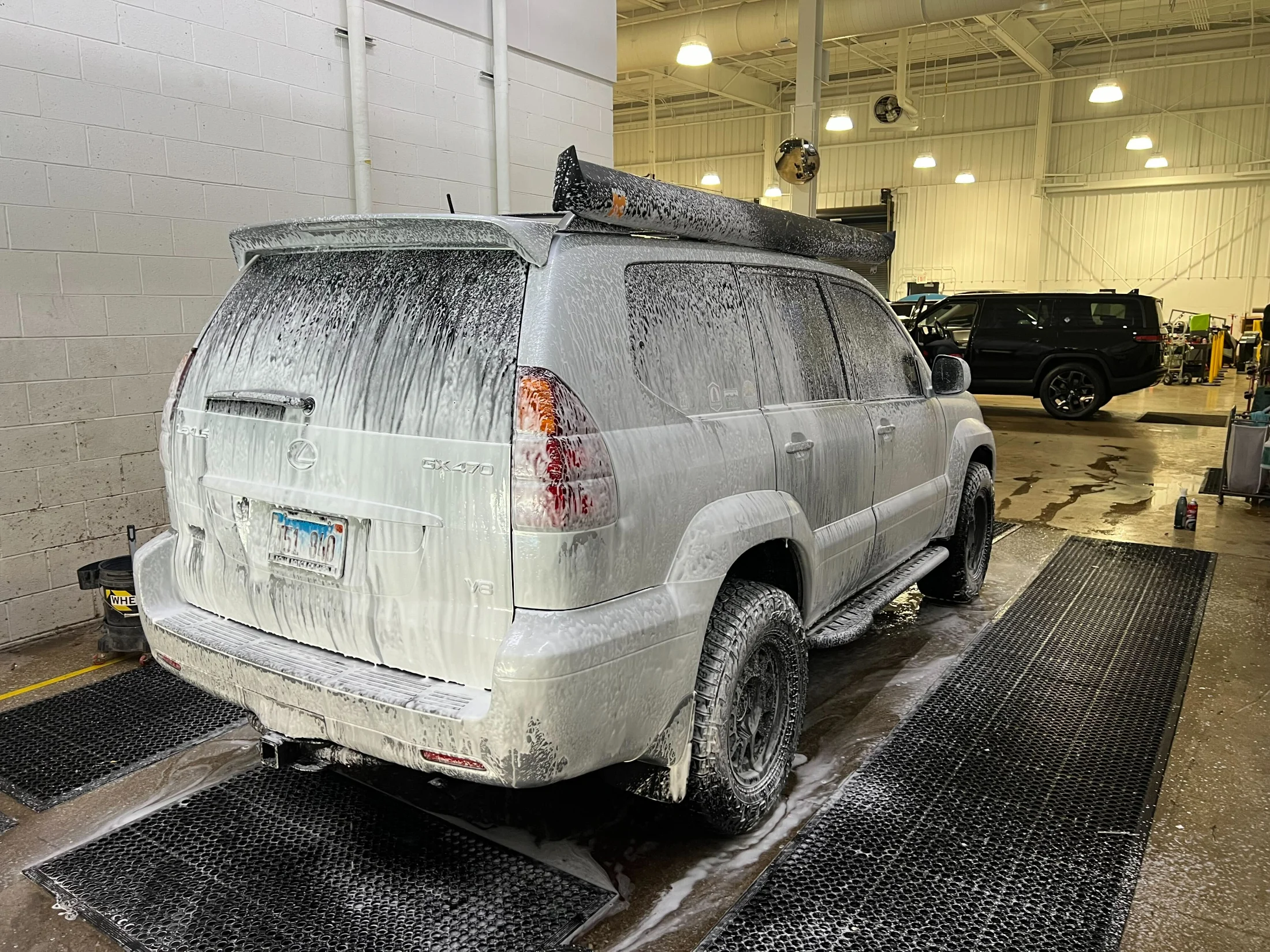

Not much going on so far this year! The ESh got rear ended and is in the body shop now. I spent probably 2 hours power washing the bottom of the truck on Saturday to prepare it for undercoat. I got a wool wax undercoating kit with their spray gun. First victim and the learner was my wife's 2011 Honda Fit. It works REALLY well. Excited to do the GX.

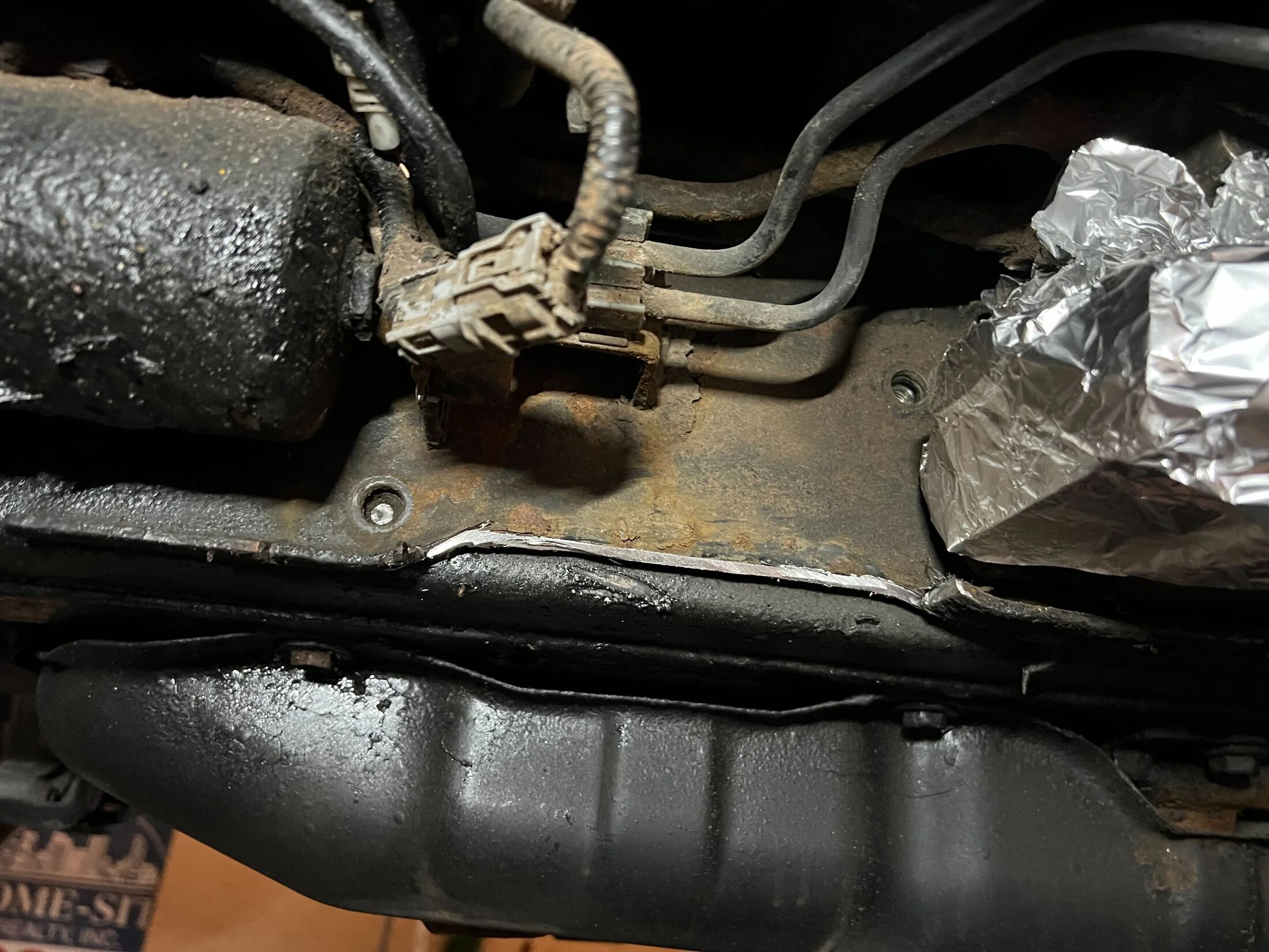

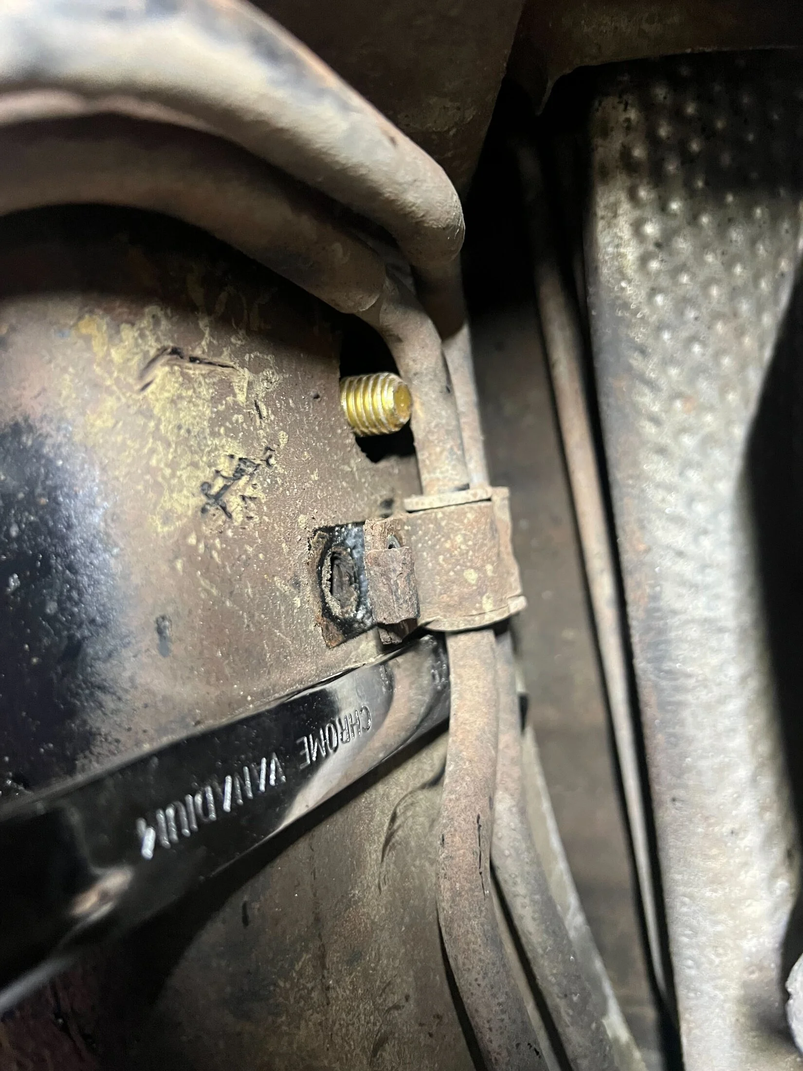

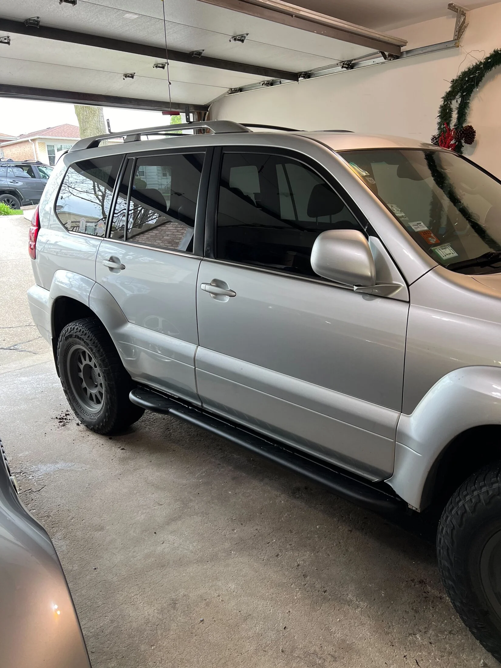

Ordered on some JW Off Road sliders for the ole gal. It's also due for both inner and outer tie rods, valve cover gaskets, and power steering lines are seeping. It undercoated most of it. All fun and games until you need to install some sliders. The passenger side was a 40 minute job. I have some 6-7 hours into the driver side... One broken bolt. A lot of KDSS line bending, which is a****** puckering for sure. I had to cut some brackets and probably will need to cut some more. In the end, I can get these hung with 4/7 bolts, but I think my friend will be welding these on as a forever amen. The combination of rusty bolts, rusty lines, poor fitment, heavy sliders, bending lines, and everything being covered in Woolwax, SUCKS. I've got no hate towards JW, as I'm pretty sure there are 2 different KDSS systems for the 470 and it's hard to know where they might change over.

Driver side slider got welded on. It's honestly a mid quality job and I'm not sure I feel good about putting a lot of weight on it. The center leg should have been recessed back a little bit to allow for the bracket the KDSS system sits on. As a result, the slider isn't making full contact to the frame with the rear most leg. Anyways, got it all boogered up and the future plan is to cut out that middle leg and weld everything back up. I've taken a MIG1 course at a local welding shop to me and am taking MIG2 tomorrow. Will be on the look out for cheap welders after that. Still want to try and save my rusty Bonneville. It'll be good practice for when the GX needs some frame patch work. Specifically by the AC drain up front.
