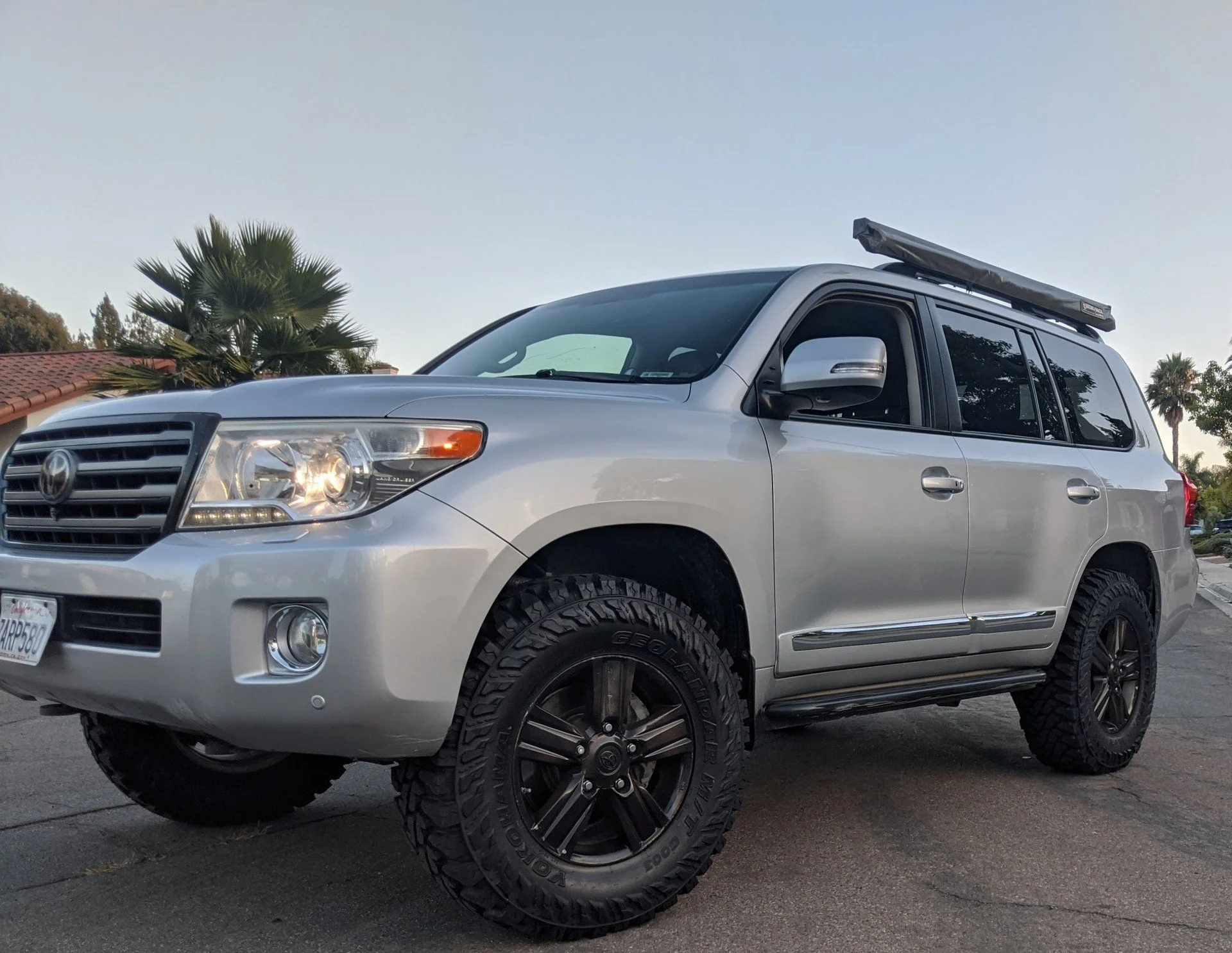

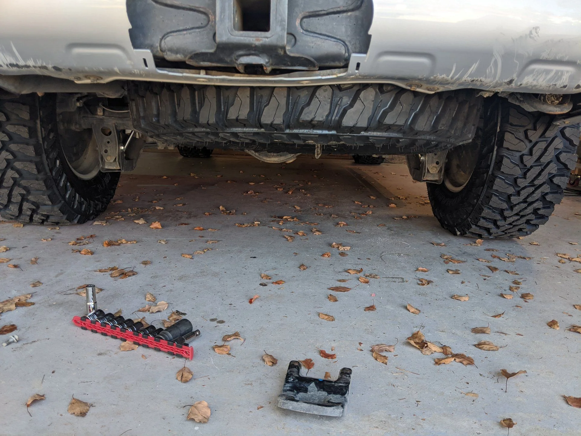

Installed 295/70/18 Yokohama G003s. Keep in mind I have Tundra front end conversion, and aftermarket UCAs. Had to trim the front mud flaps, and then push the front fender liner forward and reattached using the existing s-clip. After that though, zero rubbing on street driving. We'll see what happens this weekend when I get off-road. Measured the mounted height and it came to ~33.75" give or take. In order to fit the 5th as a spare I removed the rear bracket by the pan hard and the thing barely fit.

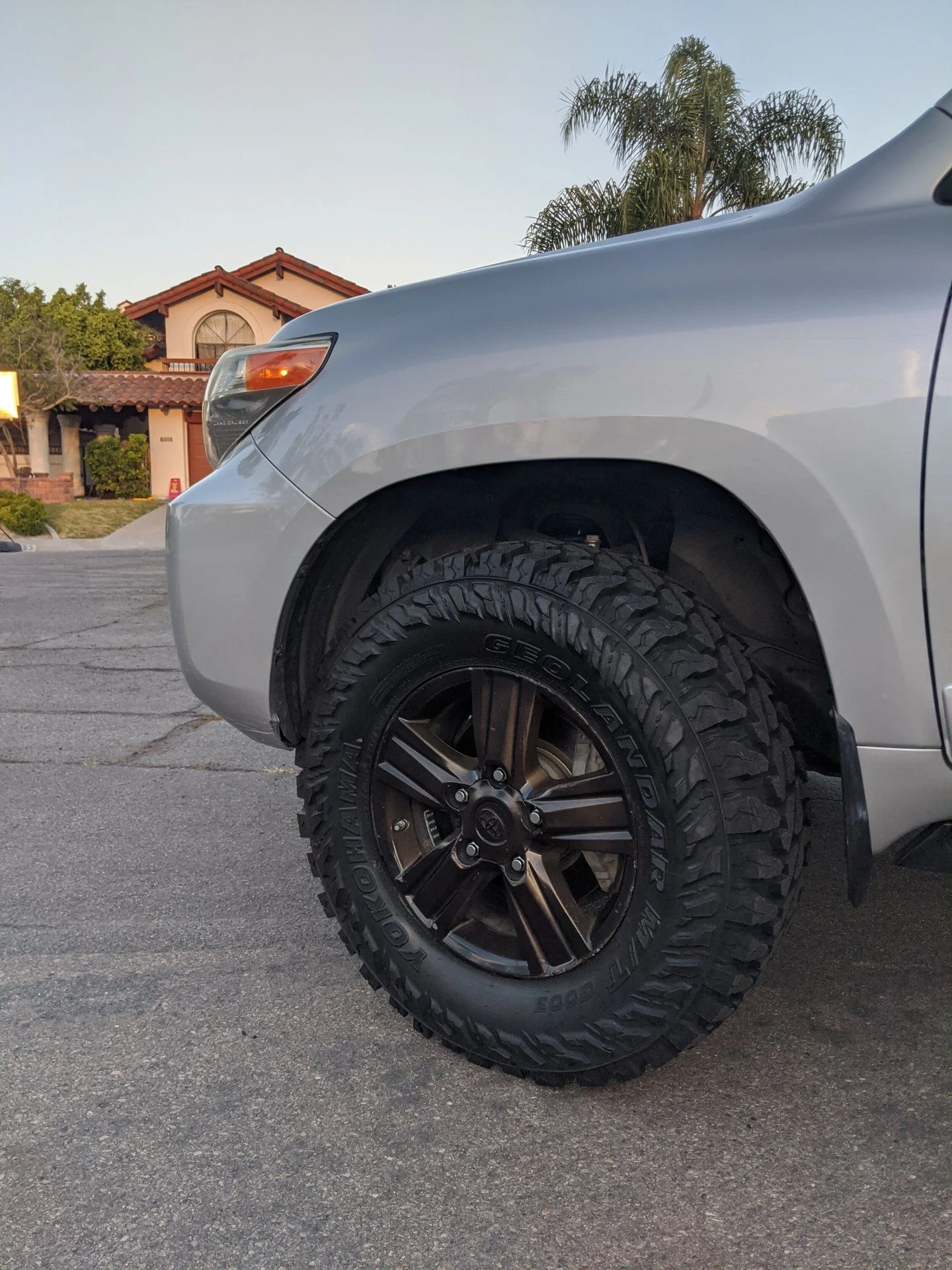

Figured I post these here too ... tires went on yesterday.
275/70/18 BFG's. Only slight rub [in front] in reverse at a full lock. Planning on either spacers or lift which will take that away. Running 40-41psi and it's been very quiet at low speeds, up to 50mph. I'm sure I'll hear a little something more at 60mph+ ... but so far so good.
