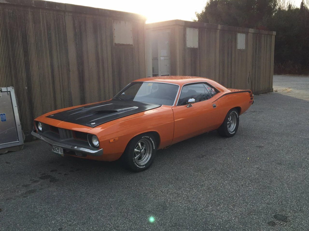

here is a picture of it now....dont mind the Cuda.:flipoff2:

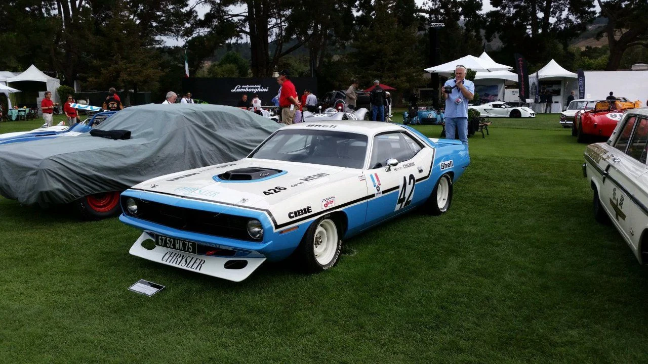

that cuda is down the street from me. It's the only Cuda to be badged Chrysler and the only cuda to be on the Chrysler racing circuit. It's won more races than any car ever. found in a barn in France and owned by gipsies
Edit: sorry, hijack of my own thread over

Sorry, I noticed the Cuda right away and then the Cragars...Oh wow!
