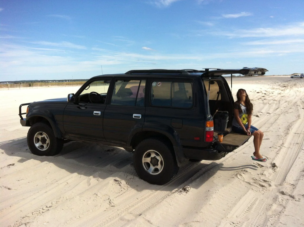

My 80 has a 2" OME

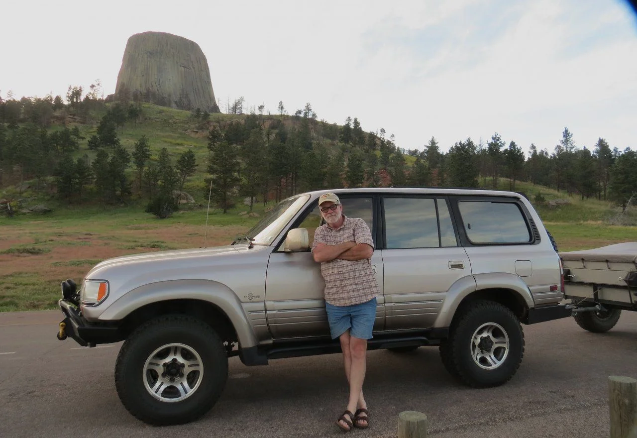

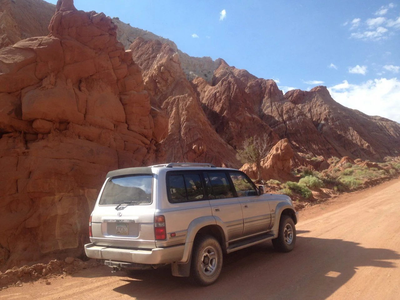

What Duiser said. I also run 285's. Did just Rancho 9000 shocks first. Improvement noted. Then replaced OEM springs with stock height OME. More improvement. Eventually put front/rear bumpers on, winch, tire carrier, roof rack, yada, yada, yada and did the OME 2-3" lift. It's perfect for the expedition type driving I typically do and wish I'd done it in the first place. That's not saying that I wouldn't kill for a 4" lift running some of the trails in Moab!

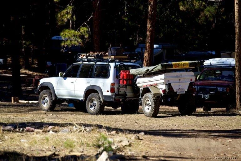

Here's mine very weigted down with trailer, wood on roof rack, etc. I do also run Airlift airbags in the rear coil springs to help with the load in addition to the OME heavy springs. Pic is a little deceiving on rear drop. Cruiser is at a slight downhill.

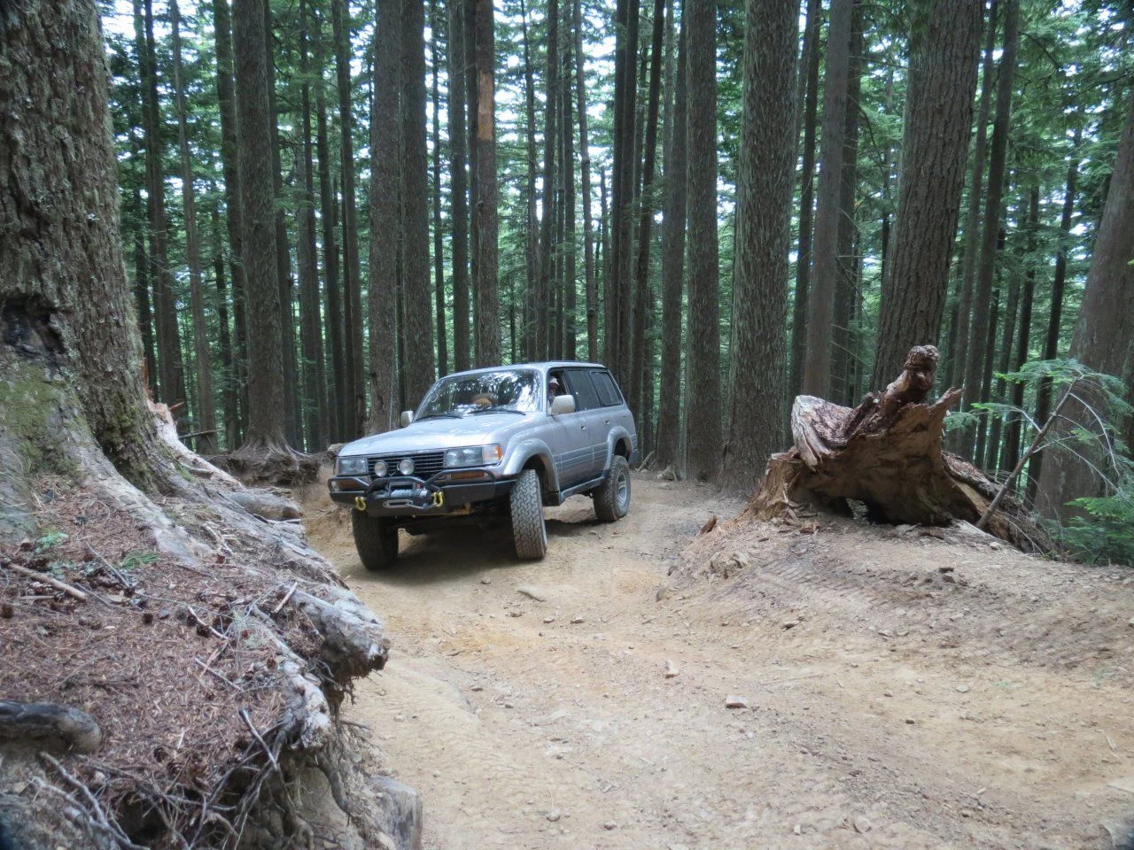

OME 2.5" heavy front and rear, with and without trailer. the weight of the trailer only lowers the rear 1/2 ", however its only about 175 to 200lbs of tongue weight. The interior is loaded down with a 1/2" marine grade plywood drawer system. lots of tools, spare parts, extraction equip, fridge freezer etc etc.
For expedition style overlanding the 2.5" is perfect, and more than capable off road. We tackled the knarliest of trails at Evans Creek with only minor body damage.

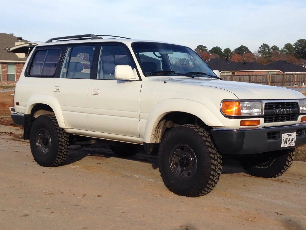

Here's a 2" with 315s, but you can always leave it stock and tuck your balls between your legs :flipoff2:

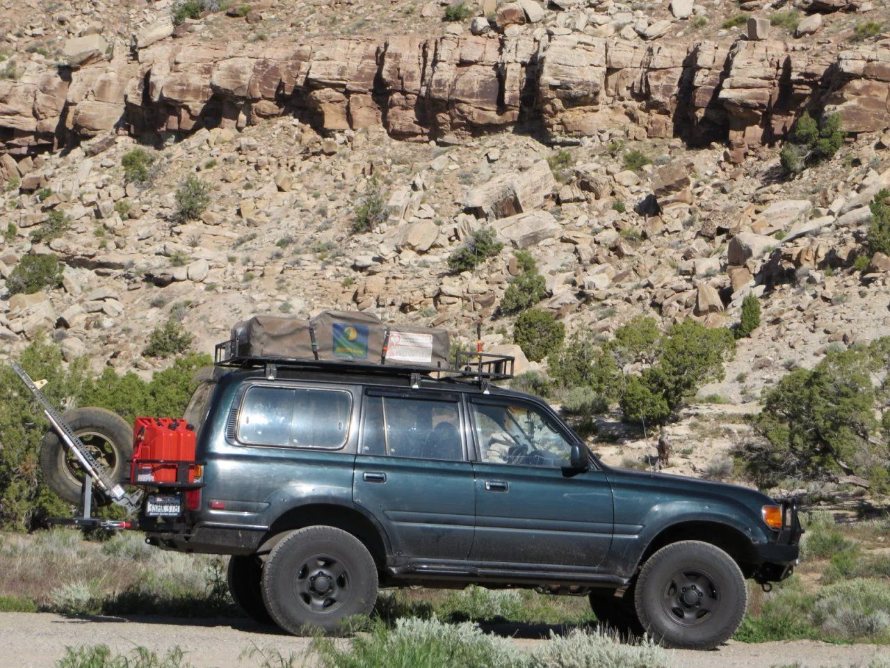

2" OME and 315s...very very happy with the ride and the performance.

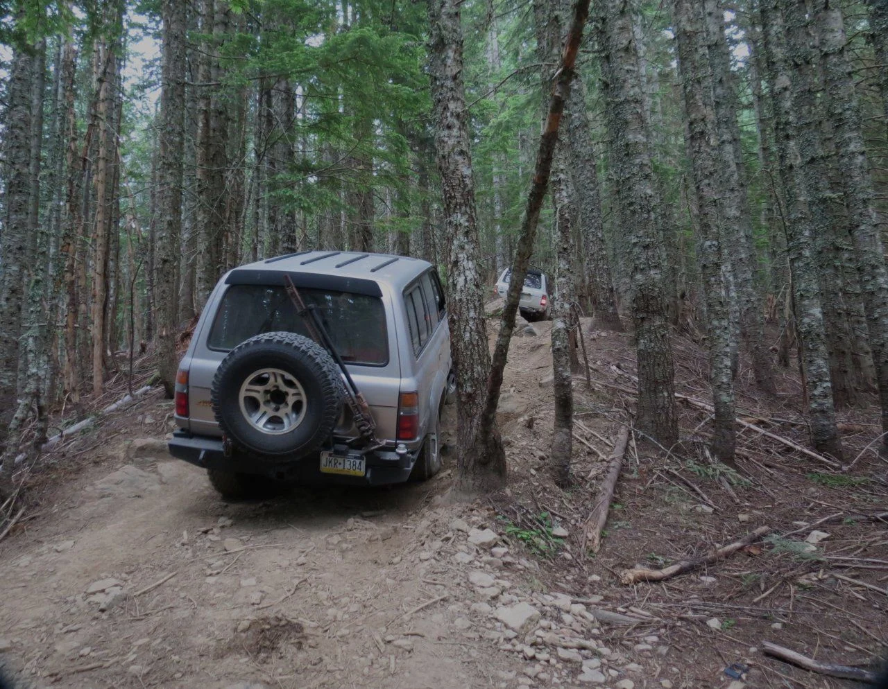

Here is mine. 2"OME heavy front and rear. Man-A-Free 30mm front spacer to level it out. ARB front bumper with 10,500 lbs MileMarker hydraulic winch. 285/75/16 Cooper ST/Maxx tires.

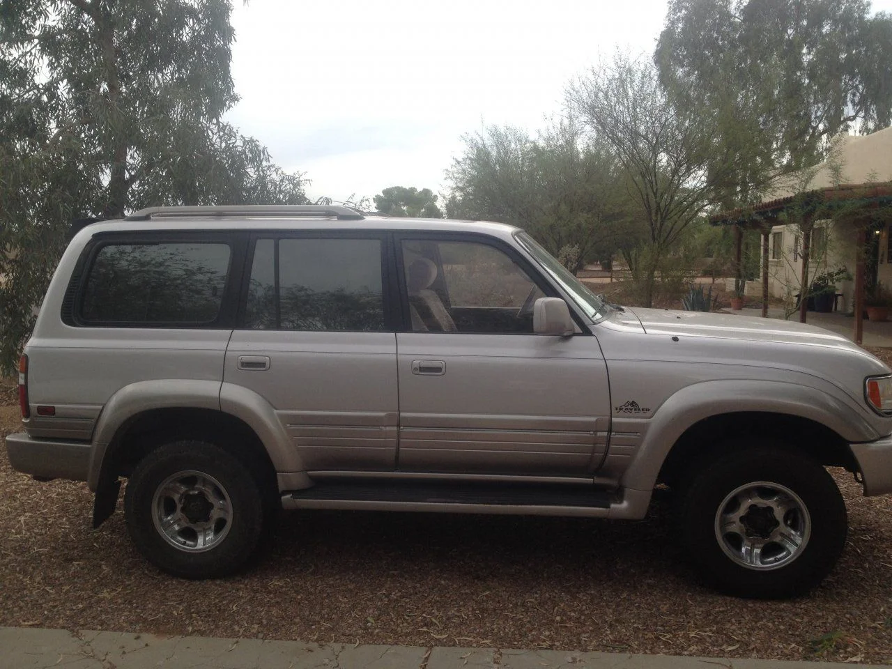

This is my '92 with Ironman 2".
It is pictured with 33-10.5x15. Probably the very similar in size to your 285's
